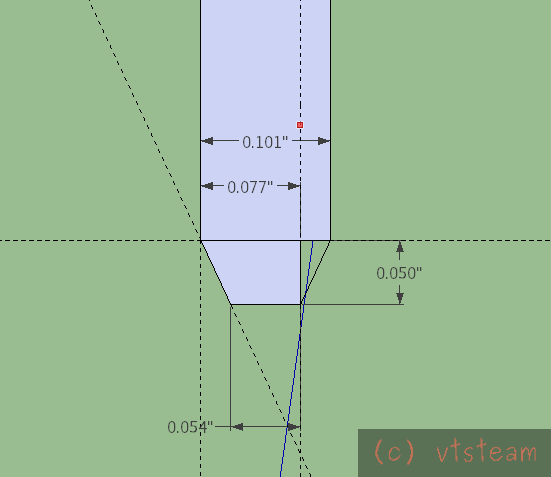

« Reply #527 on: June 25, 2018, 12:36:26 PM »
I've spent a good part of the morning thinking about XL timing belt profiles in order to make a cutter, and there's just no solid info on the likely tooth shape for a pulley the diameter I'm shooting for.
For making a cutter, there's the old grind it and check against an existing pulley method, more or less okay for a fly cutter, but I'm hoping to turn a profile. I do have info on the straightened belt tooth profile (rack), but that doesn't tell you what the pulley's curve will do to it.
First thoughts: straight belt profile shows a 25 degree offset from vertical for the bevel. Since I'm bending things 4 degrees per tooth in a 90 tooth circle, Maybe I should split the difference and call it a 2 degree reduction in the angle, so say 23 degrees for the pulley bevel(s).
Then  there's the width of the bottom of the tooth next. Straight line belt shows .054" there. Does it compress and shorten any? Probably. How much  on a 90 tooth circle? I don't know.
Finally I just decided to go with the plain rack proportions for the cutter -- 25 degrees, and .054" tooth end width, and .050" depth. And just file the slight tooth radii. It IS for a rubber belt after all, not solid gears. We'll try the KISS method and see how S that turns out to be.....  :loco:

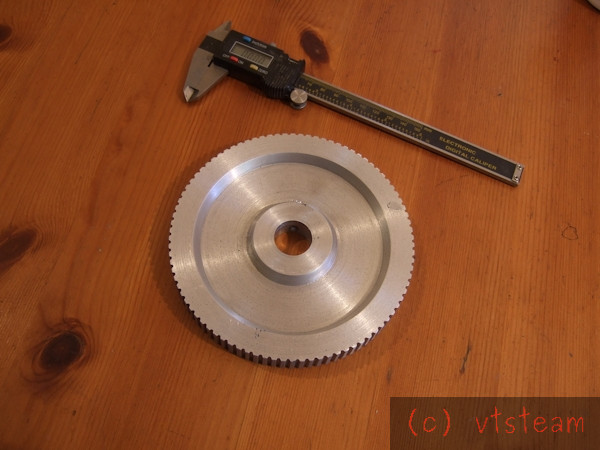

« Reply #533 on: June 25, 2018, 05:53:07 PM »
Well after all that blather about a multi-tooth cutter, I got impatient, and just ground a small lathe tool by hand with 25 degree angles, locked my calipers to .054", squinted as best I could at the tip, by comparison, and called it done. I installed it in the very same cast fly aluminum cutter I had bored out the headstock with, bolted down the old 5C spin indexer to the mill table, and hoped for the best.
  • Posts: 6823
Re: Building a New Lathe
« Reply #534 on: June 25, 2018, 05:53:51 PM »
In action:
  • Posts: 6823

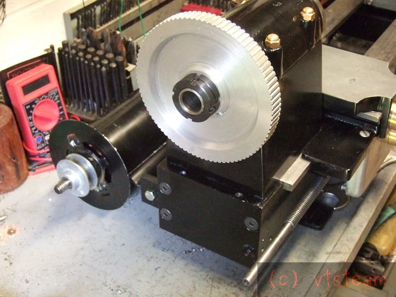

« Reply #535 on: June 25, 2018, 05:55:11 PM »
Finished pulley. Amazing....nothing went wrong!   :doh:
  • Posts: 6823

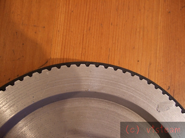

« Reply #536 on: June 25, 2018, 05:55:49 PM »
And the belt even fits.  :zap:

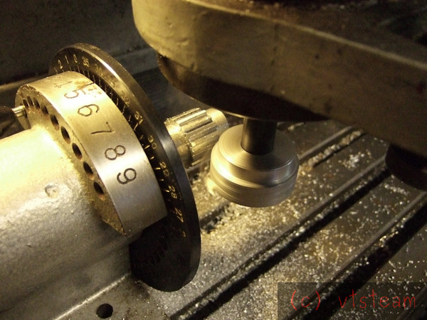

« Reply #538 on: June 25, 2018, 06:23:55 PM »
Andrew I don't need an excuse to do that.
Besides the 0,4,8,2,6,0 counts, this spin collet had a devilish gotcha waiting in store for the first mental lapse: the holes didn't line up exactly with the numbers -- particularly the 2 -- I nearly put the peg in the 1 hole a number of times, especially since it is the second hole, in a numbering system beginning with zero. But some little birdie somewhere above my noggin said "STOP..... not there....third hole" and I re-set the peg. A miracle this came out, first time.

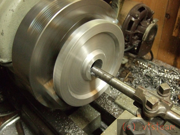

« Reply #540 on: June 26, 2018, 11:44:05 AM »
Opening out the pulley bore to suit the spindle:

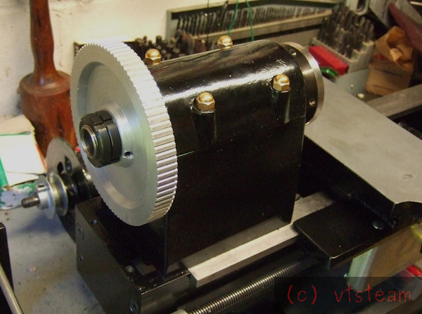

« Reply #541 on: June 26, 2018, 11:45:08 AM »
And finally, trial fitting the spindle, bearings and new pulley to the headstock:

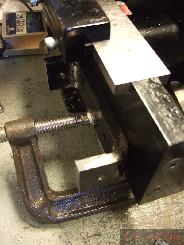

I cut the legs of the bracket much shorter than they had been for the temporary boring bar setup at the tailstock end. Then drilled new pivot holes. Here's the motor bracket clamped for marking with a transfer punch.

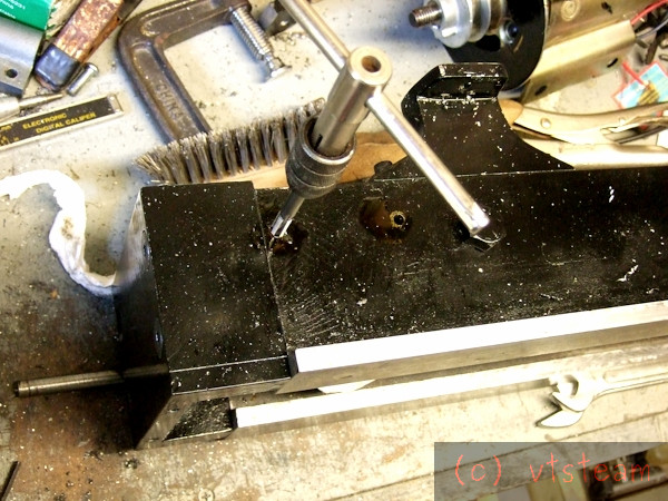

« Reply #544 on: June 26, 2018, 04:00:26 PM »
After removing the tailstock, carriage assembly and headstock, I was able to flip the bed on its side and use a hand drill to put two mounting holes in the bed. These parts are getting heavy!
Then the start of tapping. Always a little edgy putting threads full depth in 3/4" hot rolled steel. I go slow and use lots of sulphured tapping oil. Takes awhile but I do get through.

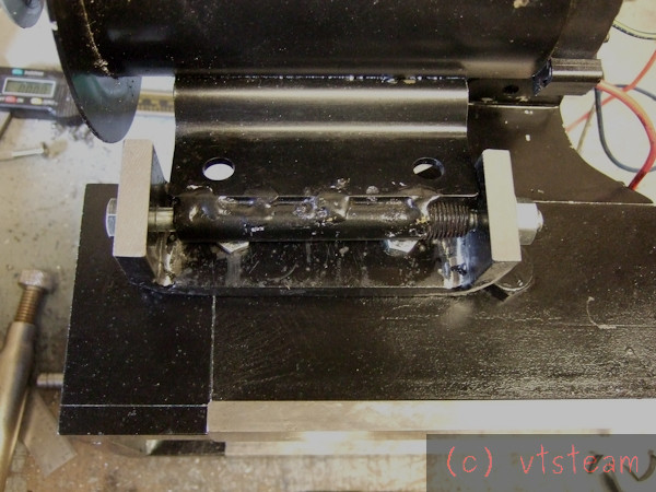

« Reply #545 on: June 26, 2018, 04:02:44 PM »
And no broken taps, The bracket is mounted -- previously the existing treadmill motor bracket was spot brazed to a bit of pipe nipple. The whole is shot through with a 5/16" bolt. I'll add packing washers later....once I know where the pulley needs to sit.

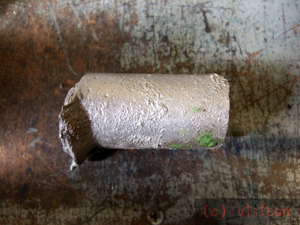

Just to get a belt ordered, I kept going after dinner on this one. Rather than casting a new blank I rumaged around and went with ...
The lowly sprue:

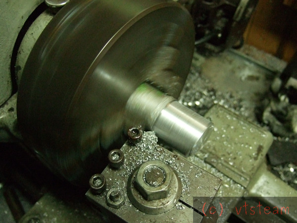

Turning down to 1.126" for a 18T XL driver:

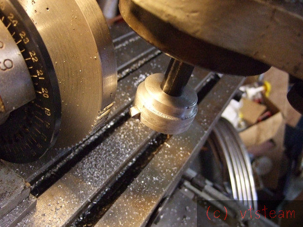

« Reply #549 on: June 26, 2018, 09:02:33 PM »
I turned the ends down to .875", bored .667", and since the old setup was still in place on the mill, all I had to adjust was the depth of cut, after tightening in the collet. The tooth cutting was much easier, only 18 teeth, and no need for the vernier -- just rotate to every even hole.
