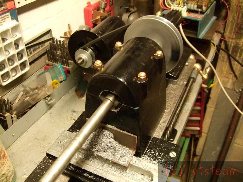

And finally, boring the headstock!  :ddb:
Uhhh....this is going to take awhile.......
  • Posts: 6941
Re: Building a New Lathe
« Reply #476 on: June 12, 2018, 02:25:17 PM »
Verrry slow going. I have to re-sharpen the HSS bit every pass. Unfortunately, I have to enlarge the diameter by 0.5", just for a clearance bore. I'm probably only cutting .010" per pass.
The recesses for the bearings are larger than the clearance bore. The are not full depth, however, so they should go more easily.
Also, I'm still at an interrupted cut stage, and there are undoubtedly sand inclusions in the cast skin in the bore. Once that's all gone, and the interrupted cut is over with, I hope the bit will stay sharp longer and things will go more quickly.

Norman, BIG difference between cast aluminum and cast Zamac, or even steel and cast iron. I too found boring the aluminum headstock and tailstock castings for my Gingery lathe a piece of cake, by comparison.  They were also a lot smaller radii than this one where I'm boring a clearance hole over 2" in diameter, not to mention the even larger recesses for roller bearings. That alone means more much more metal to take off than a tailstock, and I have a full half inch to go on the through bore -- not a close bore to start.
Both metals were sand castings, and I can't exactly explain why if the holes had been the same size this one would be so  different in cutting ease than the other, but the fact remains, they are.
One noticeable difference to aluminum I've found is that the tool grind angles have to be much sharper with Zamac because it is both slippery and very very tough, and the necessarily fine edge needed to cut it doesn't last well. Zamac machines beautifully, but not necessarily easily, and I'm working with a home concocted Z-12, not commercial quality. Filing and hacksawing also are noticeably more difficult than with sand cast aluminum, and those dull quickly as well, on the same types of jobs I would do with aluminum.
This particular casting really wants a carbide tool with sharp angles and top relief, but I don't have anything suitable that I can use with this boring bar. So it's slow going with HSS. And frequent re-sharpening. I do think that when the skin is fully removed from the bore (it was quite irregular and there are still patches of as-cast skin) that I won't have to sharpen as frequently.
No problem, really, Norman,, I'm patient, and I'll get there. I hand scraped the ways over several days, and I don't see that it's a big deal to take it slow boring either. All part of the game...

I was curious to see how much skin was left, so I decided to pull the bearing cap off and have a look. Quite a lot, since there were hollows in the core impression.
So I got out a Dremel and chucked up a carbide burr, and went at all the grainy looking areas I could find. When I put the cap back and resumed boring, I noticed a definite cutting improvement. I'm still sharpening the bit frequently,  but not as much, and the cuts are a little deeper and more consistent, end to end.
Next improvement I'm contemplating is making a new 3/4" boring bar to replace the 5/8" one I started with. There wasn't clearance for anything bigger to start, but now that the bore is much larger I can move up in size. A larger bar will mean I have to also bore the pulley to fit it, but I judge there's enough hub to do that.
3/4" would be the limit for hardware store pulleys though.

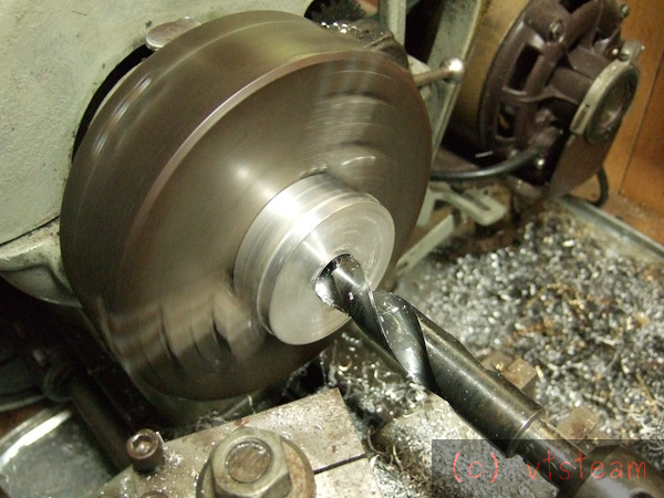

Before I did make a new bar, I decided to cut down one of my 1/4" indexable turning tools (from a cheap set that I've never found replacement inserts for) to 1-1/2" long, and put it into the boring arbor.
Man what a difference! It really chews through the sand cast Zamak. Not a pretty cut, but I can take .030 off the diameter in a single pass, no sharpening, at twice the RPM and a decent feed. I was starting to get down about all the sharpening I needed with the HSS. Well, this is a job for carbide only. Obviously the insert and angles aren't ideal for a clean cut, but at least the end is in sight for this clearance bore. Phew!

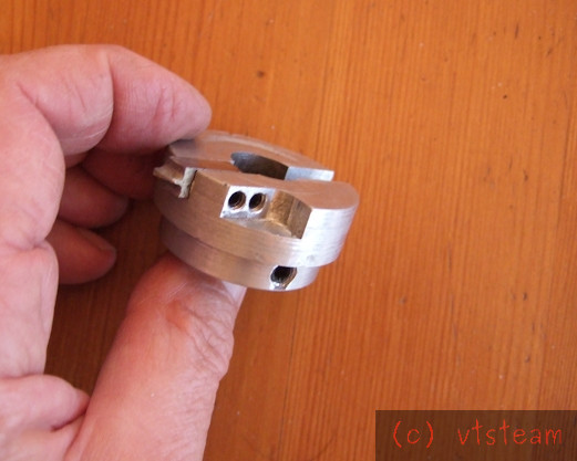

As I get closer to finished bore size, the extension of the tool bit has increased to the point where it's moving slightly despite the set screw. So today I hunted up an old piece of cast aluminum sprue, and turned and milled up a little boring head for my arbor, just a 0.1" smaller than the present bore.
This should make the next few cuts out to finished size a lot easier, and though it presently fits the 5/8" arbor, I can open it out for a 3/4" arbor later -- which will be necessary for doing the bearing recesses.
By starting with 5/8" I'm able to keep the tool bit a little longer inside the shell for better support, until the bore is larger and I can switch to a longer tool. And this time the tool is held by two set screws, so I don't think movement will be a problem... at least for awhile.

It's working very well, much deeper cuts but necessarily slow feed. Otherwise the driven pulley slips. Since I can't fit a carbide tool in the small space, it also means I'm back to HSS, and frequent sharpening. But progress.  :dremel:
This is probably unecessary at this point -- the spindle is about one and a quarter in diameter, and I'm nearing 2" on the clearance bore. But I had it in mind to make it to 2.125" and I haven't given up on that....for no apparent reason.

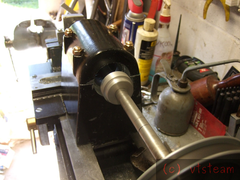

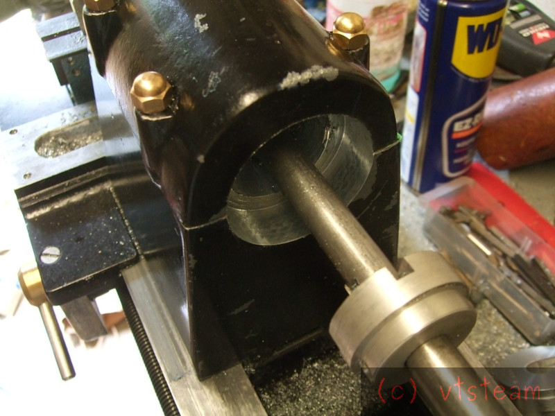

Done with the clearance hole. Now starting the bearing journals.
I believe these need to be 2.441" in old measurement. This is going a fair amount easier with only an inch to bore for depth. The arbor mount cutter is working very well. Glad the other is over with!  :Doh:

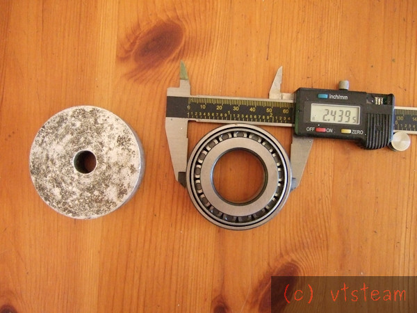

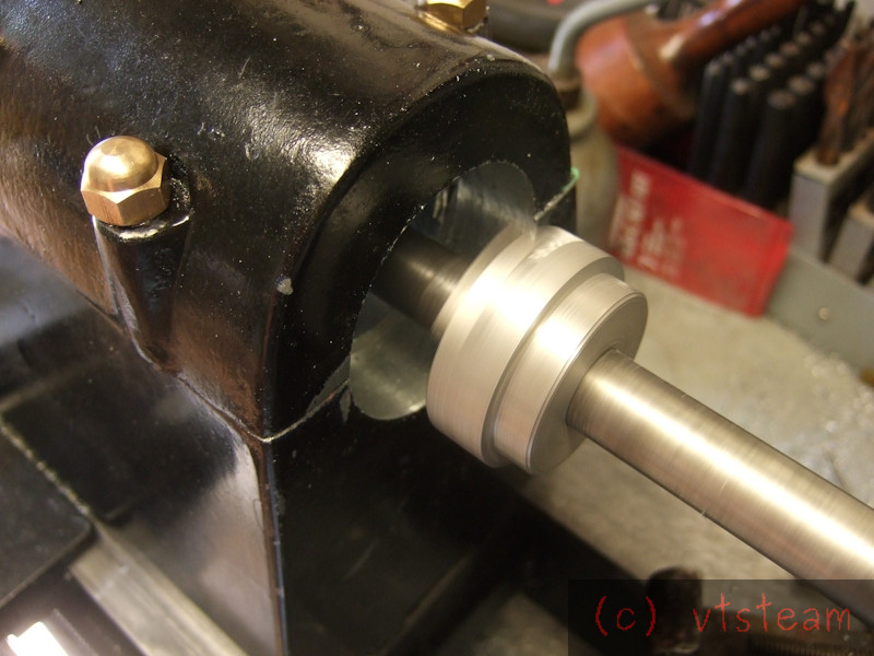

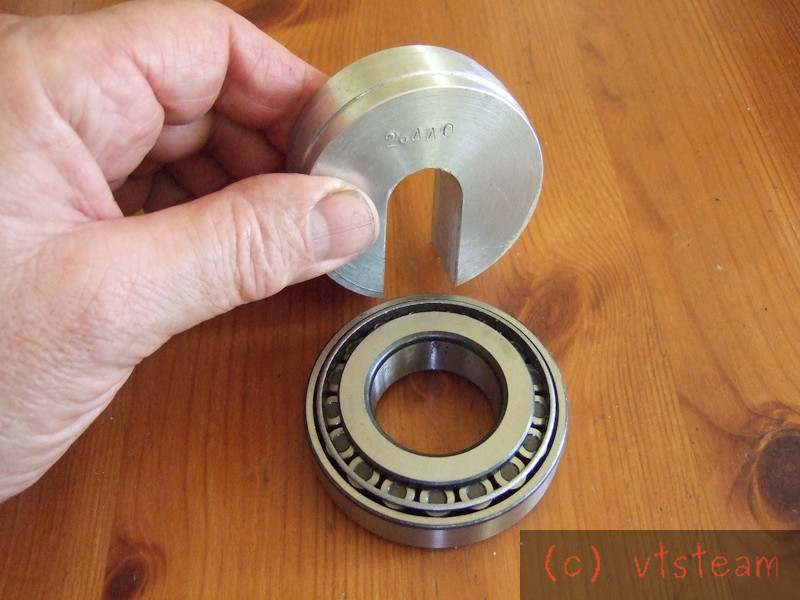

Getting closer to journal size, it was time to make a bore gauge. I found a scrap piece of aluminum 2.5" in diameter. The bearing measured (on my calipers) 2.4395". Not that they are accurate to a half thou, but I've been using it consistently, so parts should match.
  • Posts: 6941
« Reply #493 on: June 17, 2018, 01:18:17 PM »
I turned the gauge to 2.440" on one side and 2.430" on the other. Sorry I don't have any photos of turning, but if you're interested, John (Doubleboost) posted a fine video on youtube awhile back showing the process of bore gauge making (his ER32 lathe chuck video).

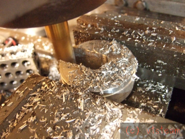

I'm adding an additional touch to suit my particular headstock boring setup here -- first drilling the gauge 3/4"
  • Posts: 6941
« Reply #494 on: June 17, 2018, 01:20:49 PM »

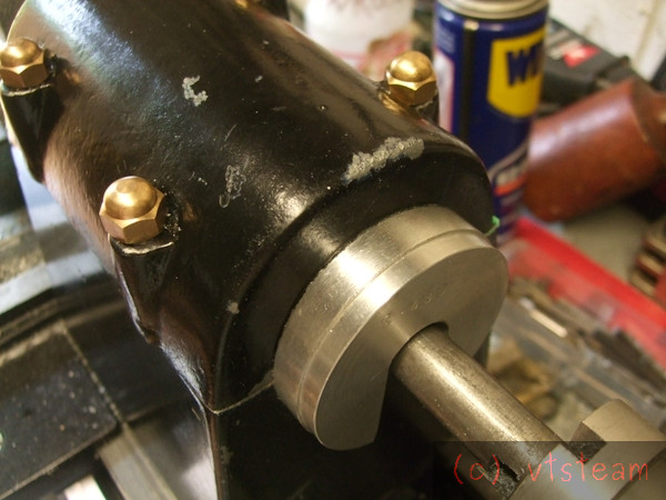

Then I sawed a slot close to the finished diameter on my bandsaw. I probably could have left it there, but decided to clean up the slot on the mill:
  • Posts: 6941
« Reply #495 on: June 17, 2018, 01:24:42 PM »
And here's he finished bore gauge. The slot allows me to drop it down over the boring arbor and test the bore without taking apart my setup. I was a little apprehensive putting a slot in the gauge, in case there were internal tensions that would change the OD's, but measuring after slotting (and letting the gauge cool) showed the diameters were still spot on.
So I stamped both sides of the gauge with their dimensions, and we're ready to continue boring the journals.

« Reply #496 on: June 18, 2018, 05:14:00 PM »
And after boring all morning, we have a bearing journal!  :ddb:
Phew....!!
  • Posts: 6941
« Reply #497 on: June 18, 2018, 05:17:17 PM »
The gauge worked perfectly in sneaking up on the final diameter. The final fit is nice and close, and I'm happy. Hope the other one comes out as well.
One of the things to remember is that this type of boring has no actual lathe adjustment or graduation at this stage in the construction. It's all a matter of moving the cutting bit out of the boring bar small amounts at a time and re-tightening the setscrews. So it feels like quite a victory to hit the diameter right on the money.

Well, one more journal to go, but the first one done means the end is in sight.
For those who haven't tried this: a little spring in the boring arbor is helpful in getting the final diameter right. It never cuts to full depth on first pass. For instance, if I set the boring tool out 4 thousandths the first cut will be maybe 2 thou (4 for diameter), the second cut one thou more (2 on diam), and the third cut maybe a half (one thou on diam) , and so on, until you reach the chatter point. So if you play this right by advancing the tool just a little past final size you can ease right down to where you want it in very small steps without resetting the tool, testing each pass as you go with the homemade gauge. When it just fits, you're done.
Rigidity is a plus in a lathe, but you can work with a less than perfect setup to get the results you want. It just takes more time, and understanding. Since this is a one-off situation (the finished lathe will be a much more rigid boring platform) boring the headstock before it is fixed in place with a 24" long  boring bar is a little tedious, but certainly tolerable, considering this kind of setup won't be needed again.
