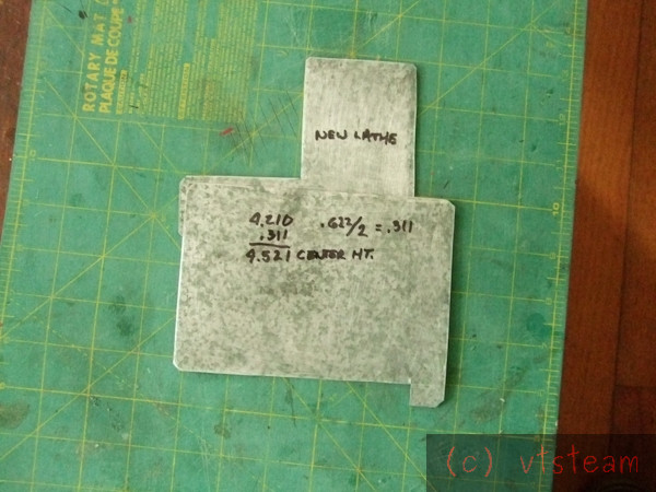

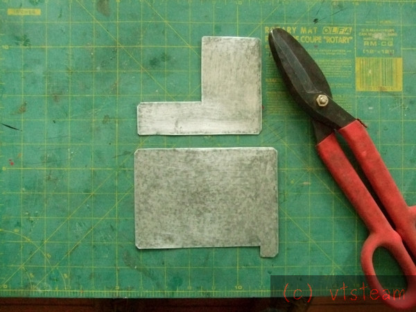

Okay, back to doing things. First we cut out a couple of pieces of scrap galvanized steel sheet:
Re: Building a New Lathe
« Reply #451 on: June 05, 2018, 09:55:37 AM »

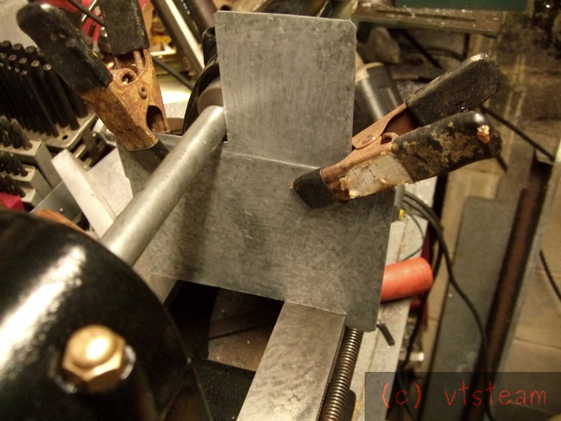

Then clamp them together over the lathe bed near the tailstock, and contacting both the side and bottom of the boring bar. The tab at the bottom should be tight to the front way edge. Apply a few drops of super-glue to the mating sheet edges.

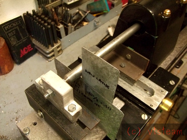

« Reply #452 on: June 05, 2018, 10:07:11 AM »
And we now have a gauge for setting the other end of the bar. This is a variation on the Gingery lathe boring gauge -- that one is a single piece gauge, and is cut to the desired center height of the lathe minus half the boring bar diameter.
In my case I had an existing tailstock of presently unknown center height that I want to match in boring the headstock, so I used a two piece gauge fabricated against the existing lathe components. No measurements involved. And it should be possible to set the other end of the boring bar to exactly the same height using this gauge, which I will keep as a permanent tool for this lathe.
Oh, also, it gives me the actual center height, by calculation. Not that I will use it to set the boring bar -- a gauge is far more accurate -- exact, in fact.
But for information purposes, the gauge measures 4.210" in height where the boring bar touches it, and the boring bar measures 0.622" in diameter there, so taking half that we get 0.311". Adding 4.210", we get 4.521" true center height. So we're on target for a 9" swing lathe - plus a whisker.  :med:

Very neat trick Steve  :thumbup:
How did you ensure that the sheets were perpendicular to the lathe ways?
« Reply #454 on: June 05, 2018, 10:24:40 AM »
Wiggle 'em.
Just like calipers.
Feel for it. Feel the force, Luke.  :zap:

« Reply #455 on: June 05, 2018, 03:52:34 PM »
Cool, you built your own version of a telescoping gage.
« Reply #456 on: June 05, 2018, 09:53:29 PM »
Hi Don, pattern fitting, which is what this really is, is a prehistoric method. I wouldn't mind a set of telescopic gauges, though.

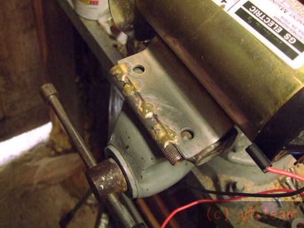

I had to work today, so very little time for the lathe, except I did braze a bit of scrap 1/4" water pipe to the treamill motor's base to serve as a hinge when mounting it. I was afraid to arc weld it, in case the arc affected the motor's permanent magnets. Wasn't sure on that, but figured better safe than sorry. And I didn't want to overheat anything, since there is a plastic end cap and brush holders, so just a few blobs of braze and then a dunk. But it should hold.

You are brave Steve!
I'd have brazed that pipe to another bit of plate then bolted it to the motor foot.
 . . . But then I'm a coward

Hardly, Andrew, from what I've seen you take on!
After work today I welded together a U-shaped bracket out of 3/8" x 1-1/2" hot rolled steel to take the motor pivot. I made it extra long because the belt I have for the initial boring job is a bit too long. Even so, after welding I realized I wouldn't be able to bolt it to the lathe bed because it interferes with existing cross bolts. Instead I'll just temporarily bolt it vertically on the bench and I will have to bolt the lathe down as well.

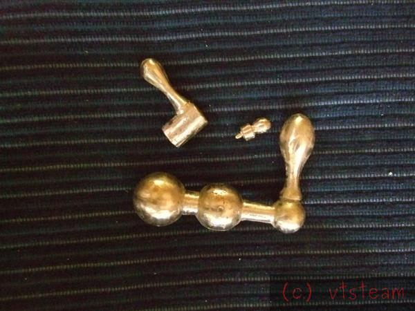

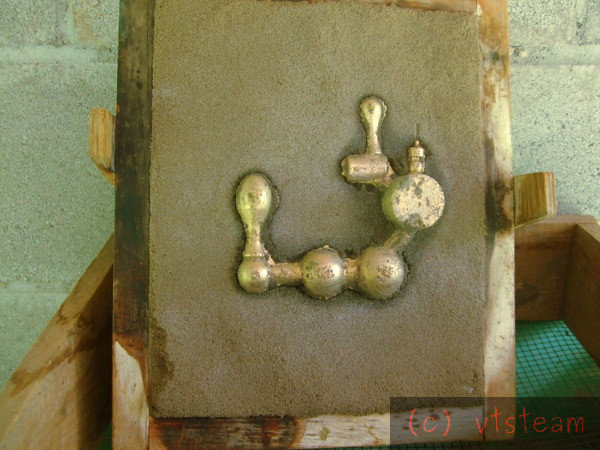

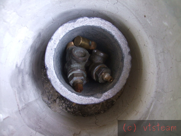

I just realized I also needed a ball handle for the leadscrew to traverse the headstock over the boring bar. So, I found some old propane valves that I'd removed from tanks used for other purposes (like building the tiny furnace). Popped them into a crucible and put it in the tiny furnace.
« Reply #466 on: June 09, 2018, 04:10:43 PM »
It surprised me how quickly the valves melted -- I barely had time to ram up a mold. This is with a purely atmospheric propane burner I built -- quite small actually. I did augment the draft with a length of stovepipe perched on top of the furnace lid.
The melt wasn't quite behaving right -- a little pasty, by the time I was ready to pour, so I guessed I'd lost some zinc in the long time it took me to make up the mold.. I decided to drop in a couple of the thin frozen zinc spills from prior pours-- less than an ounce I would guess. And yes the melt became nice and fluid soon after. I skimmed and poured.
Here's the result when I separated the flask. Besides the ball handle, I also cast a locking lever for the tailstock ram. and a very small oil dipper that it also takes. That last one didn't quite fill with brass -- you can see the impression of the post at the end is not quite filled.
« Reply #467 on: June 09, 2018, 04:15:18 PM »
Here they are liberated from the sprue, and rough cleaned. I'll probably just drill the oil dipper, and add a bit of brazing rod for its post. Surprisingly easy to cast some useful bits in brass today. Very pleased!

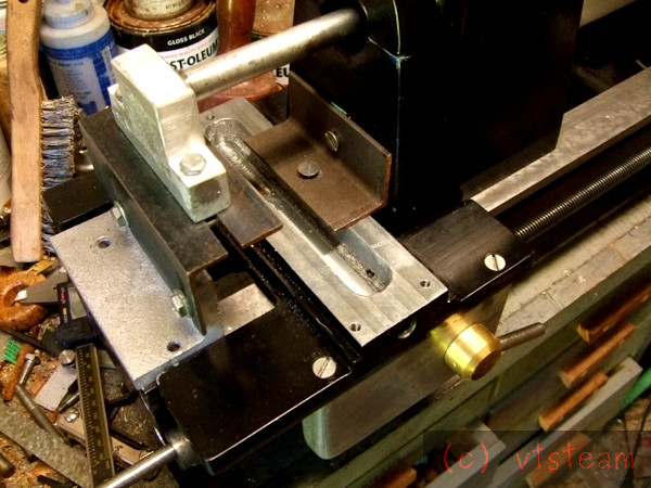

Today I drilled the ball screw to fit the leadscrew, and added a set screw. The carriage ran a little tight at first, but I had not tightened the screws adequately on an aluminum bed extension that serves as an attachment point and heat sink for a stepper motor -- should I decide to go with the electronic leadscrew I worked up a couple years ago. Anyway, the extension also carries the left side leadscrew bearing, and it turned out that the extension was rocking slightly and throwing the bearing out of line.
What was really needed was countersinking its attachment bolts, and fully tapping the corresponding blind bed holes -- which had never been fully bottom tapped. Once this was accomplished, the extension could be firmly bolted in place, and the leadscrew and new ball handle drove the carriage sweetly along the full length of the lathe.
Next to receive attention was the headstock. It also bound, about halfway along the ways. It slides on the inside edges of the two way pieces, while the carriage rides on the outside. I finally traced the binding to the fact that the headstock's retaining plate was contacting a slight high spot on the heavy steel bed bearers.
To solve that, I milled the retaining plate on the binding side about 0.030" narrower so it wouldn't contact the bed rails, just the ways. The headstock then slid sweetly along the full length of the lathe.
Finally I drilled a couple holes in short length of angle iron to attach the headstock to the carriage. Then transfer punched those locations and drilled and tapped the two moving parts. Finally the carriage and headstock are connected, and the leadscrew now drives the headstock down the ways. No binding, and the ball handle moves everything easily. I adjusted the two gib screws under the headstock, and hit them with some Loctite.
All that's left to do before boring is attach the left side boring bar support, fasten down the lathe and the motor bracket, connect the speed controller, and ......go.

The cross slide has been removed, and the headstock has been screwed to the carriage temporarily with a bit of angle iron.

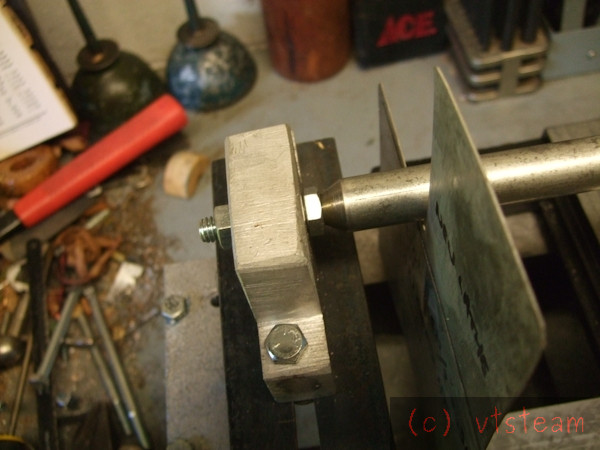

For an adjustable pivot, I faced off a bolt and center drilled it. Tapped the support block and added the bolt. The boring arbor fits there, and I can take up the slack with the bolt. The nut is for locking it.
« Reply #474 on: June 11, 2018, 09:42:39 PM »
Setting up the bar with the gauge made previously:
