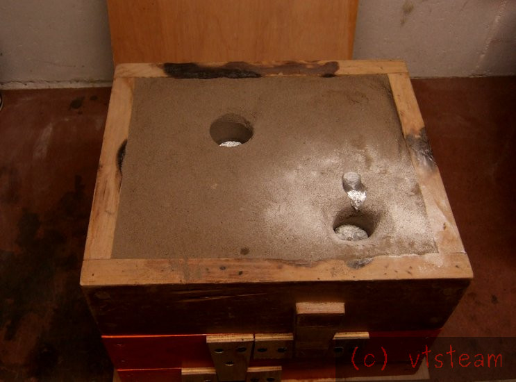

With the morning's pour having worked with propane, I thought about it for awhile and then decied late in the day to go for a pulley pour. This meant clearing enough bench space to do the moulding, estimating the amount of aluminum needed, locating the baked sand cores I'd made and re-conditioning the sand.
I weighed out 56 oz of aluminum, which seemed like it would be enough, though this particular mould would have a very long sprue (for me) in a 3 part flask, and a riser. Moulding took quite awhile, I haven't cast anything in a year and a half, and this one had a bked core and a hanging greensand core in the cope, and a sprue running through cope and cheek. I didn't want to mess up, and with darkness coming I wouldn't have a chance to remake the flaask.
Everything worked while moulding, nothing dropped out even though I did a couple of rolls, and the core fit the prints holes when put together. The wind had picked up worse than it was this morning, it was really whipping. Temp was -7C. I re-oriented the furnace to take advantage of the wind direction, and piled up bricks to shield it from low pressure. I started the furnace at 4:05, and had 56 oz of molten aluminum a half hour later.
I gave it a little extra time in the furnace to pour hot with the chilled mold, skimmed and poured. Well unfortunately, I had underestimeated by probably 4 oz, and the sprue and riser didn't top out. Ahhhh, well! There's alway still hope til you open these things.

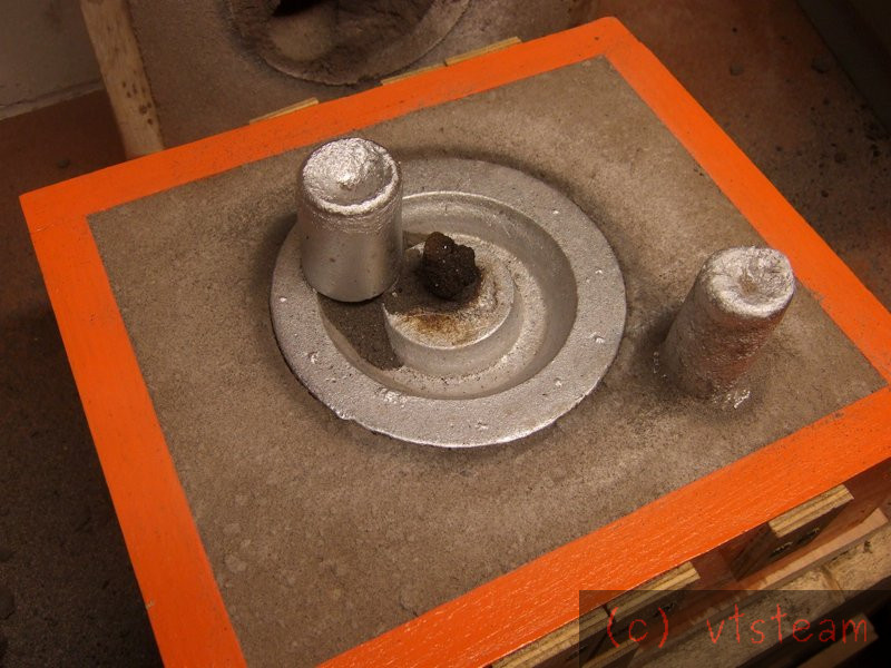

I kinda peeled off the layers one at a time, hoping all went well. The first one showed the inverted greensand core had stayed in place, and the baked core looked crumbly. No shrink cavities, the shorted riser had been just enough:
« Last Edit: April 30, 2018, 09:55:21 PM by vtsteam »

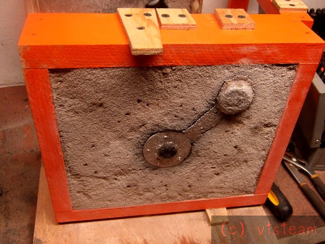

And pulling off the drag showed the bottom pulley looked good. not tears around the baked core, and it was still positioned okay:
« Last Edit: April 30, 2018, 09:55:46 PM by vtsteam »

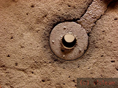

The core was soft and easily dug out. the pips are from the vent wire:
« Last Edit: April 30, 2018, 09:56:09 PM by vtsteam »

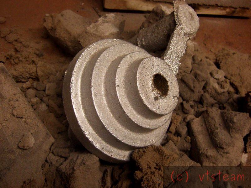

Finally, the break-out. Everything looks good!
« Last Edit: April 30, 2018, 09:56:33 PM by vtsteam »

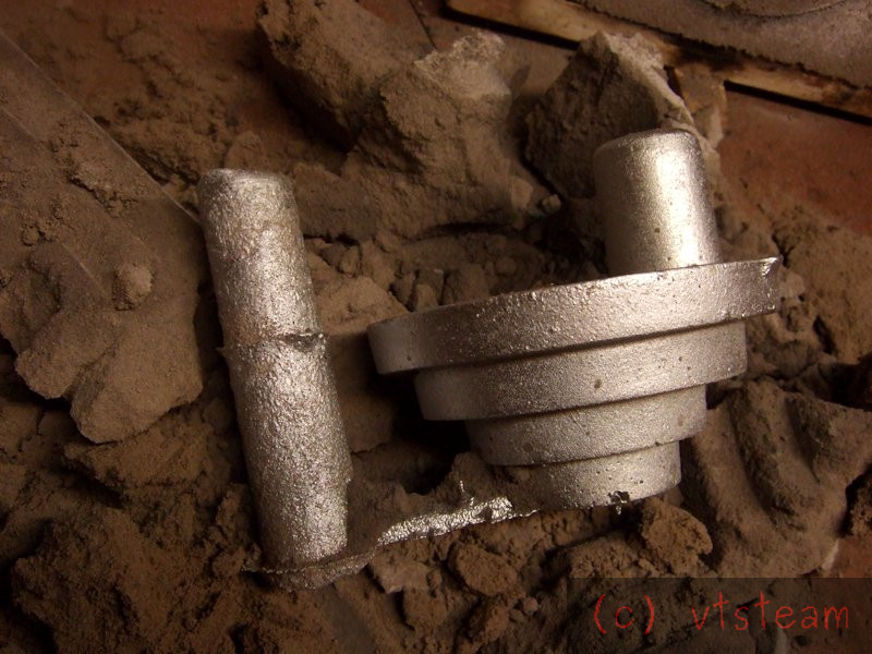

Ready to machine, I couldn't have asked for a better result, particularly under the circumstances. With all the changes in thickness, I figured this one for a bear, but everything worked first time out. Really happy with it!!
You can see the double sprue here. Final weight of pulley casting, 42 oz. One more to go.
