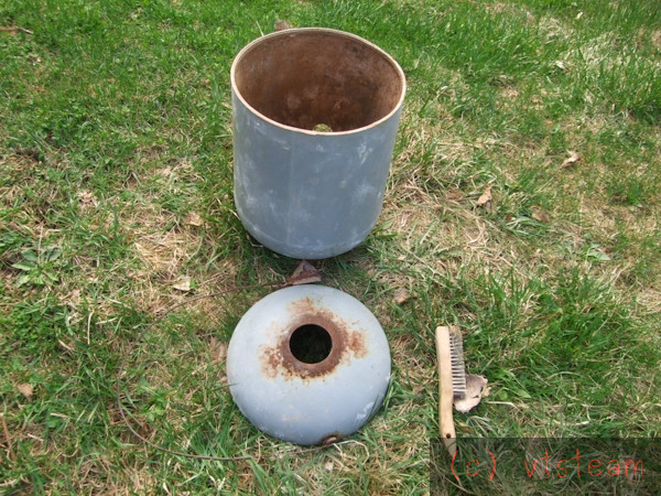

After work today, I took a wire brush to the inside of the old furnace shell:

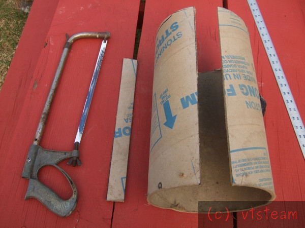

« Reply #109 on: May 01, 2018, 10:19:46 PM »
Nice to be working on grass again instead of snow, or later, mud. The bit of lawn above wasn't green three days ago. Spring happens fast here when it decides to!

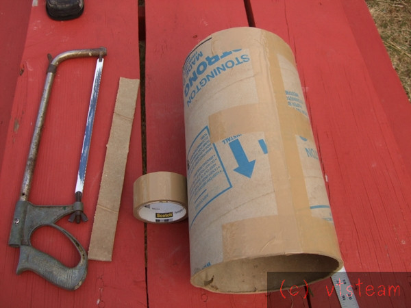

I found a piece of Sonotube (cardboard concrete form) in the big shed that was close to the ~8" OD I wanted. It was 8-5/8", so I cut a strip out 1-1/2" wide.
  • Posts: 6829
Re: Foundry Furnace for the Tiny Shop
« Reply #110 on: May 01, 2018, 10:22:27 PM »
And then taped it back together.

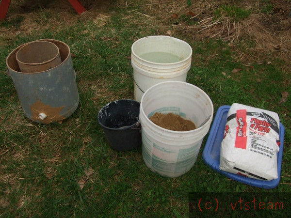

These are the ingredients for the lining renewal: some water, sand, and plaster of Paris, plus the Sonotube and shell.

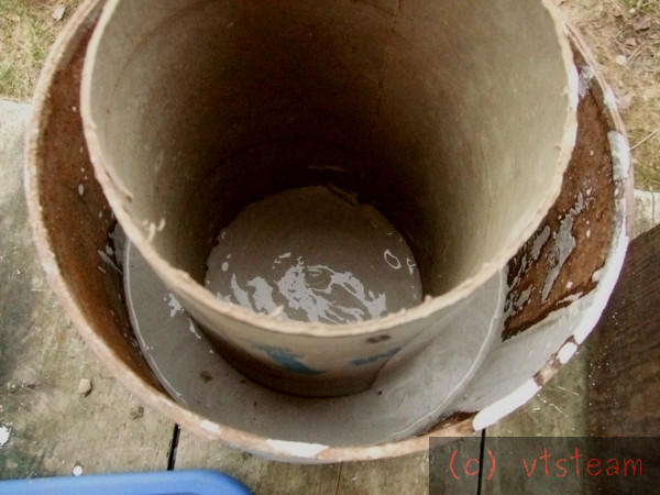

I taped a bit of PVC pipe in the Tuyere opening to serve as a plug. I stuffed both ends of the pipe with paper towels to prevent the liquid lining pouring out before it set.

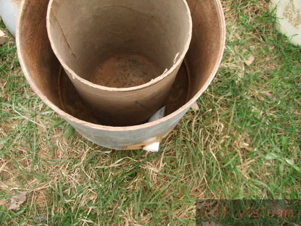

You can see the Tuyere plug here, set at an angle to give a tangential flow for the blower (charcoal) or burner (propane).
I taped around the outside of the plug also, to prevent leaks.

The shell is 12" in diameter, and with an 8" form, I should end up with 2" of lining.
Plaster of Paris is quite a good insulator. It's used as sprue and riser liners in big time iron casting for this reason. My guess is that the insulative quality is partly a result it being quite porous when cured. To be honest I was surprised to first learn that plaster was used in iron work at all. Bronze statuary, yes. Anyway reading that was one of the reasons I thought it might work out long term for this non-iron melter.
This originally experimental furnace really did live up to the hope -- and if I hadn't let it sit wet over this last winter, the first lining would still be giving good use. I've easily melted brass in it, as well as the lower temp aluminum and zinc castings for my "new" lathe.
Anyway, here's the first pour of plaster and sand mix. This forms the bottom, and I waited for it to set up before putting the Sonotube form in.

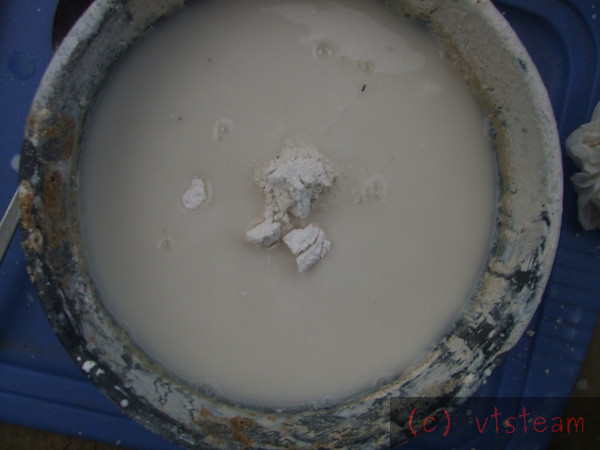

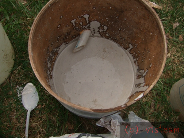

I mixed plaster of Paris by filling half a gallon bucket with cold (not warm) water. Then I poured plaster in to the center slowly until it took no more and formed a lasting "island" in the middle of the water, without collapsing. Like in the photo below. That's the normal mix rate.
Then I mix by hand. Literally. You put your hand in and stir and squeeze out all the lumps. Trust me, a spoon or any other utensil will not work as well, and you will get lumps.
Then sand is added. I just added hand fulls to roughly what felt right. I'd guess about the same amount as I'd added plaster. Again, the hand stirring and lump dispersal method is best.
Then just pour.
Plaster of Paris will take anywhere from 3 to 20 minutes to begin setting up, depending on temperature, quantity mixed, and what it's mixed with. Sand, temperature, and volume of mix all accelerate it. So cool temps, mixing no more than 2 quarts (liters) of water, and stirring and pouring quickly all help.
I've had it go off in summer in 3 minutes, which isn't even enough time to clean out your container. It cures by exothermic reaction -- in other words it generates heat in curing -- a bigger volume generates more heat more quickly.

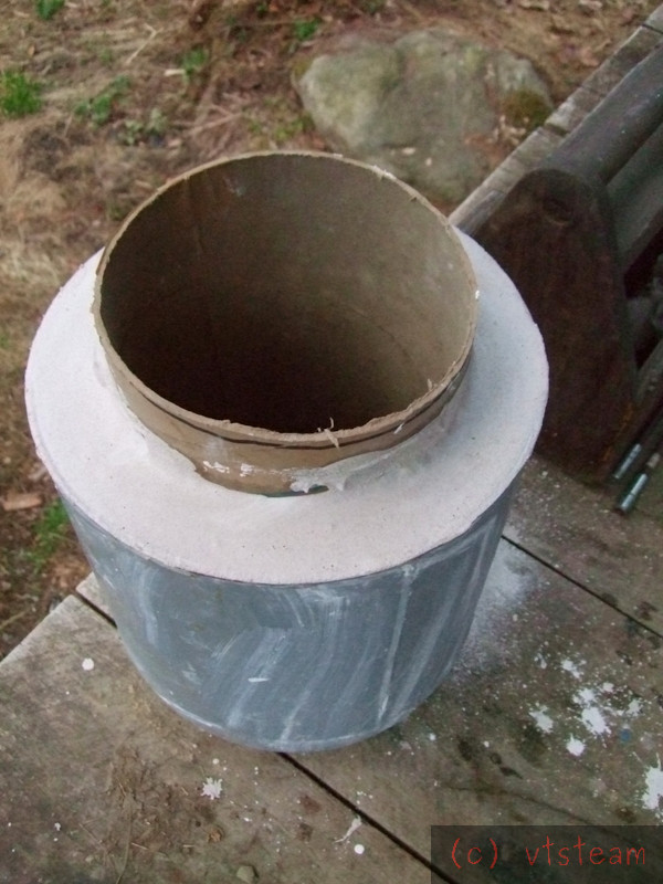

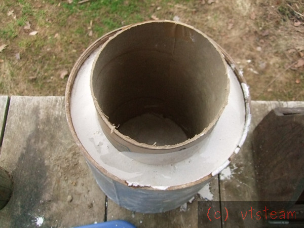

Second pour, with the form in place:
  • Posts: 6829
« Reply #116 on: May 01, 2018, 10:57:54 PM »
Again I waited until the plaster started to feel firm. And then made the third pour.  I'd done that before placing the Sonotube, too. Otherwise it would have embedded into the bottom, and been hard to remove.
  • Posts: 6829
« Reply #117 on: May 01, 2018, 11:02:15 PM »
Lasxt pour. This time I added extra sand to make it a bit firmer so it wouldn't overflow the lip of the shell. I wanted to build the height up a small amount towards the cardboard form. That can be abraded back down to fit the lid -- but if the top is left with hollows, then it will leak rather than forcing the exhaust through the flue hole. A slightly thickened mixture allows that little bit of slope from the tube down to the shell edge, without runoff.

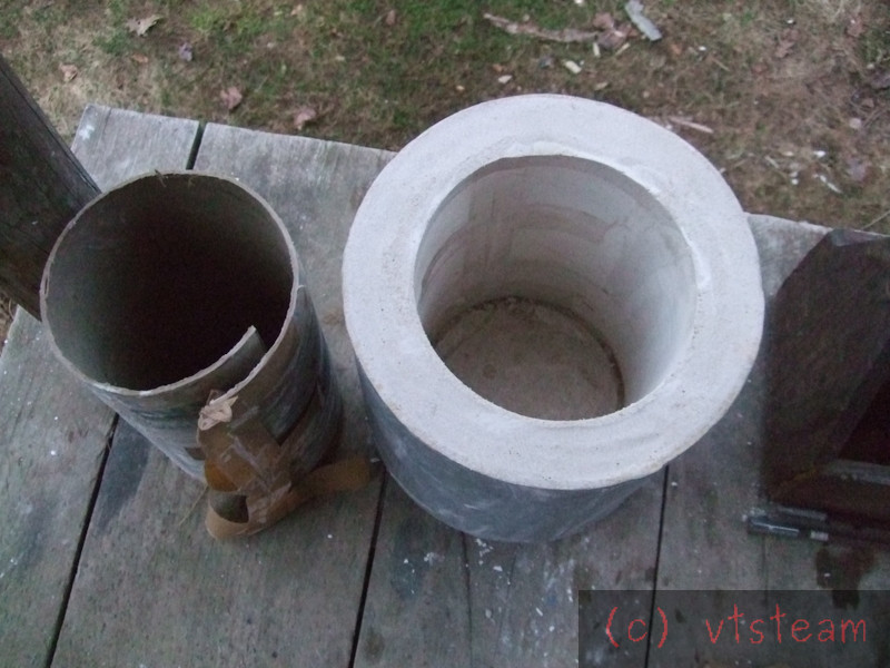

« Reply #118 on: May 01, 2018, 11:06:38 PM »
Letting it cure for about an hour, I stripped out the cardboard form by collapsing the seam edge inwards.
It probably only took 2 hours total to renew the lining, and the cost was $16 worth of plaster of Paris -- the sand water and Sonotube, were already on hand.
I didn't have time to do the lid -- have to leave something for tomorrow.....  :dremel:

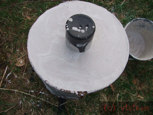

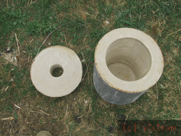

I poured the lid today the same way. I used a 3" shampoo bottle to make the vent hole form. It fit the metal lid perfectly.
  • Posts: 6829
« Reply #123 on: May 03, 2018, 09:37:09 PM »

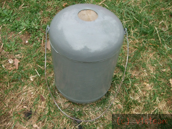

Form removed, lid is done.
  • Posts: 6829
« Reply #124 on: May 03, 2018, 09:38:20 PM »
And the shell given a new coat of paint:
