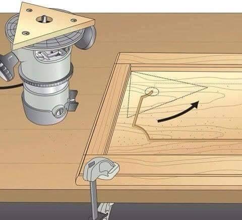

This showed up on my farcebook page thought it was a good idea never seen this before.
Wasnt sure if I should put it in wood n stuff though.

Nice idea. I might try that when I make the doors for the new benches in my garage / workshop.

That arrow looks the wrong way round to me , you would realy have to hang on to the router to stop it running away .

I can see where the arrow direction is coming from ( pun intended  :D ) as it's going from conventional milling to climb milling for ea. 120* rotation so chip is correct in that the router is liable to try & run away from direction of cut, I'm not a carpenter just my tu'pennorth.. :scratch:

Anyway, cool idea with the proper direction!  :beer:

My father was a cabinet maker and when he did this same design, he would just put a square block in each of the corners of the jig frame.  the size of the square blocks would determine the radius of the corner.  That way you did not have to put a different base on the Router.
