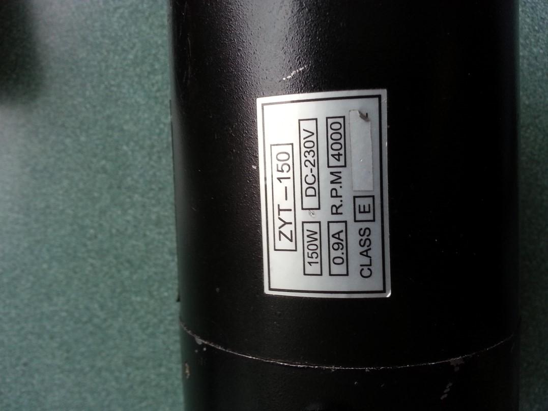

Paul,
Just to satisfy my curiosity, could you post a picture of the label on the motor please?
Peter

« Reply #29 on: December 31, 2014, 07:13:39 AM »
motor has been collected, I will collect controller later, I have insisted he checks output, to satisfy me its either ac or dc, and the pot is doing something!
lordedmond
Re: micro mill electricals problems, help please!!
« Reply #30 on: December 31, 2014, 07:27:39 AM »

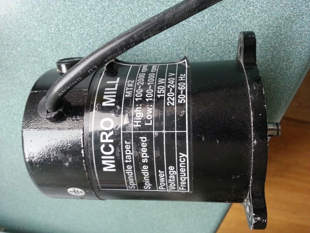

Ok
First pic is the tag for the mill as a unit
The last pic clearly states its a DC motor so your expert burnt it out  QED
Stuart

Yep the big sticker is ratings for the entire mill as a unit. Main power input to mill is 220-240v AC. Motor doesn't have a mt2 spindle taper. Pretty obvious smaller sticker is the actual motor spec and it's clearly DC. If you look above the cable on the first picture you can see the end of the brush cap ( round black thing with a screw driver slot). AC motors don't have brushes. He's fried your motor and should pay for replacement IMO.
« Reply #32 on: December 31, 2014, 07:40:23 AM »
Yep the big sticker is ratings for the entire mill as a unit. If you look above the cable on the first picture you can see the end of the brush cap ( round black thing with a screw driver slot). AC motors don't have brushes. He's fried your motor and should pay for replacement IMO.
Ahhh. But universal motors have brushes too....have a look at your Bosch electric drill/planer/ sander.....
A typical DC motor is either perm magnet or separate field coils energised with a DC supply....not connected in any way to the brushes....(a universal motor has the field coils in series with the brushes typically...)

just found the motor at arc euro, its a dc motor, so I have to agree, he has fried it, by reading, like me, the main sticker, now its been pointed out, its clearly for the mill, not motor, so original fault lies with board, or pot, and I bet its the flippin £5 pot!

Forgot about universal motors as it's not something I tend to come across tbh. But his motor is clearly labelled as DC, so still think his expert is at fault.

That first picture refers to the machine the motor is fitted to !  The third one is the motor specifications.
Your expert is both blind and stupid.
