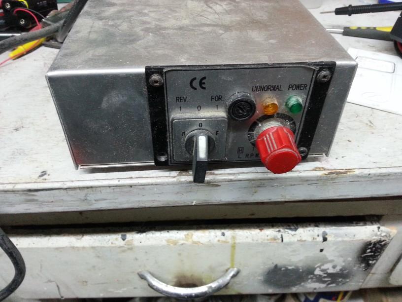

Hi all, I will set the scene! I'm pretty new at model engineering, and need some desperate help. I don't even know if I am posting the correct place, mods please move if applicable.
I was today using my micro mill, low rpm, milling some plastic sheet, so no problems here. I bought this off a friend, a very talented engineer, and a regular on this forum, he passed away last year, so my predicament is that I cannot go back to him to talk about the mill he knew inside out. It had been modified to suit his disabilities, it is belt drive, and the control panel was moved away from the machine so he could reach it. I believe its a seig machine, they are the instructions he gave me with it, although it has no markings on it. All I can say is he only used good stuff!
So after a bit of use, the fuse in the control panel blew, I changed it, it blew again. I have inspected the motor, taken it apart, all is good, no binding, brushes good, no signs of excessive heat,. all windings seem to be ok. The connecting block between the control panel and machine is good. Reassembled, fuse blew again.
So, with control panel disconnected from the motor, I can turn on, and turn up potentiometer, nothing is amiss. When connected to the motor, the motor immediately spins up with the potentiometer in the off position, and the fuse blows. I assume with potentiometer in off position, motor should not spin up?
I have inspected inside the control unit, all appears to be fine, and no smell of electrical death! I am now at a complete loss as I have absolutely no knowledge of how the control panel works, what to test, how to test, and what to do now please help! I am thinking the control panel is faulty, as its been modified the manufacturer will be no help, can anybody suggest a repairer or is the mill now finished!,

I am assuming you are in the UK
Get a 100watt lamp old fashioned type a lamp holder and wire these up instead of the motor ,leave the motor disconnected , now if the fuse blows  it's the controller if not it's likely the motor
Note you can get the bits from arcurtrade or amadeal but if the motor is duff and you put a new controller in it most like will go kaput
It may be simpler if you are not sure to replace both at the same time
Strongly suggests that the controller has failed. If the motor is spinning up, chances are that the motor is OK.
Can anybody tell me if it is an AC or DC motor and what the voltage range is? Is it on a plate on the motor casing?

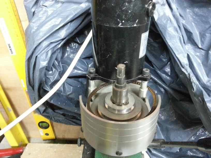

Following some suggestions (I posted on hmem then realised this was the UK site) I connected a 240v test light to the controller. Turned it on, holding my breath! the test light lit (60w bulb, very bright) I turned on the potentiometer, and the bulb light remained constant throughout the range. I was pleased thinking this means the most expensive item is ok, but is it? Should the bulb have lit with potentiometer turned off (meaning nil rpm for motor) or am I being stupid.
I then connected the motor to a 12v dc feed (don't know if its a dc or ac motor). The motor did not work, however I could feel "resistance" when turning the shaft by hand, which went if the motor was disconnected from the 12v feed. No hot wires suggesting a short. I stripped the motor again and inspected under an LED magnifying glass, I cant see anything wrong with windings etc.
Don't know if I have achieved anything doing these tests, any thoughts?? Thanks for the ebay link, I can breathe more easily now there is a potential fix at budget money : :mmr:

well I'm in  a mess now, don't know what to do. The motor has been tested and reported to be burnt out. I took the motor apart before giving in to be tested, and could not see any evidence of this. The guy has connected up to 110v ac to test it, on the basis that the motor has a big spec sticker on it, and it does actually say 240v ac, however, on the arc euro site, the replacement motor says its a dc??????
He says the motor ran for a very short period, then gave up, and a possible short was causing the fuses to blow and the motor to spin up without potentiometer input. I'm confused? I thought it was a DC motor, so why on the big sticker on the can it does clearly say its AC?
So no further on really, except now I need a motor, and might still need a control board, anybody got any recommendations for a direct fit motor other than a massively expensive £88 from arc euro, and that might not even be the fix!

Firstly, sounds like the controller board is u/s, with the pot in the off position there should be no power to the motor light bulb whatever....the fact that the lamp lit as soon as power was applied suggests the mosfet on the board has died....A fairly easy fix IMHO....
Secondly, the motor is definitely DC if it has brushes and magnets.....no field coils...would confirm this.
If connecting the motor to an ac source then damage to the motor will occur, the alternating field setup in the armature would cause it not to rotate......

The guy you took that motor to test did not know his stuff and he should foot the bill because he has burt out the motor not you
Let me explain ,
I am a time served Sparks and have done some time in armature and stator winding when I gave up work I was an electrical engineer to PhD level
Ok back to your motor a universal motor has a series field coil not a perm magnet one, when the AC volts reverses as it does 50 time a sec the field does along with the armature and every thing is in step so it's ok as it is on DC .
Now with a perm mag field it cannot reverse but the armature field will hence it no go and it will release the magic smoke alas it will not be able to be refilled.
I would bite the built and get a new motor and controller from one of the dealers then you will know it will work. But please do not let that guy anywhere near it
