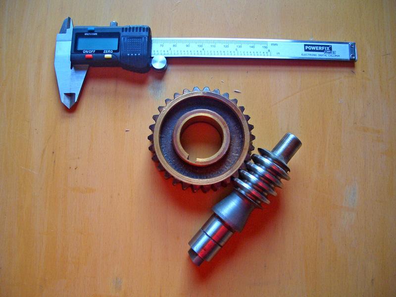

 I have started on my Rotary Table. Here is the worm and wheel that I shall be using. It is a single start worm and the wheel has 30 teeth. This will give me 12 degrees for each turn of the worm.

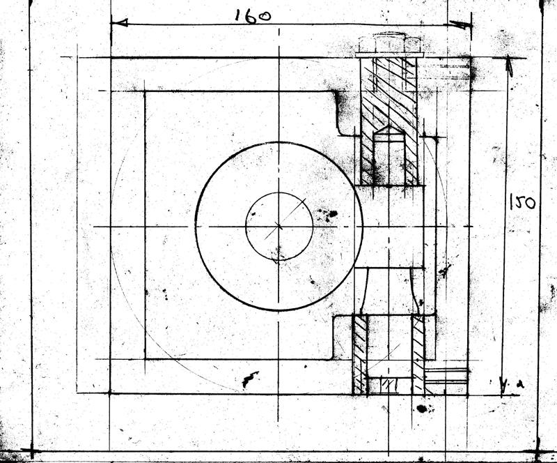

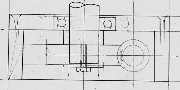

Here are the drawings showing the main details of what I plan to do. The main body is 160 x x150 x 50mm.

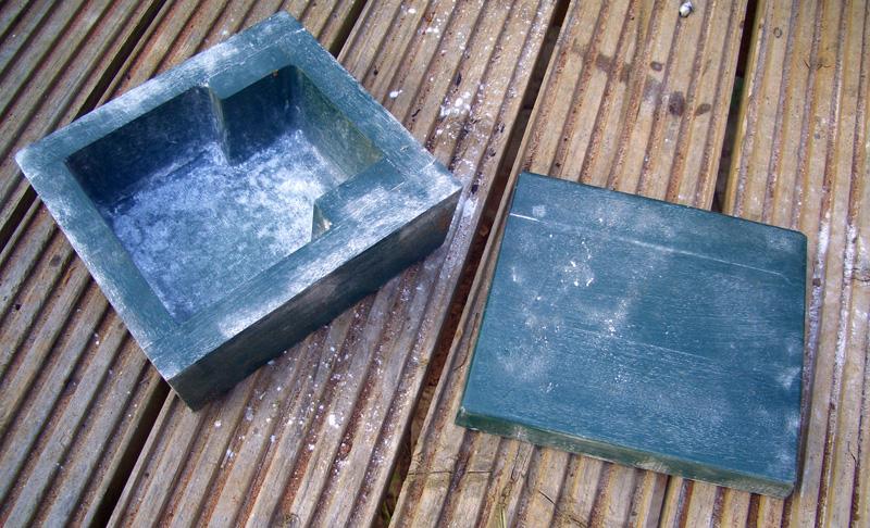

I will be making the main body of the table as aluminium castings. These are the patterns. Although the main body of the table will end up open topped I made the pattern with a thin plywood top to make the moulding easier.

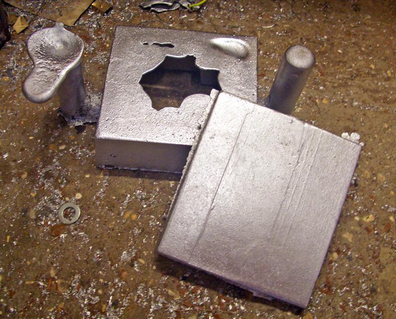

I've had two days of problems trying to produce the two simple castings. On my first attempt the flask opened and the molten metal leaked out all over the ground. The main casting was ruined but the flat top plate was OK.
This is the second time that this has happened with this flask, I am guessing that it is too light, it will become firewood.
I started to remelt the faulty casting casting and ran out of gas! I haven't got any transport at the moment so am unable to go to get any more so I decided to use charcoal.
I started today with the charcoal and could just not get enough heat, if I had the air blast too high I was showering the surrounding area with cinders and on a low setting the charcoal was burning too slowly. It was rubbishy charcoal, tiny pieces and lots of dust. After 3 hours the metal melted and I was able to pour the casting. It did not turn out perfectly but it is usable. The metal cooled and did not fill the top where I had used the thin ply. I had expected this and planned to cut it away anyway. There are also two quite large shrink cavities in the top but they are of no consequence as I have left quite a large machining allowance.

You're forging ahead Norman! :thumbup: :thumbup: :clap:
I like your pattens with very heavy sections. Nice and solid.
3 hours to melt!!! That's painful. Must be very different to the charcoal briquettes we get here. Generally takes about 20-30 minutes from a cold furnace to melt 5 pounds of aluminum.
If I use the charcoal I make from wood (real charcoal) it does shower if the blast is too high, as you say, and it burns up faster, being less much dense. But the furnace temp can go much hotter than the commercial BBQ briquettes will take it. It will actually melt a steel rebar, and certainly melt bronze or brass. The downside is you have to add it a few times during an aluminum melt. Briquettes will usually complete an aluminum melt without any additional fuel top-up  for me. They are really different fuels.
Anyway, I'm glad you finally got your parts cast -- that was a Herculean effort in a 3 hour melt -- and a second one, as well. Great work!  :clap: :clap: :beer:

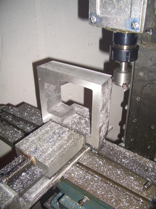

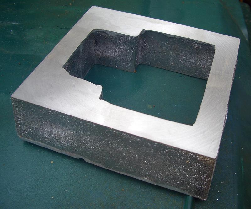

I've started machining the main casting, I did the top and bottom surfaces with the casting held in the 4 jaw chuck in the lathe, I was delighted with the finish that I achieved. There were no bubbles or inclusions in the metal.
I've also done two of the sides on my milling machine, I was a little nervous of holding such a tall casting in the vice but I needn't have worried, it held very securely. Tomorrow I will do the other two sides.

Am I missing something here, I would imagine that you need a tail for this, or a second bearing, or is the table surface also a bearing surface to the rotab table? I'm not trying to be a pain, just curious.

Pekka, you may well be right, I do not mind the criticism. I had planned for the table to sit on the top plate and to be clamped to it. This would be fine for indexing but not for cutting curved parts. I could add a bridge piece with a bearing below the worm wheel, this would brace it. Any comments or ideas are welcome, I am no expert.

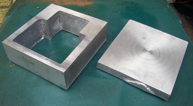

Today I machined the remaining sides of the body casting and faced off the top plate. I am really pleased with these two castings as they have no bubbles or inclusions where it matters. I am confused at the talk of the need to degass the molten metal, I do nothing other than skim the top of the melt before I do the pour. Forty years ago I did some aluminium casting at evening school and that metal was degassed but still had bubbles in it.
The milling machine does throw the swarf around all over the place, I had to spend a lot of time vacuuming it all up as I found it quite irritating crunching underfoot.

By the way, does anybody have any suggestions as to the cause of the rings on the top plate? The feed was done by hand but the rings are equally spaced.

Norman, I'm with you on not de-gassing (or fluxing) aluminum melts. I never have, but the aluminum stock I used was clean and always from castings rather than mixed extrusion scrap. I poured relatively cool, unless very thin castings were required, there was minimal dross, and the charcoal protected the top of the melt. It poured nicely, and it looks like yours does, too.
I don't think the circles are perfectly evenly spaced so I'll take a guess at what they are -- pickup of a small aluminum welded chip on the lathe tool tip, and it gradually wearing off, then picking up a new one.

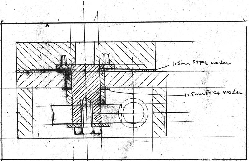

Norman, consider a thin sheet of Teflon as a bearing if space is tight. The large surface area gives loads of load capacity, and as it will always be a slowish rotation there is no issue with speed and heat.

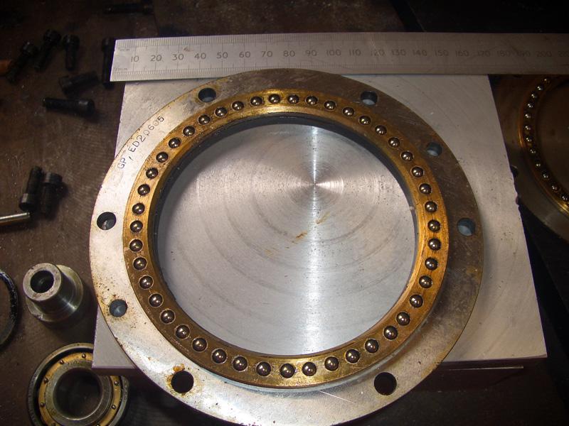

Teflon would certainly be less bulky than a bearing. I managed to dismantle the piece of equipment that I have with the ring bearing. Here is a photo, the balls run on hardened steel. Would this be Ok to take the cutting forces? The balls are approximately 4mm dia. Rather than try to clamp the table down onto the top of the body I could use a split cotter on the spindle. Any comments?

Does the Admiralty know that you have that gun mounting  :lol:
  • Posts: 6835
Re: Making a Rotary Table
« Reply #19 on: September 07, 2014, 09:51:36 AM »
I think it was just a really serious Lazy Susan  :lol:

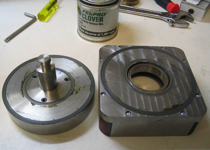

Bearing (!) in mind Andrew's and Bill's comments here is my revised design. I like the idea of using Teflon as a bearing surface and have exchanged the bearing with a bush, ideally this would be bronze but as I don't have any I will use steel. This should not cause problems when making a cut and hopefully I will be able to rotate the table to produce curved surfaces.

You could use mild steel as a thrust washer against Al, Al steel are a good bearing combination. Example, steel camshaft running in Al cylinder heads. For the speed that your dividing head is going to turn, oil lubricated Al steel would be  good.
