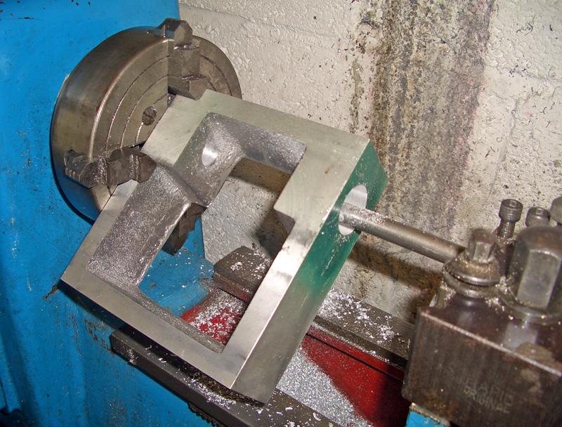

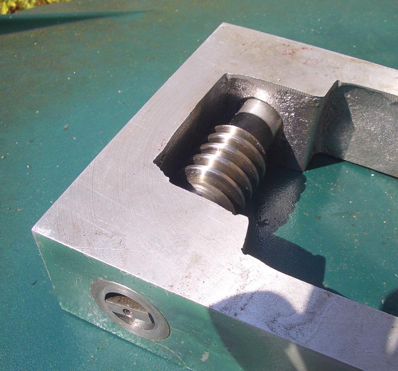

I have bored the holes for press fitting the bushes for the worm. I had originally planned to bore it by mounting on the tee slotted table on my lathe and boring it with a boring bar between centres. Unfortunately I had nothing to use as packing to raise it to centre height, so instead I mounted it in the four jaw chuck. I was concerned that it would be a bit precarious but I had no problems. When boring the hole nearest to the chuck the boring bar flexed rather alarmingly but by taking light cuts and several at the same setting it turned out well.

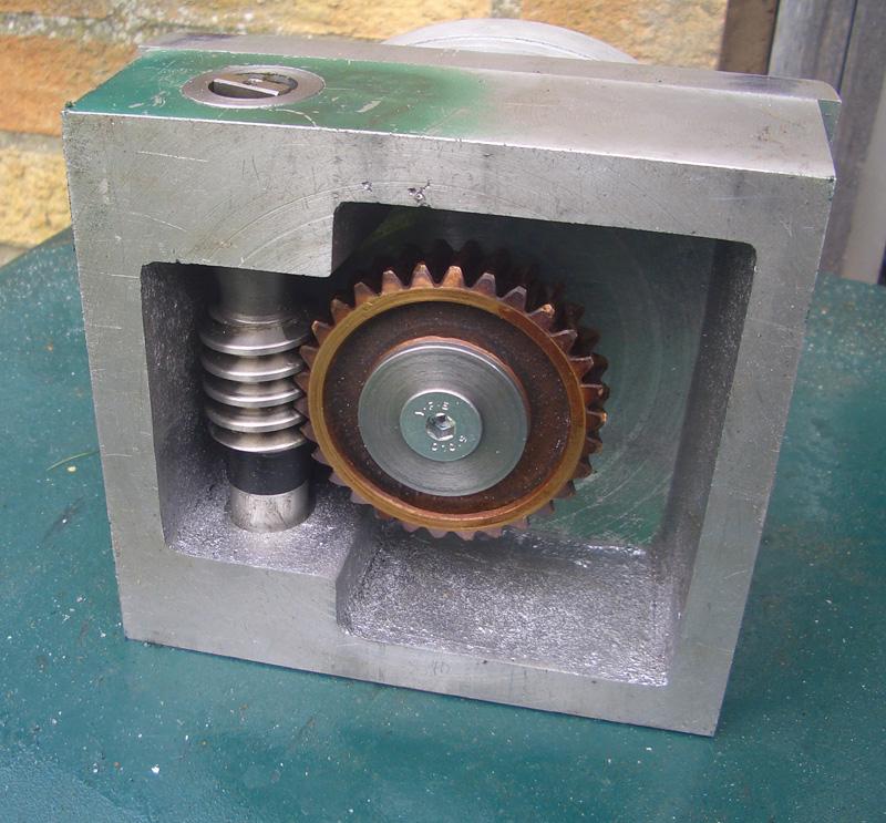

I also made the bushes to mount the worm, when pressed in the worm rotates freely and without any play.

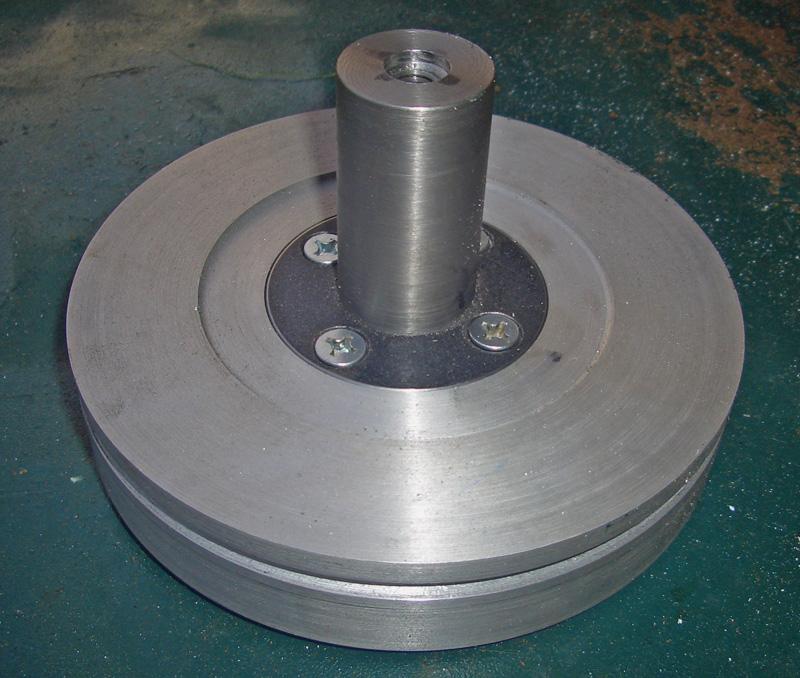

« Reply #33 on: September 09, 2014, 10:49:53 AM »

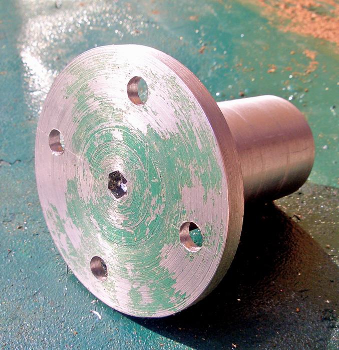

The main spindle is done. I just made it from two pieces of steel bolted together. I may cut a keyway to engage with the worm wheel but it is quite a snug fit and may not be necessary.

« Reply #34 on: September 10, 2014, 02:27:56 PM »

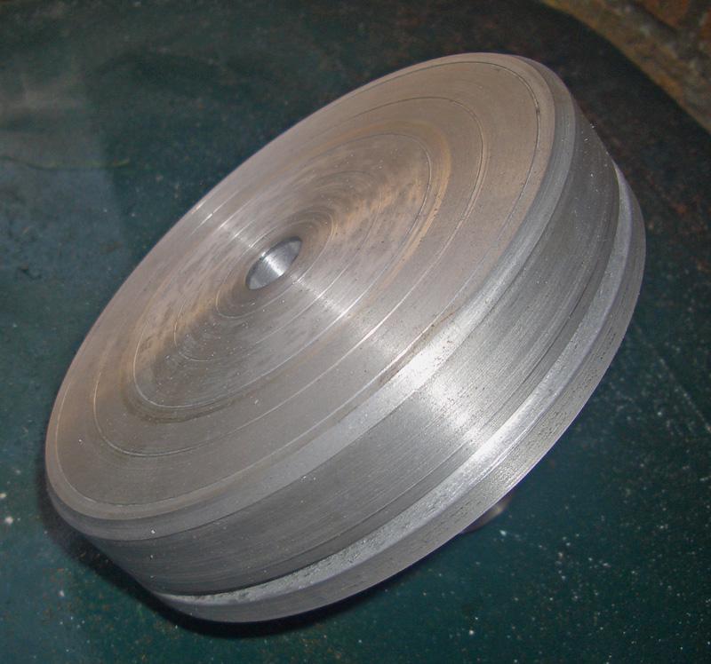

I cast the table today, despite my misgivings I used charcoal again. This time it was much more successful, it only took an hour to complete the melt and used half as much charcoal. I had a stronger air blast and that seemed to do the trick.
I've also machined it all over and it is now mounted on the spindle.

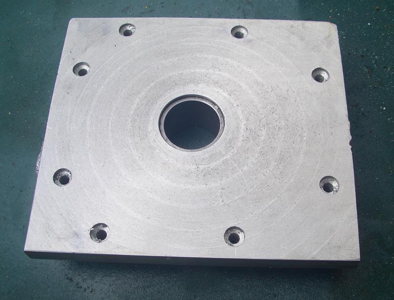

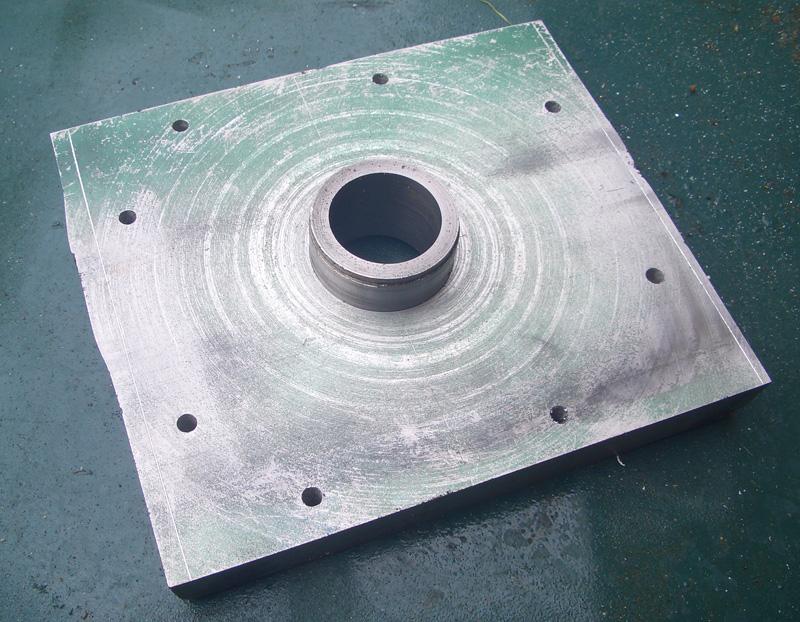

It's not been a good day today. I bored the top plate to take a steel bush for the spindle to run in. I then started on the bush, I managed to make the OD undersize and the ID oversize! So I started again, I was lucky to find that I had a piece of steel just a few thou oversize, but I am fed up with having to hacksaw through 40mm dia. bar (next project, power hacksaw)
I completed the bush correctly this time, a press fit into the top plate and, at the moment, a tight fit on the shaft. Tomorrow I will lap it to fit.
Offline NormanV
  • Posts: 633
  • United Kingdom
Re: Making a Rotary Table
« Reply #41 on: September 13, 2014, 06:04:01 AM »
I finished lapping the bush and pressed it into the top plate and then drilled and tapped the holes for attaching the top to the main body.

« Reply #42 on: September 13, 2014, 06:07:28 AM »

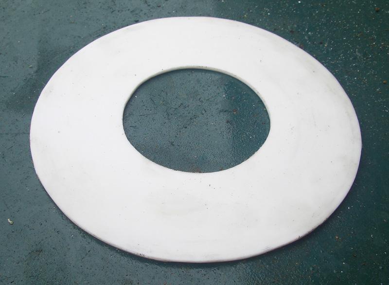

I have used a PTFE washer under the table to reduce friction. I scored the outside circle with my dividers and then snapped the waste material off. It gave a rather ragged edge so I tried cutting it with a scalpel, it cut very easily and gave a much better edge. I had to resort to sanding the outer edge to smooth it.

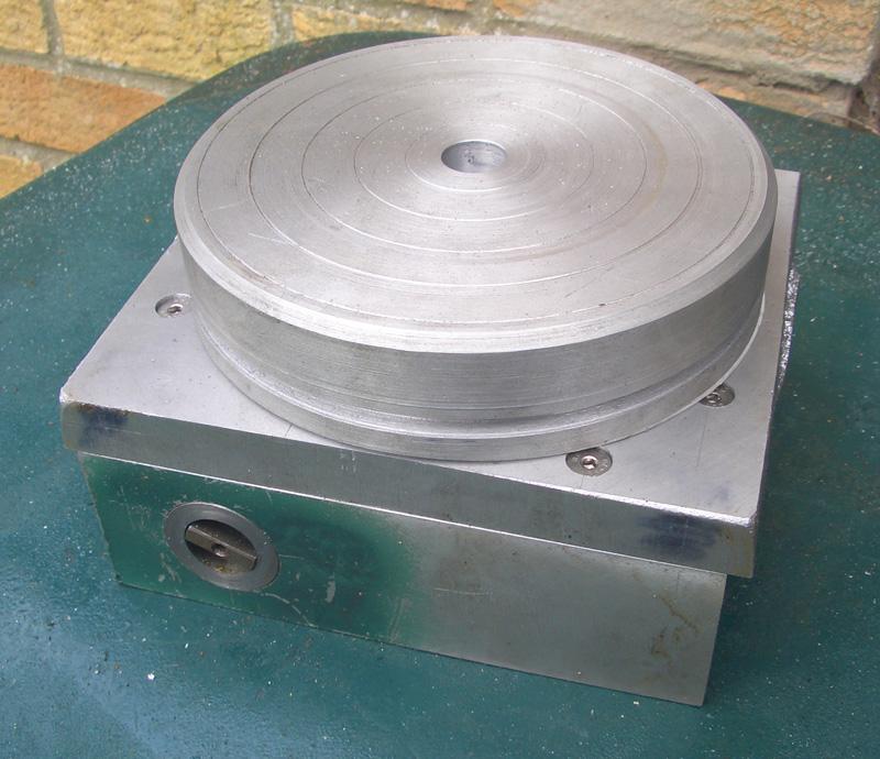

« Reply #43 on: September 13, 2014, 06:11:38 AM »
Then the exciting part! First assembly, it all fitted together nicely. You will notice that I have left the top oversize. This was to enable me to adjust the gears to be free of backlash without the necessity of ultra precision marking out and cutting, this has worked well. The next job is to dismantle it and trim the ends.

 :thumbup: All looking very nice Norman  :thumbup:
Are you going to mill Tee slots or drill and tap a matrix of holes as hold downs?

« Reply #45 on: September 13, 2014, 07:07:24 AM »
I would like to machine tee slots but am a bit nervous of it. I might try first on a piece of scrap. Drilled and tapped holes would be easier plus I wouldn't need to buy or make a cutter.

« Reply #46 on: September 13, 2014, 08:04:27 AM »
If you place tapped holes where you would have put Tee slots, then you have the option of still making the slots at a later date  :ddb:

Good idea Andrew!

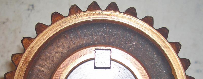

The next job I attempted today was the locate the worm wheel on the shaft. Ideally I would cut a keyway in the shaft to match the one in the gear, I don't yet have the collet to fit the cutter required so I thought that if I put a short grubscrew in the shaft it would locate in the slot. This I did and the gear slipped on beautifully and was fixed in position on the shaft. Unfortunately it makes it impossible to assemble due to the curved face of the worm wheel!
Plan two is to drill a hole axially into the end, half in the shaft and half in the wheel and pin it, I've done it before to lock loco wheels onto their axle so I know it will work.
Plan three is to be patient and wait until I get the correct size collet!

Norman,
make a temporary collet on your lathe. Chuck up a bar of a size that you do have a collet for, drill suitably for the cutter, fix with a grub screw. Take light cuts. OK it won't be as accurate as a collet, but should suit the job in hand, especially if your cutter is narrower than the slot and you are cutting in two passes, one each side.
Alternately you could 'shape' the key way in the lathe using a parting tool held sideways, or with a bit of hss suitably ground. Youtube abounds with examples :)
Offline NormanV
  • Posts: 633
  • United Kingdom
« Reply #49 on: September 13, 2014, 03:00:55 PM »
Andrew, you make me feel a bit foolish, I seem to be looking for the problems that don't exist. I did exactly what you suggested and made a holder for the cutter to fit in a larger collet. The whole thing took about 30 minutes and I ended up with a proper bit of engineering. Thanks.
