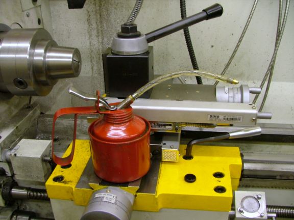

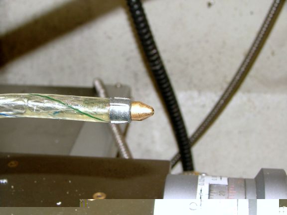

Maybe this will help for the ball oilers.
Look at the attached pics.
I have been using this one for a few years, and even though the nozzle is now getting worn, it still pumps it in like a gud 'un.
The hole in the end is about 1.5mm (1/16") and the angle looks to be about 60 degrees, so you should be able to make one to fit your gun.
With regards to lubricants, even though I don't like dealing with these people, they do sell small quantities of lubricants for very reasonable prices, just right for model engineering.
http://www.chronos.ltd.uk/acatalog/Chronos_Catalogue_Oils__Lubricants___Adhesives_etc_124.html
The larger oilcan at the very bottom of the list looks just like the one I use.
