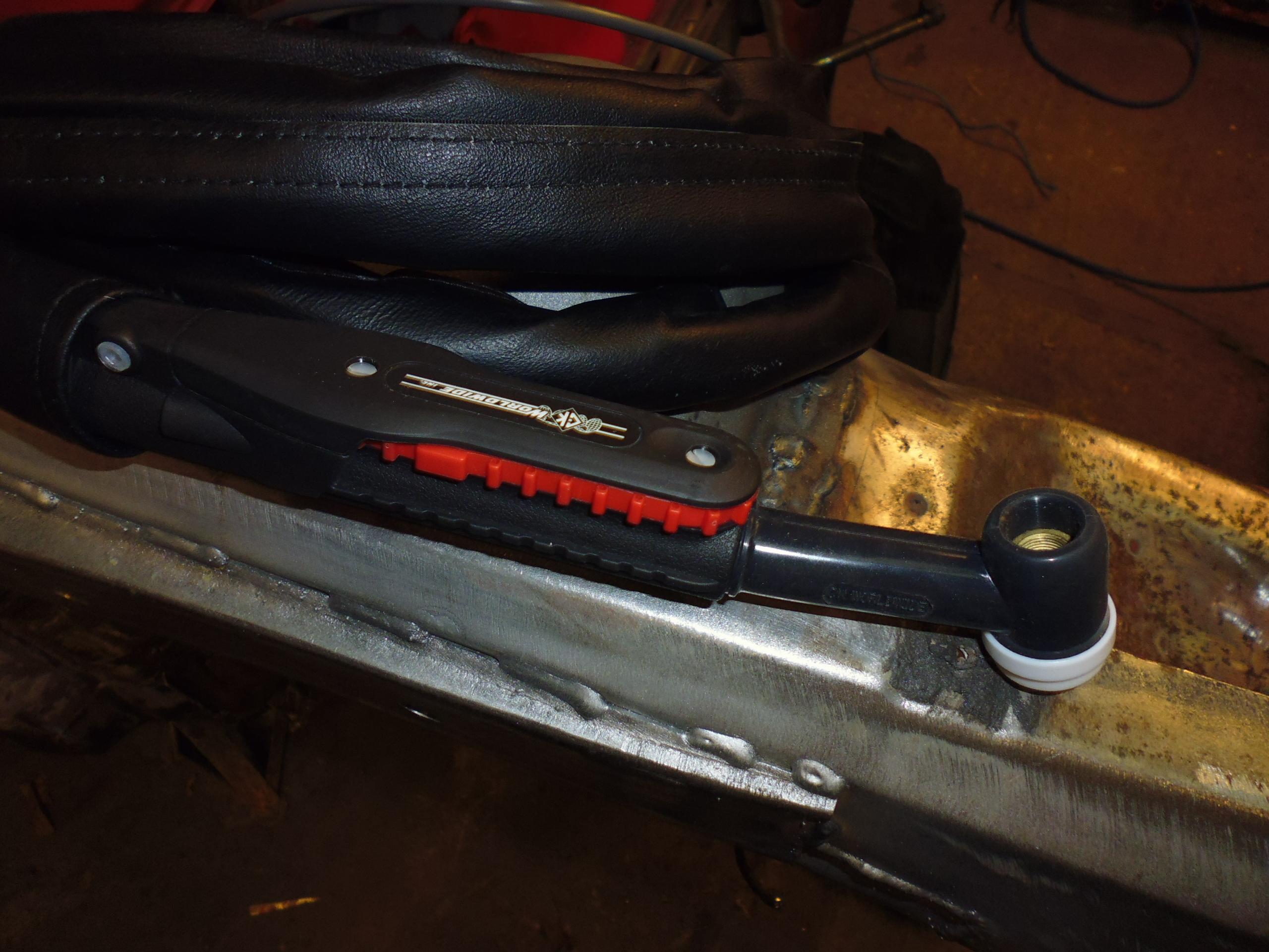

Hey all,
I've recently picked up a Rtech AcDc tig and most importantly a good price on  CK torch with built in rotary amperage control. Now I knew the R tech would need a 47K pot for the input and the CK torch is a 10K, they don't do a 47K or indeed anything close and the CK price make my eyes water too!
Plan A was maybe to find a suitable slider pot to mod, but again 47k is hard to find a slider and impossible in the correct travel and with switch. So plan B is use the 10k pot to input to a Arduino, then have that control RC type servo or stepper motor linked to a 47K pot going into the tig.
Does that sound like a feasible plan or do any one have a better suggestion?  It's been while since I programmed anything but kind of sounds a interesting thing to try  :beer:

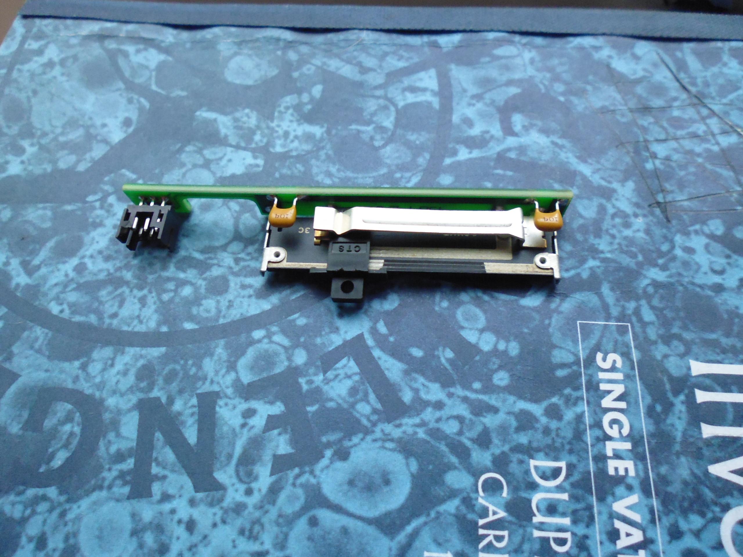

Hi Gary,
Yeah a new pot would be perfect, but alas none will fit. As they say a picture says a thousand words so the first up is the torch and hand control it self, the 2nd is the pot itself. As you can see it would need to fit in the handle, have the correct travel (20mm total) be switched as well to fire up the tig. I notice also the first part of the travel has no resistance, I suspect to make it easier to use perhaps.
CK do other values as well, but only 1k 5k 10k and 25K, they want £110 for one of those little switch/ pot things!

Those controls are made by a firm called CTS (in the moulding) . If you google CTS Fader you will find them in all sorts of configurations and values
Ahh! Perfect thanks, looks to be a 448x-20ms and they might well do 50k one. Certainly closer to what I need :)
