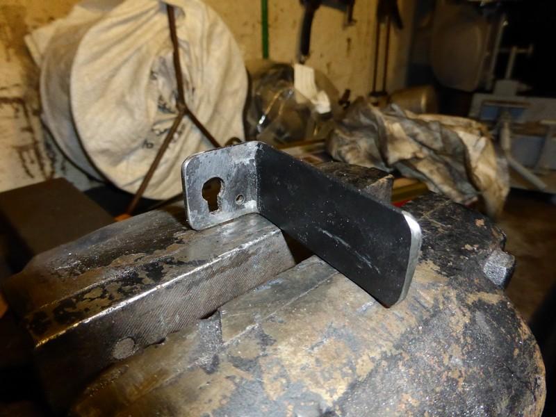

Just got myself a 6X4 Bandsaw so looked how to improve it a little.
I know these bandsaws have been modded before but I've not seen this mod before so hope it helps others who like the mod.
When you need to load stock for cutting you have to hold the blade up and manually make it safe with the rear latch so decided to make this automatic making it much easier and safer, any way here's the pictures
Don't know what happened to the pics so I will try again
http://i145.photobucket.com/albums/r210/mfletch_bucket/P1000332_zpse9c5b1f6.jpg6X4 Bandsaw Mod
http://i145.photobucket.com/albums/r210/mfletch_bucket/P1000325_zps3d45243b.jpg6X4 Bandsaw Mod
http://i145.photobucket.com/albums/r210/mfletch_bucket/P1000330_zps6a113879.jpg6X4 Bandsaw Mod
http://i145.photobucket.com/albums/r210/mfletch_bucket/P1000331_zps3aad4fb7.jpg6X4 Bandsaw Mod
http://i145.photobucket.com/albums/r210/mfletch_bucket/P1000335_zps2a61214e.jpg6X4 Bandsaw Mod
http://i145.photobucket.com/albums/r210/mfletch_bucket/P1000342_zpsf5819f28.jpg6X4 Bandsaw Mod
http://i145.photobucket.com/albums/r210/mfletch_bucket/P1000341_zpse9af8af7.jpg6X4 Bandsaw Mod
http://i145.photobucket.com/albums/r210/mfletch_bucket/P1000344_zps6b05e15d.jpg6X4 Bandsaw Mod
The latch is spring loaded so it engages the latch on lifting the arm up and all you do is push the rod to disengage the latch and if you don't want to use the latch it can be locked in the down position

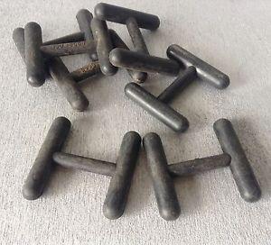

fletch, I just thought I'd share a simple little modification idea with you that I will be doing on my saw.
The hinged cover on the belt housing on my saw is clamped shut with a screw,so every time I want to change belt speed I have to completely remove the screw,which is a bit of a pain.
So what I am considering as a more convenient improvement is to abandon the screw idea altogether and fit one or two of the stretch type rubber bungee toggle closers to the hinged lid,or I may even make some myself from inner tube rubber....What do you think?.....OZ.
Offline mfletch
  • Posts: 86
Re: 6X4 Bandsaw Mod
« Reply #22 on: February 08, 2014, 01:11:59 PM »
Good idea OZ on mine its a little plastic wheel so you don't need a screw drive
Just thought of something else what would work I will see if I can attach a pic
Re: 6X4 Bandsaw Mod
« Reply #23 on: February 08, 2014, 01:59:06 PM »
Yeah, they look a viable option but the reason I plumped for a bungee type is I think there would be less chance of the lid making any annoying rattling noises due to the motor vibration.
I was also looking at these.....
