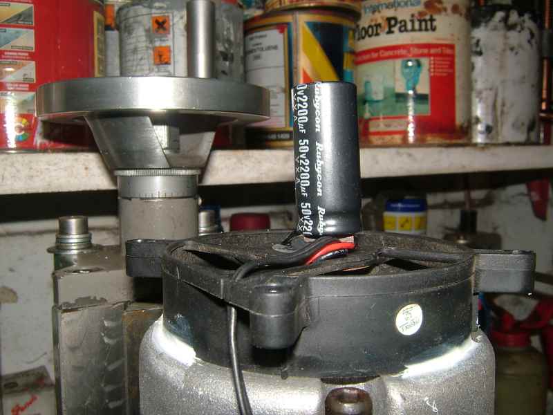

There was plenty of space under the motor cover for a fan and some hunting in a box of old fans produced a circular fan that sat nicely on top of the motor.  It needed 12V DC.  The mill already has a built in 12V lamp which runs off a 12V electronic transformer.  I decided not to rectify the AC at the transformer as the diode voltage drop would make the light dimmer, so I used a rectifier that would sit on top of the fan motor and wired it in to the lamp 12V AC.  I needed to add a capacitor to smooth the rectified AC.  The value was chosen by increasing the size until there was no improvement in the fan’s performance.
The fan was secured to the top of the motor with a bead of silicon sealant.  The rectifier was secured to the fan in the same way.
I considered adding some more cooling slots to the motor cover.  There are already some in the back, but decided to wait and see how much difference the improved airflow made.
I also reduced the fuse rating in an effort to protect the new motor.  The new one hasn’t blown yet so I may reduce it some more.  An occasional blown fuse is a trivial amount of cost and effort compared to a replacement motor.

Russ,
Good idea using the 12v feed from the lamp to power the fan......but, if it is 12 v ac or more, your capacitor is not long for this world.....
12*1.414 gives a peak voltage of nearly 17vdc.....not good for a 16 v cap.....you may want to consider changing it..before the cap expires and it starts snowing..... :zap:

Re: Mini Mill Modifications
« Reply #2 on: January 23, 2014, 10:08:23 AM »
Hi John
You're quite right.  I had overlooked the RMS factor.  However if I push the margins to the limits there are two diodes in the circuit at any one time so presumably the peak voltage would be 1.4 volts less.  Or is that just bad practice?
« Reply #3 on: January 23, 2014, 11:01:14 AM »
Well I don't think it's good practice so I changed it.  I had a 50V one salvaged from something I threw away, and although slightly larger it still fits under the cover OK.
Thank you John for pointing it out.
