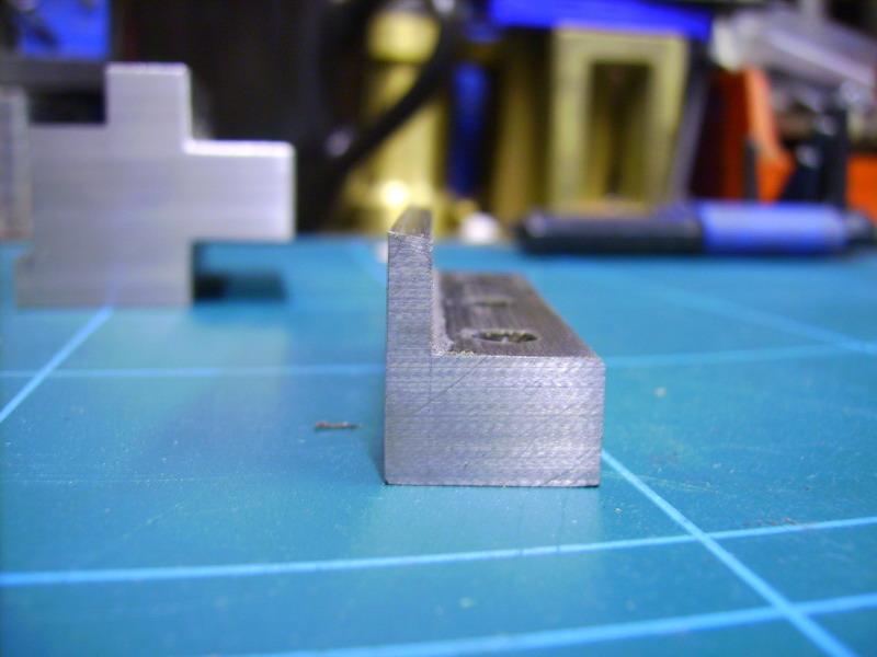

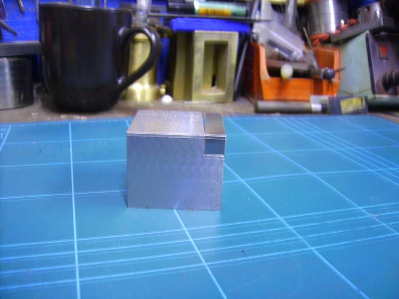

Set onto mill. Align crank axis with 1/4" silver steel shaft.......
48mm in X. 18mm in Y. Spot face, and drill/ ream through, 4mm........
Rotate 180* Offset 18mm 'tother side, in Y. And spot/ drill/ ream to 4mm......
1/4" slot. Blummin chuck jaw's in the way.......
Add temporary, pre used, crank discs, plus cranks........
We got a finger engine........
It works very well, for a temporary set up!  :ddb:  :ddb:
