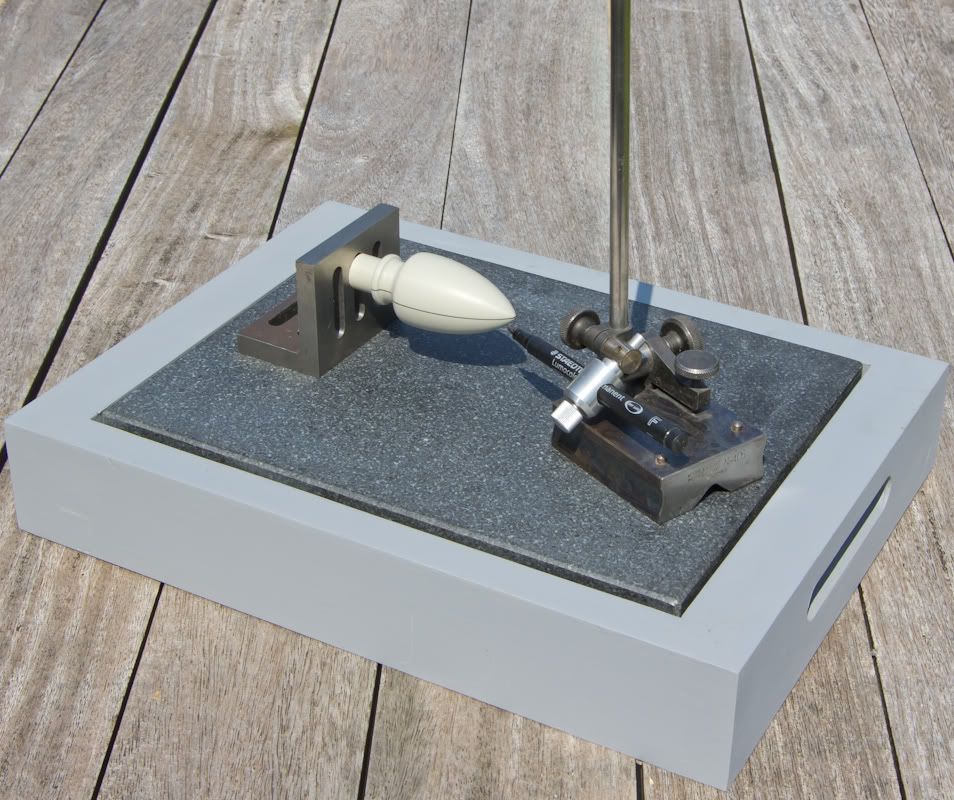

« Reply #6 on: January 10, 2014, 05:20:44 AM »
I cut the joints and finger grips for my surface plate box on my mill. The grips (slots) were done with a bull nosed cutter. Wood is Poplar.
http://i230.photobucket.com/albums/ee286/Arbalist/IMGP16581.jpgmachining wood :) help please
