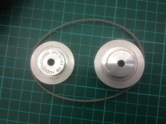

Pulleys and belt for the encoder reduction drive came in the post this morning, no time to fit as we have guests for lunch
Andrew

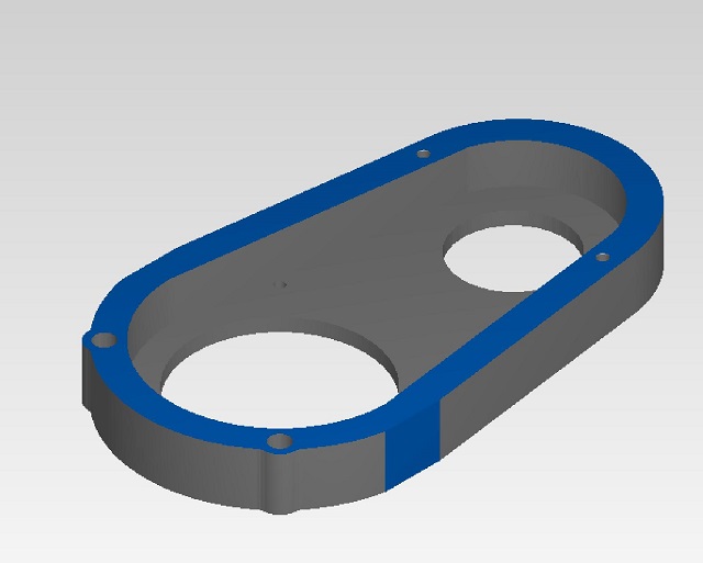

So this morning I've finish off the CAD drawing for the reduction belt drive to the encoder. Now I just need to work out how to hold the stock when machining. (Stock is 200 mm off that long plank of 100 mm x 20 mm aluminium) As I want to cnc mill it at one setting I obviously cannot just grip it in the vice, and there are no convenient lands to put bolt in from underneither that won't finally be cut away.  :scratch:
Any suggestions welcome  :wave:
Incidentally you can see on the rendering that in an ideal world this would be cut from 110 mm stock, but as I've said before, you work with what you have  :med:
Andrew

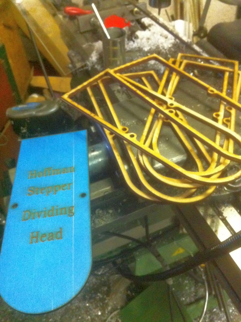

Buy a laser, find an old plywood packing case and start off with this.
A bit of PVA and here's one I made earlier  :ddb:
SNIP
Andrew
Hi there, Andrew,
Surely, it's OK to design in features that facilitate manufacture, even if they don't have a function once the component is in use?
How about a boss between the two holes with one or two tapped holes in their underside?  Is there room between the pulleys?
Drill and tap the holes as stage #1, then screw the blank to a holder-plate.  (Studiously avoiding the terms 'jig' and/or 'fixture'!)   :lol:   :lol:   :lol:
Turn the sandwich over and clamp down via the holder-plate.
Then, stage #2, machine the part according to your drawing (but leave some meat round the tapped holes).
Agreed, this would require two sessions of machining, but .......

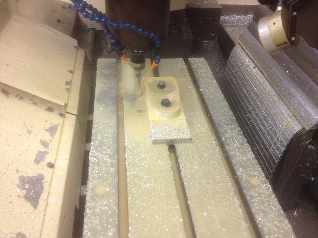

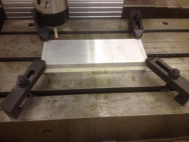

OK John, I KNOW I made a masking tape mock up, but a plywood mount is going too far  :lol:
Peter, Yes I'm going to have to make some form of jig to hold it and do it in two sessions. I did try tentatively using a longer  (*) piece of stock clamped with four hold downs on a sacrificial piece of contiboard. Needs the clearance for the 22 mm profiling cutter to pass round the ends. I put double sided tape between the contiboard and the aluminium to try and reduce vibrations on the finishing cuts, and reduced the through bores by 0.5 mm to leave a solid base to hold things in place. However it let go  :bugeye:
I'd already reduced the feed to 50% of programmed rate and had my hand on the E Stop button so it wasn't too dramatic, but that length of aluminium won't now be the finished item  :(
However as I'd drilled the holes to mount on the Servo motor and the holes to mount the encoder at least I was able to use it as proof that I'd got my hole locations correct  :ddb:
I'm being dragged to a nieces wedding in Bath this weekend so progress will be delayed
(*) I've not yet found how to define 'keep out' areas in Featurecam so I need a fair space between the work and the clamps.
Andrew

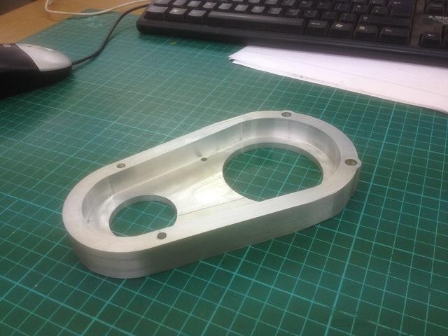

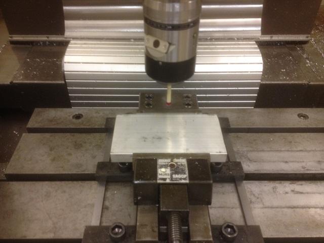

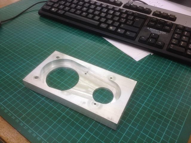

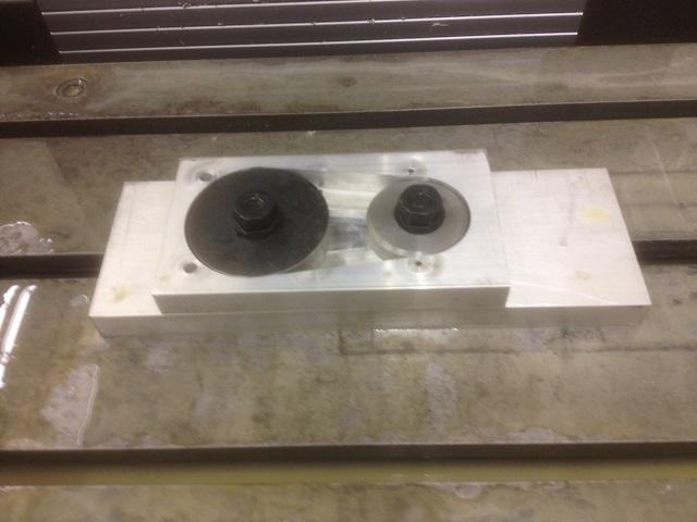

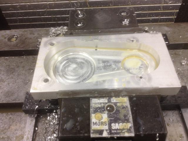

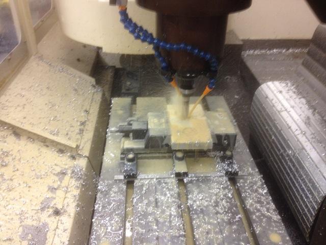

I decided to mill the inner form of the belt drive housing, then make some hold down disk and mill the outer profile as a second operation on a spoil board.
So:
a/ Slice another slab of stock
b/ A few passes with the roughing cutter and finishing cutter
  • Posts: 9161
Re: Servo Driven 4th Axis for CNC Mill
« Reply #66 on: January 20, 2014, 11:23:19 AM »

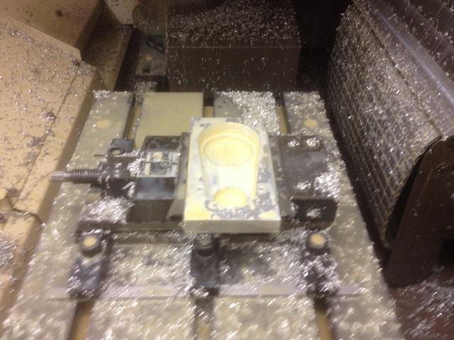

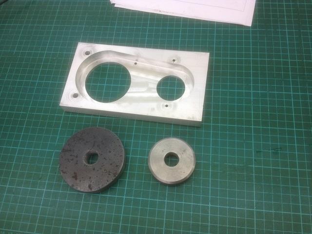

Then make some heavy duty hold down disks and re-tram onto the correct location
  • Posts: 9161
« Reply #67 on: January 20, 2014, 11:24:37 AM »
And go at it again with the roughing and finishing cutters

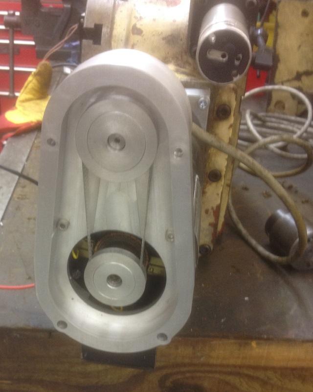

  • Posts: 9161
« Reply #68 on: January 20, 2014, 11:35:25 AM »
It'll do, but there's a bit of hand blending needed where the stock wasn't quite wide enough. Next thing is to get it mounted on the servo motor and fix the encoder so that I can decide how much dishing the cover will need to accommodate the thickness of the pulleys.
Bit of a delay tomorrow as all those hedging plants arrived today and need planting -it's a BIG heap :(
Andrew

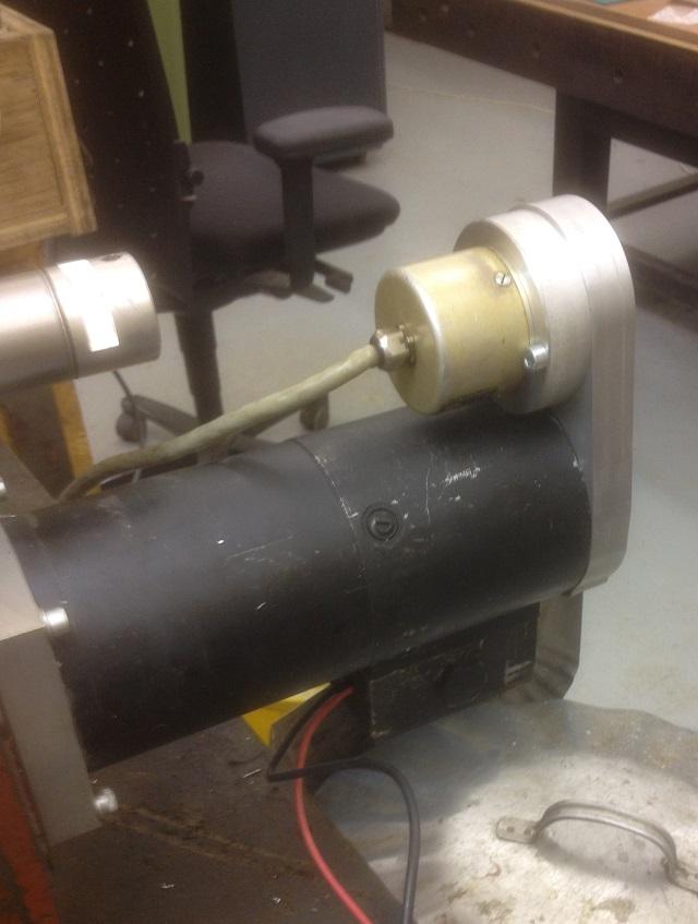

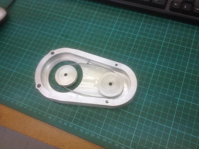

However I've bored and reamed the pulleys and test mounted the drive enclosure on the back of the SEM servo motor, and fitted the encoder thus proving that the allowance for belt tension is ok. But is also shows me I need to bore a hole to let me fix the encoder pulley's grub screw. I'll tap it and seal it with a larger grub screw when the settings are finalised.
Andrew

You seem to have mounted the larger pulley at the smaller end of the casing.  Is that because it's just a trial assembly?  Or have I missed something?
  • Posts: 9161
« Reply #72 on: January 21, 2014, 05:00:07 PM »
Pete,
Yes you ARE confused!  :lol:
The housing has it's two circular ends the size that they are to accommodate the existing mounting holes for the SEM servo motor (larger end) and the Heidenhain encoder (smaller end). However the encoder needs to be slowed down to give 100 counts per motor rev, and not the 125 that one revolution of the encoder gives. Hence the encoder has a 50 tooth pulley, and the servo motor has a 40 tooth one.
Thus one 'table revolution' gives x90 (worm wheel ratio) x4 (gear train ratio) x100 (encoder pulses per motor rev)
so 90 x 4 x 100 = 36,000 which is the count the TNC355 controller needs to give the required accuracy of 100 turns counts per degree
Andrew
