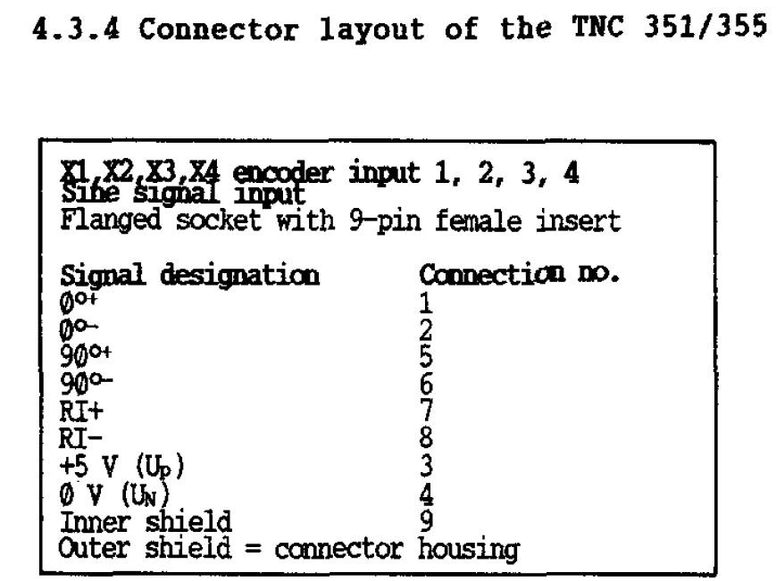

I'm looking at adding a 4th axis to my TNC355 (Denford quatromill).
Silly question
The fourth axis that's on input X4.. In which case its a sine wave encoder ?
X5 is quadrature square wave .
What encoder did you use on your system , I see it has to be 180000 or 36000.

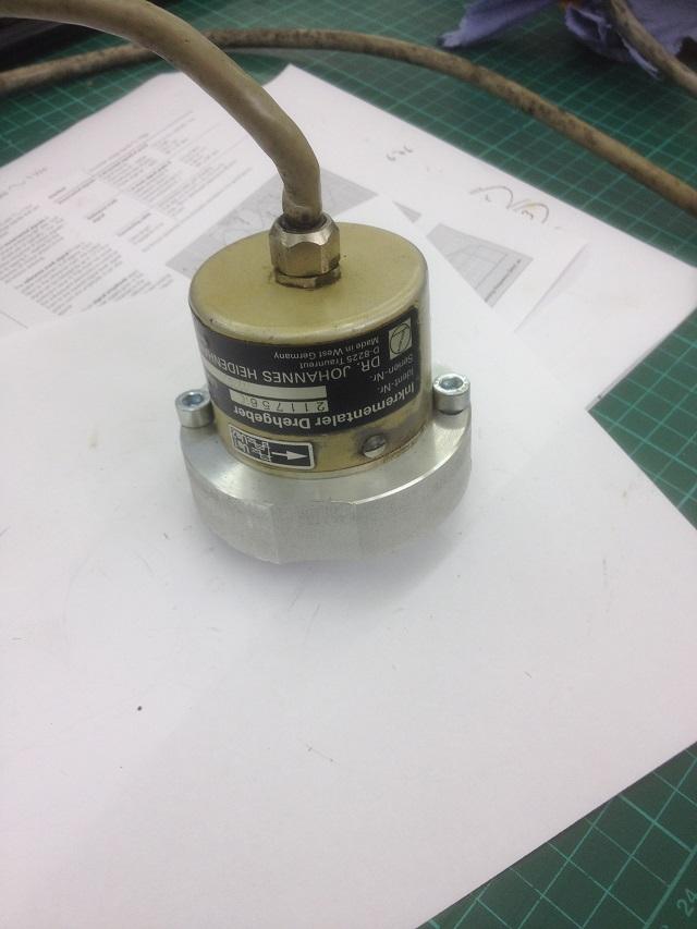

My encoder came from the late lamented good chap John Stevenson, it was a sine wave Heidenhain off a Bridgeport Interact and I'll see if I can find any numbers - hang on . . . .
. . . worryingly my entire directory not only describing this build, but also all my data on the Beaver Partmaster for which it was built seems to have vanished from my hard drive  :bugeye:
. . .but all is not lost, as it is detailed and pictured in reply #2 of this thread - it's a ROD 450B  :thumbup:

If you read the thread I'm sure that there was long discussion regarding counts per rev and belt ratios, however I do have a picture of the encoder (also embedded in this thread) of the encoder with numbers - here it is again:

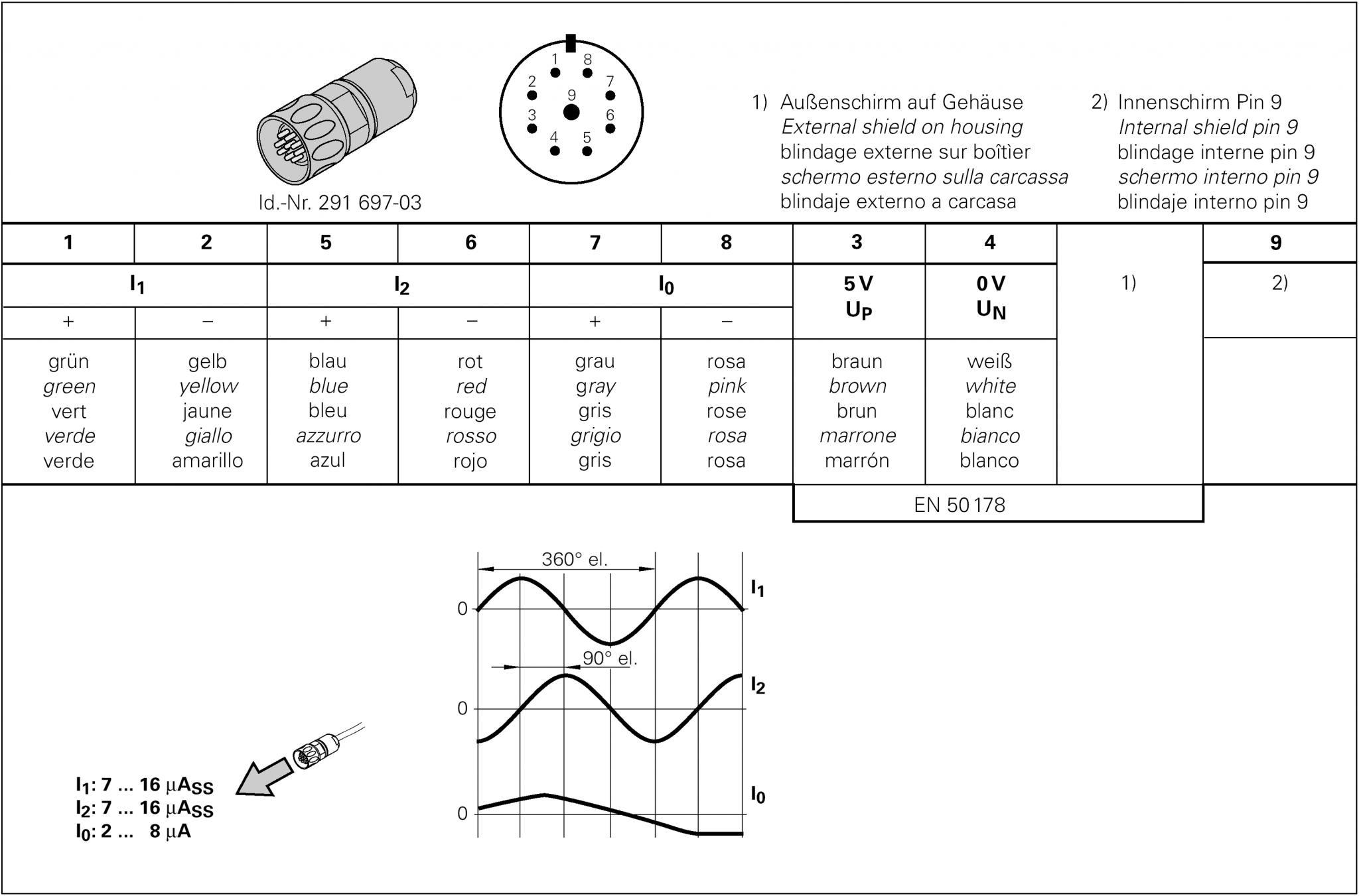

I can't see the number of pulses on that picture but I  just order a ROD 456 1800 02S09-04 Sinusoidal Rotary Encoder.
This will be a 1800 pulse (i'm assuming 1800 is the pulse per rev .. Again not sure of their numbering system) so I can gear it to give 36000, as it was a reasonable price.
The RI+/- signal confuses me and I can't find any info anywhere .
Is it a once per rev ? And needs selective gating so it can only appear during a specific angle range ?
I think I same something about gating in th thread so I will work back through it .

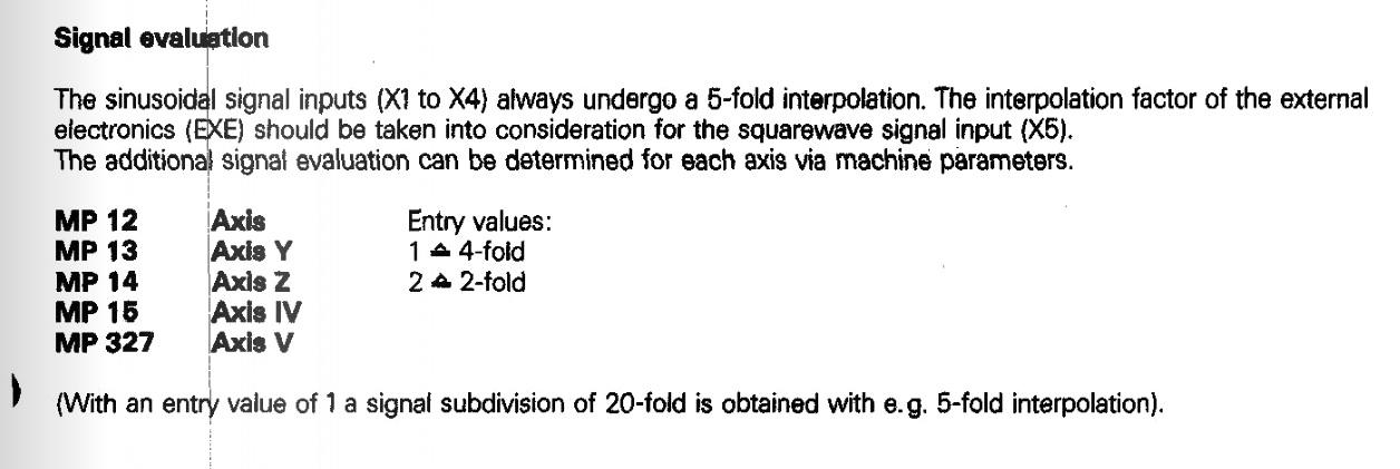

I worked through all the relevant settings
summary
Andrews settings
MP 3 : 2500 - 4th axis rapid
MP 7 : 2000 - Manual feed 4th axis
MP 11 : 1800 - approach speed approaching ref marks 4th axis
MP 15 : 2  - sig eval input x4 x x interpolation
MP 19 : 0 Traverse direction approaching marks ( 0 positive)
MP 23 : axis IV ref pulse inhibit active/inactive
 on connector X10
0 - Ref pulse inhibit
2 - Ref pulse inhibit active
A ref mark is traversed every full rotation of the sensor .
If there are multiple pulses the pulse inhibit can be controlled by a cam switch or similar.
MP 27 : 0 Polarity Positive with traverse dir
MP 31 : 0 Integral factor (set to 0 ?)
MP 35 : 1.000 Differential factor set to 0 ?
MP 39 : +0.000 Backlash compensation
MP 43 : +0.000 Linear compensation factor (keep to 0)
MP 50 : +30000.000 software limit switch range +
MP 51 : -30000.000 software limit switch range -
MP 59 : 14 ZYX IV ref mark approach seq
MP 72 : 0 P all axis set to non inhibit
MP 90 : 0 axis designation of 4th axis 0 = A
MP 166 : 500 Feed speed for 4th axis for param 126-156
MP 180 : 2.000 4th axis KV factor value 0.1-10
MP 189 : +0.000 datum for 4th axis position block for M92
MP 256 : 0 allocation of encoder inpit to 4th axis
0- Standard allocation
4- Encoder x4
MP 299 : 0.250 4th axis accel
MP 302 : 9.000 4th axis rapid traverse voltage
Partsmaster 355 option param 158
Notes on setting to enable 4th axis
param 158 needs to be 16
1 = air conditioner
2 = flashing lamp operated with m22 / m23
4 = flashing lamp on when program run is stopped
8 = swarf conveyor
16 = 4th axis present
32 = feedrate effective in toolchange
64 = high speed spindle
128 = override spindle stall
256 = no toolchanger
add up value & enter into param 158
On my Denford Quatromill it already has 128 set for override spindle stall
so its 128 + 16 = 144 to enable 4th axis / 128 disable 4th axis
It appears a 1800 count.. Count is strange as its a sin/cos but then with the basic interpolation of x5 on the TNC355 then a 4 fold in the signal evaluation parame gives the full 36000 with no gearing.
As to enable / disable 4th axis I have yet to test bit it looks like its
either MP72  8 = IV axis inhibited / clear to enable
         MP158 +16 enables 4th axis (on denford quatro it would be 128 = No Ivth axis .. 144 Ivth axis enabled)
I will update when I test.
« Last Edit: July 10, 2020, 04:49:21 AM by gasmeter »

OK to answer the inhibit part of the question.
MP23 is for axis IV on connector X10
I'm lucky enough to not need that as my encoder will give 1 ref pulse  per rev, so I don't need pulse inhibit.
