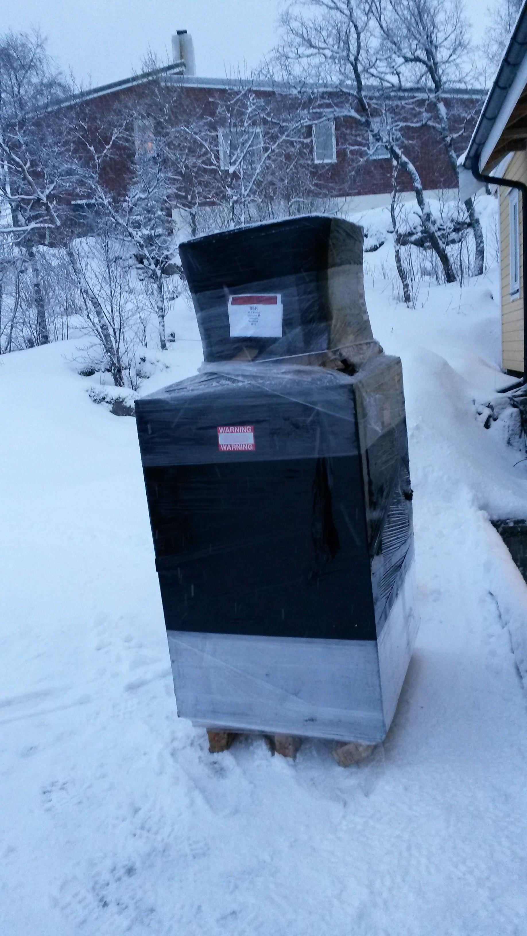

The machine arrived today. Have just got it dismantled and brought in to the basement shop. So far so good, a little bit of deburring and cleaning tomorrow :D

« Reply #26 on: December 04, 2013, 03:50:42 PM »
Damn you already got snow...
That looks really well packed actually. Not like my shitty optimum deliveries.
