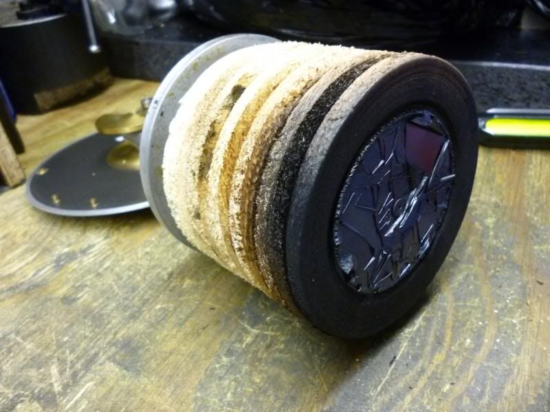

Towards the end of the day, I went for a walk round, to see the other tables. About 1/4 hour.  :med:
When I returned, black smuts were coming from the firebox. And it was blummin HOT!!! :bugeye:
The twin, beeswax candles, had spontaneously combusted........  :bang:
http://i110.photobucket.com/albums/n95/Dayjo/Return%20Album/P1030870_zps84c2965e.jpgFull Roast, Gold Blend.......
Balsa wood doesn't like high temperatures.........
http://i110.photobucket.com/albums/n95/Dayjo/Return%20Album/P1030874_zpsadfb7852.jpgFull Roast, Gold Blend.......
The outside of the cap had a thick coating of soot. And, some pretty colours inside........
http://i110.photobucket.com/albums/n95/Dayjo/Return%20Album/P1030875_zpsc6d48f64.jpgFull Roast, Gold Blend.......
And a sticky, smelly deposit on the piston and displacer rod. Action jammed.......
http://i110.photobucket.com/albums/n95/Dayjo/Return%20Album/P1030876_zps2c3f385a.jpgFull Roast, Gold Blend.......
Time for another rebuild! :palm:
Sigh.......

David, Really good looking engine! Sorry to see the meltdown!  :(  :(  :(
What is the end cap -- it's very strange looking?  :scratch:

Just figured it out, it's paint wrinkled up. It looked like metal pieces to me with bits of allen wrenches or whatever -- kind of Star Wars looking.

Star Wars! You're right Steve. But it is rather more mundane than that. I used the thin, stiff alloy, of a jam jar lid.
The non stick coating has wrinkled......

I made up a bundle of offcuts, to give a 4" square cube.........
http://i110.photobucket.com/albums/n95/Dayjo/Return%20Album/P1030883_zpsa6d57b76.jpgFull Roast, Gold Blend.......
And started to turn it into a former, for the new displacer. Messy stuff.........
http://i110.photobucket.com/albums/n95/Dayjo/Return%20Album/P1030886_zps128ceb4f.jpgFull Roast, Gold Blend.......
Finished article.........
http://i110.photobucket.com/albums/n95/Dayjo/Return%20Album/P1030887_zpsacffb976.jpgFull Roast, Gold Blend.......
Wrapped tinplate around, and soldered the overlap..........
