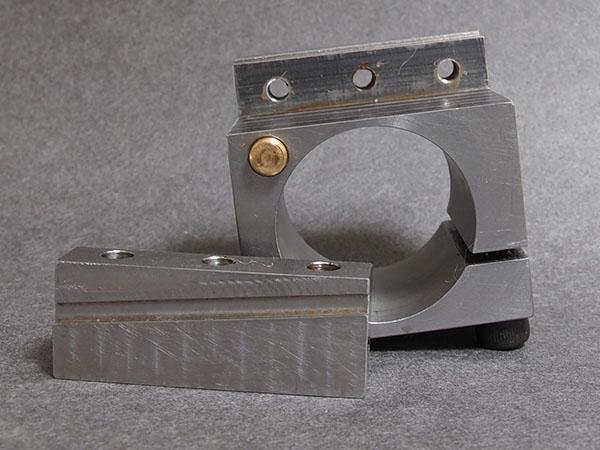

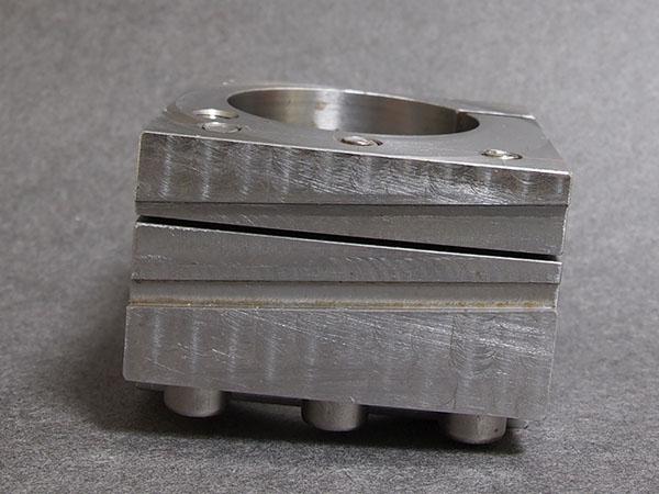

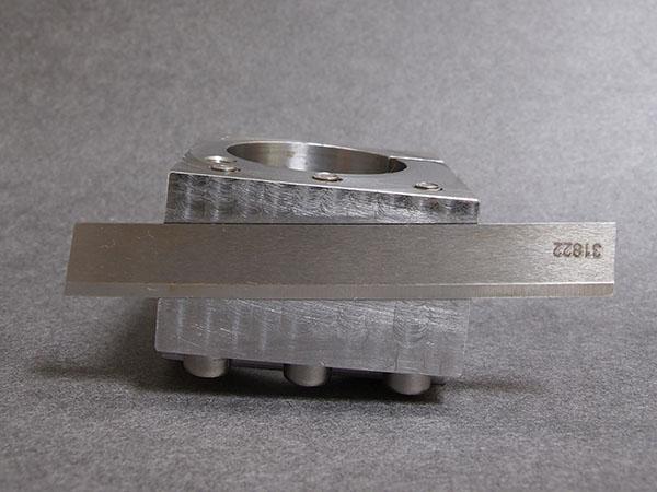

« Reply #2 on: September 11, 2013, 03:20:25 AM »
When I made my pillar and clamp on toolholder style QCTP, the parting toolholders looked like the attached picture (at least I hope it's attached!)  This was for a mini lathe, a Sieg C3, so it runs "backwards" ...clockwise looking from the tailstock.  They have worked very well, the blades are A. R. Warner 0.04" and 1/16" from LMS.  Routinely part off Al. Alloy at 800 or 900 rpm, steel at 400 rpm.
cheers
bp
Re: DIY parting off tool for T-bar parting off blade?
« Reply #3 on: September 11, 2013, 07:28:05 AM »
Thank you.
May I ask few questions about this Bp tool-holder?
1) Judging from the last picture. Is there a little angle to keep the blade against the holder? If not, how well does the blade stays put? On quite a few design people have added some extra screws or camfered the blade and made mating surface.
2) What is the "rake" angle and how do you feel about it? Thank you on the material and rpm information.
I have some A. R. Warner HSS inserts and tool shanks. Like them. If you like Warner, you probably know also Mesa Tool (http://www.mesatool.com/)? Great place to shop. I specially like threading/grroving tools.

Offline bp
  • Posts: 119
« Reply #5 on: September 12, 2013, 12:52:55 AM »
Hi PekkaNF,
1/  No the groove that holds the blade has square sides, you may notice that part of the groove is a little bit deeper to take the "T" piece.  When installing the blade the thinner part of the "T" is pushed home with finger pressure as the screws are nipped up.  It works very well and I have only had the blade come out when I was trying to find the limits, which were trying to take a normal longitudinal cut with a parting tool (!!)
2/  The angle which provides the rake is 5 degrees.  That seems to work well.
Yes I like the AR Warner stuff, I have quite a lot of their tooling.  Mainly I get it from Little Machine Shop, but I'll have a look at Mesa Tool!!
cheers
bp

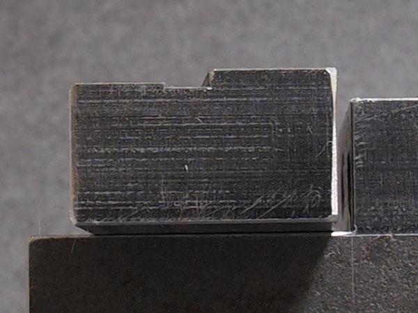

« Reply #7 on: January 10, 2015, 07:46:21 PM »
I've just checked the centre height to tool post measurement and come up with a quick design. Should be simple enough to make if I have the stock.
Offline Arbalist
  • Posts: 673
« Reply #8 on: January 12, 2015, 04:33:07 AM »
After a quick rummage I've found I don't have the material to make the main block in one piece. I've come up with a two piece design though plus clamp that should do the job.
« Reply #9 on: January 12, 2015, 04:47:59 AM »
How are you going to hold the blade?
I have't build that one yet, my GTN3 blade and inserts seem to work good enough, but it looks like a project to try out.
