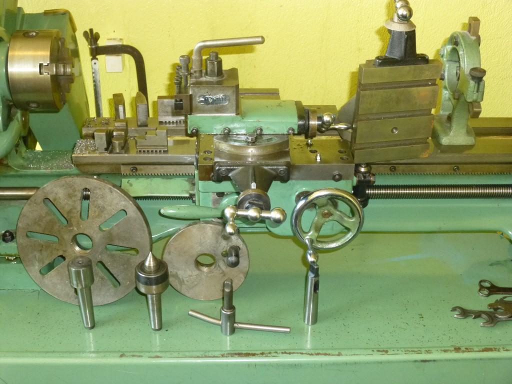

New Toy is coming along nicely.
Cab is washed down. Something has got to the paint quite badly in a few areas.
I'll get some new ordered and make it look a bit nicer.
Next job is attempt 1 at getting it up the first flight of stairs. I'm sure it's gona pick up a few scrapes.

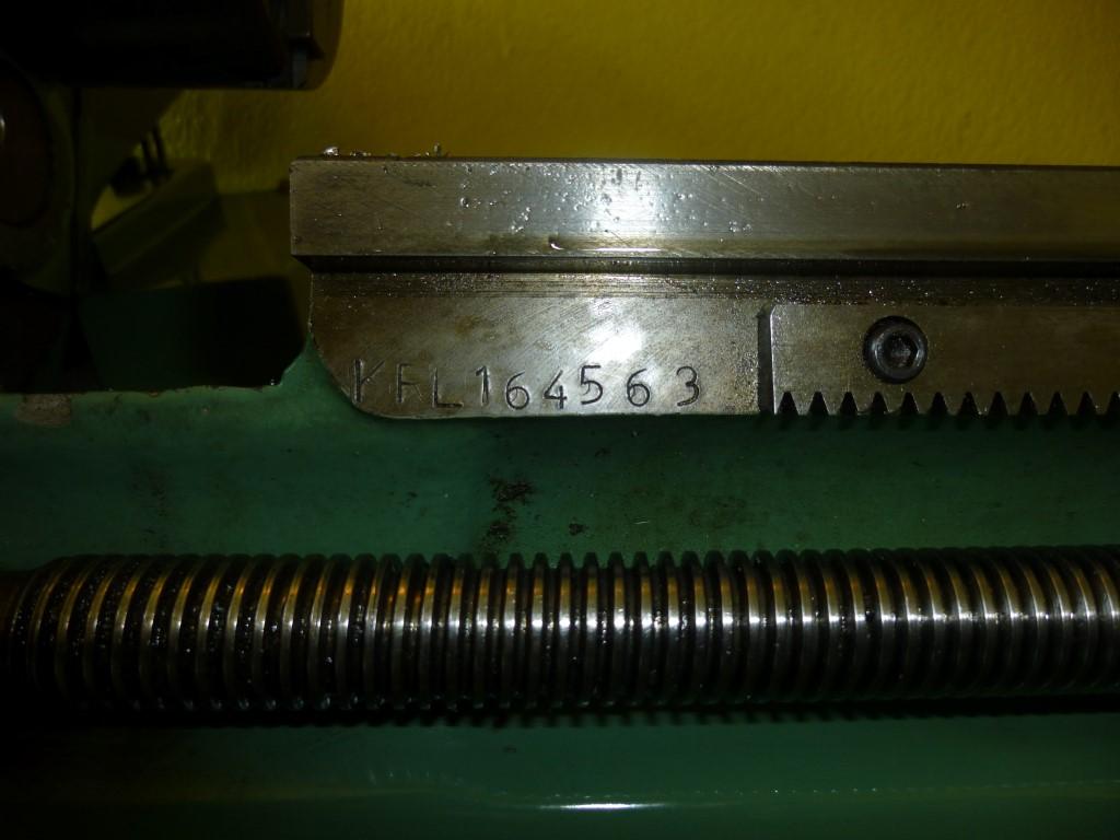

Had a proper look at the Lathe itself.
It really is in nice all round condition, Hardly any wear. Its has /some/ use but very little.

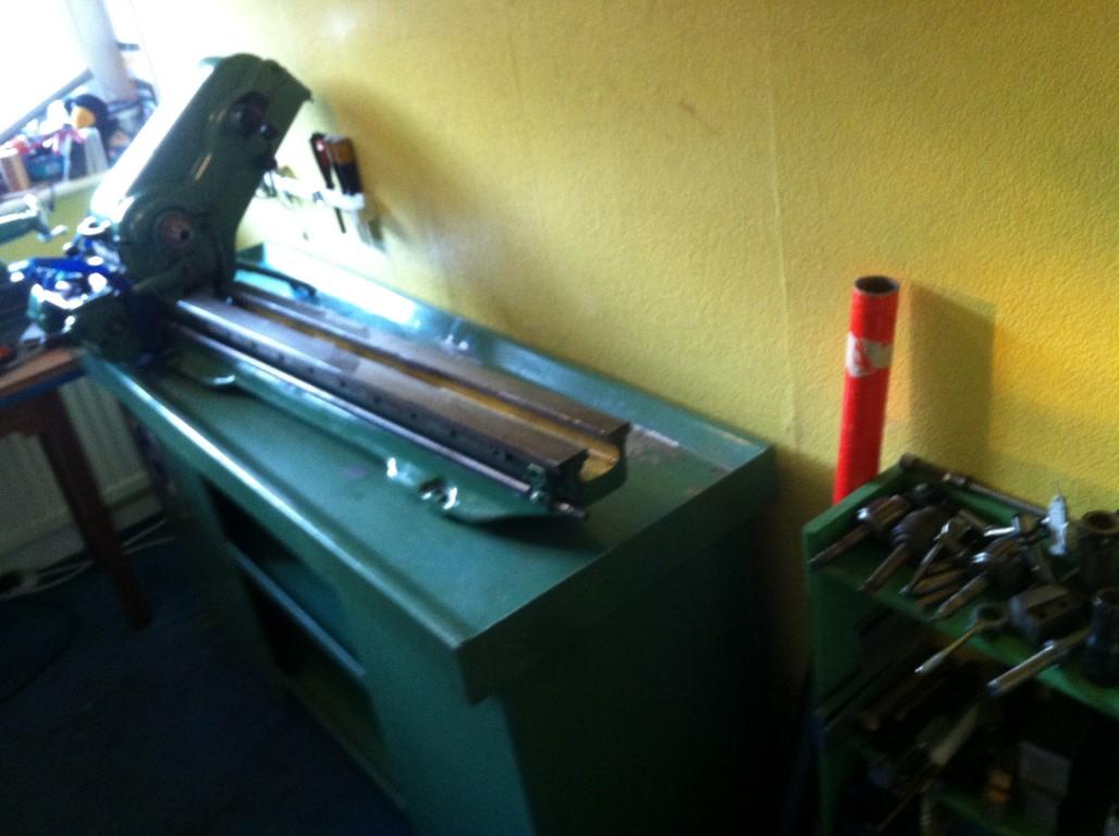

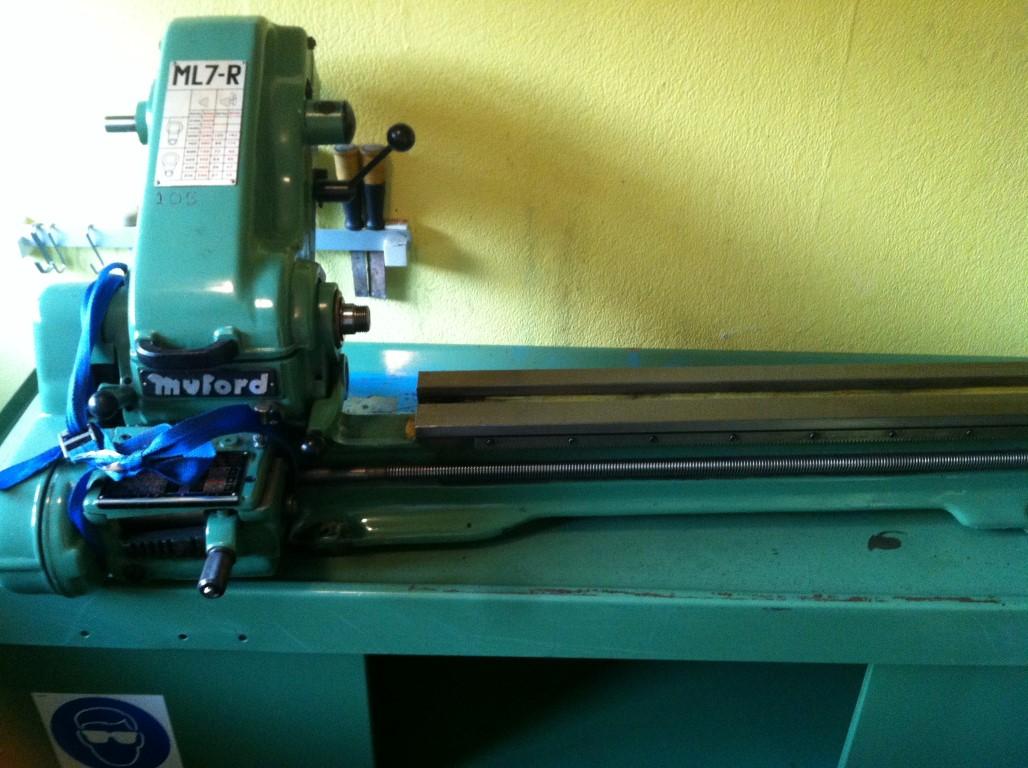

To get the Lathe up stairs I have taken off the Motor, Saddle and Apron and a few other bits to reduce the weight.
Cab is welded steel and there is nothing but the Riser Blocks to pull off that. It's also 5 ft long !
Motor is full of wood dust, as are the Drive Pullys.
Gib Strip in the Compound is bent ! - No idea how but it's bent.
Started to look at the Saddle and it's all gunked up in old solid Grease.
Oh well - stared to clean it and it's been Lubed with Blue Grease of some ilk.
Stripped the entire saddle and cross slide apart and cleaned it.
More rags etc. and the worst of it has gone.
And It Fits !
No Broken bones. A few sore backs no doubt but both the Cab and Lathe are now in their new home.

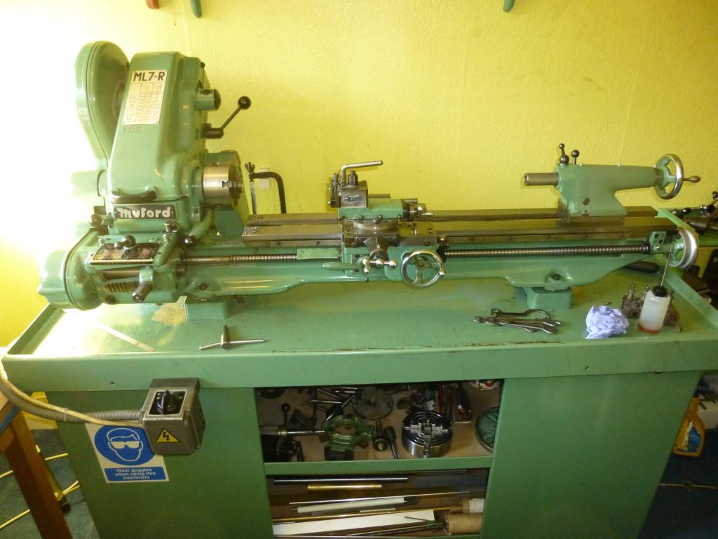

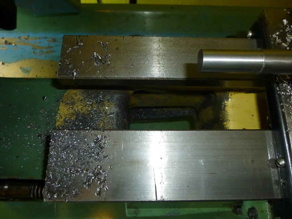

Lathe all setup and working.
I have just faced and turned down an odd bit of 1.2" It machined wonderfully :) Lovely and smooth.
The Long bed Myfords are HUGE by comparison. The Cab is 5' long.
I's fairly clean now and all lubed. A Litre of white spirit, a can of WD40 and 1/2 L of Vectra later.
The Gear Box was as good as empty !
The Lead Screw was really really nasty. Full of solidified grease and wood dust. That took a while to dig out.
All the slides have been pulled apart and rebuilt. They all run beautifully smoothly with no tight spots. Just the way they all should be.
The Gib strip in the top slide was in the wrong way around so the locator was in the wrong place. It was bent at an angle of 30 deg or so. I have no idea but that must have taken some serious force.
All in All it's condition is VERY Good.
Serial number is: KRL 164563  Any Idea when it was made. I'm guessing it's one of the last....

Looking very good, I'll bet the house smells lovely after:
" A Litre of white spirit, a can of WD40 and 1/2 L of Vectra later."
Bet you are glad you changed rather than taking ages restoring your original one  :wave:

Looks very nice, looks like you got a good deal there. Any reason you wanted a long bed or just went for it as it was in good condition?

It's a Long Bed because it was there and I won it. No other reason.
I threw in a bid on Ebay and really didn't expect to win. That machine should have gone for over a £1000, it's certainly worth that....
It really is hardly used and in superb condition all round.
