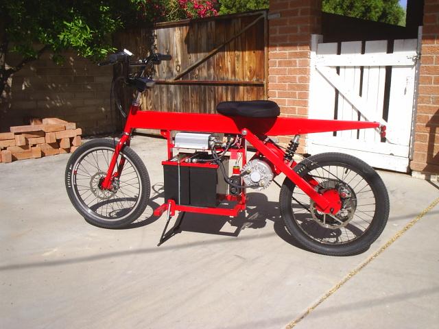

Very nice workmanship, seeing that large space where that pedal crank is reminds me of batteries and electric motor.
More pics of my ebike.
http://ivanbennett.com/e-cycle.html
