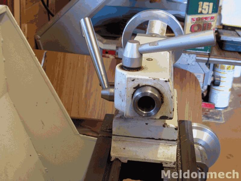

Here's one I made last week end: bits from the odds 'n' sods box & a handle from a book binding machine I had laying around in one of my boxes:

Well done George  :thumbup:
Yours seems to be a bit larger than mine.

Did have a smaller handle on originally..6".. but found that when I was threading some 12mm it took some turning, maybe it was additional drag of the belt & change wheels so as I didn't want to take off the belt & swing the banjo out I decided to increase the length to gain more turning moment & this was all I had to hand, so on it went.. worked a treat..  waste not want not I always sez  :dremel:

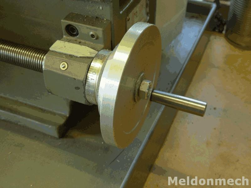

                I have used this idea for holding an indexing plate, attached to the headstock, and for a leadscrew handle.
