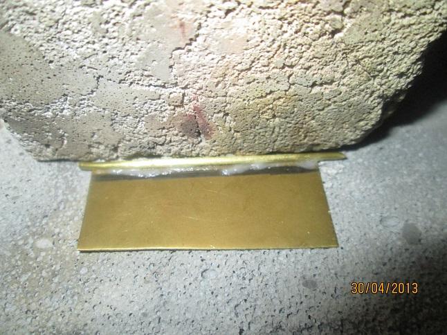

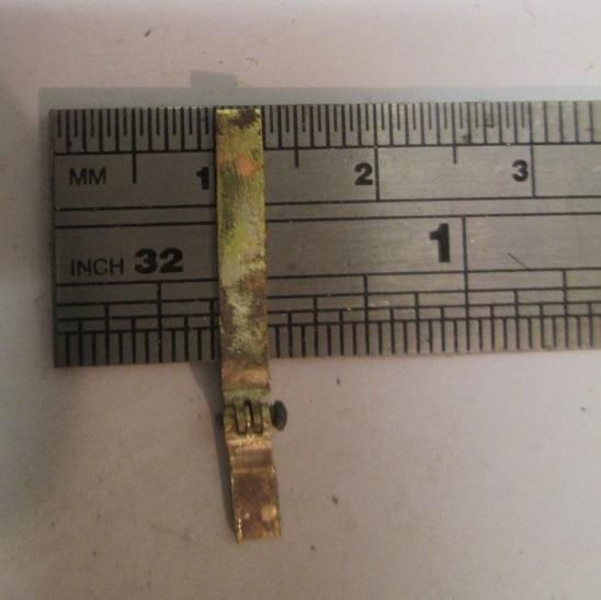

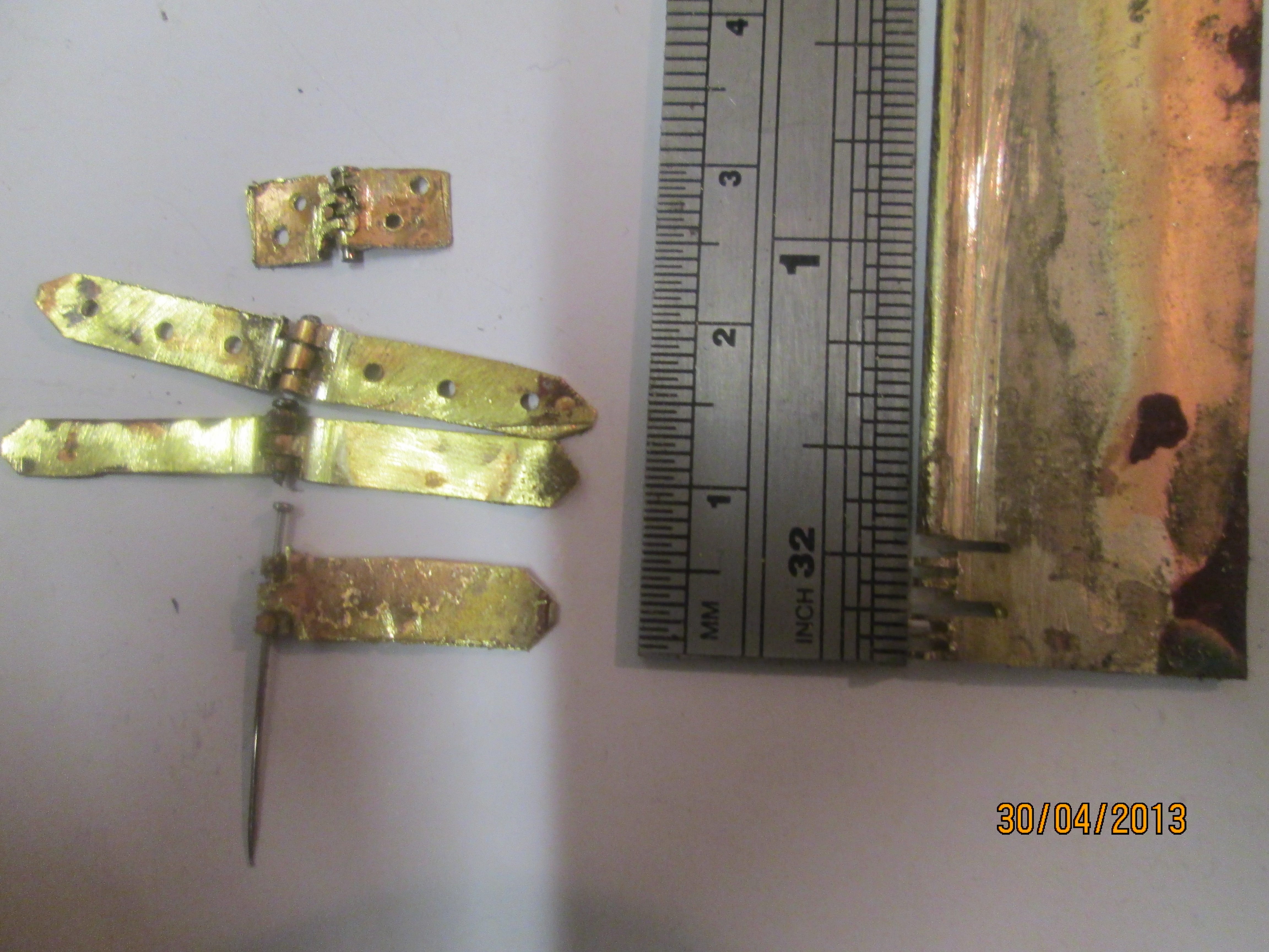

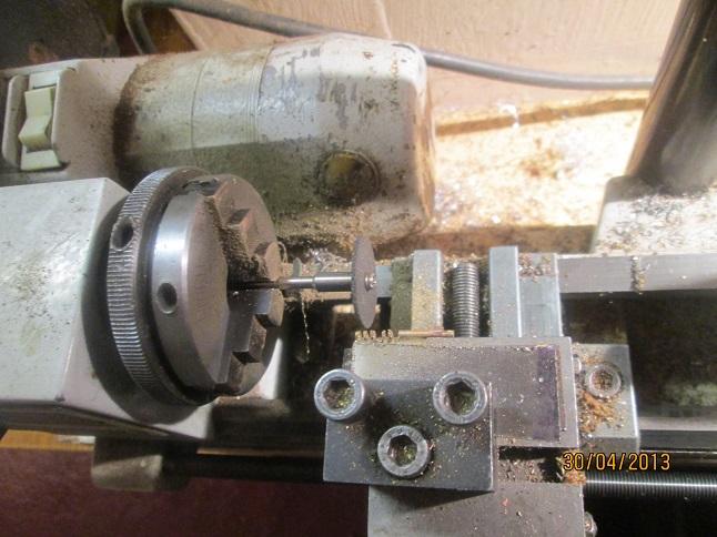

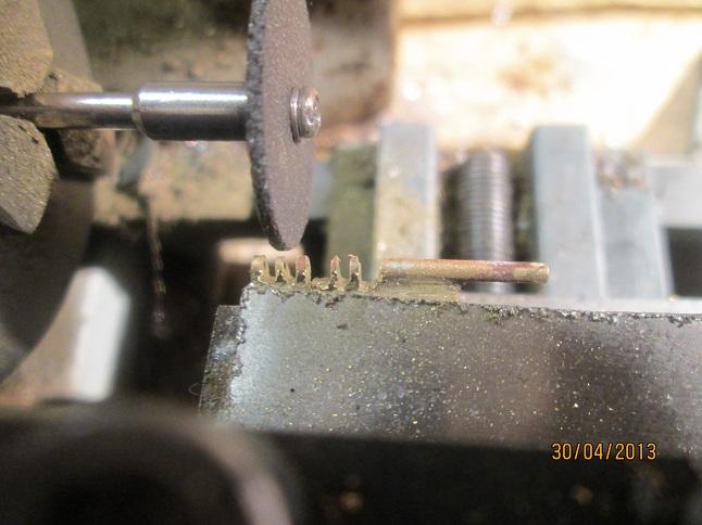

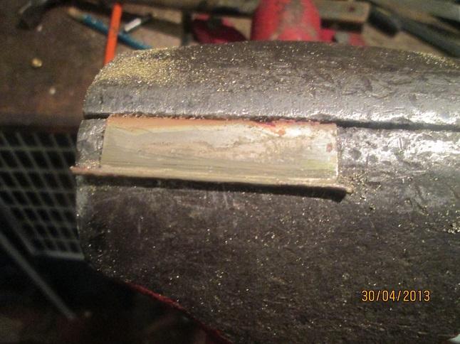

unhinged
« on: April 30, 2013, 09:01:33 AM »
I needed some small hinges for my model paddle steamer. First I cut a strip of .44mm brass plate (wider than required so the blank can be held). Then cut a length of 1.7mm OD brass tube (.5" longer than required so the solder will not fill the hole). Silver solder as soft will melt when grinding the slots. Three different types made now ready for the pickle.
