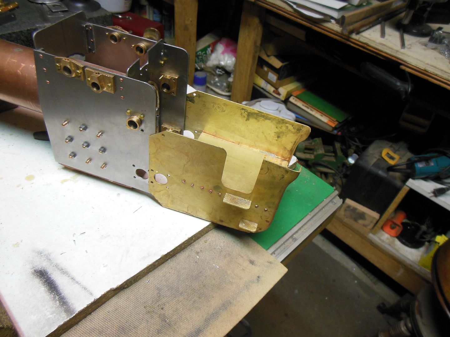

a little progress, got the water pocket done
some drilling, filing, and bending
http://i235.photobucket.com/albums/ee257/240283/DSCN3431_zpspnjk58mg.jpgMinnie TE Long term project
These two bits were then soldered together, and filed to finish dimension.
The plans call for drilling the back plate and the cover with a No 65 drill for a hinge pin, since I've no drills smaller that No 60
I soldered a bit of 1/16" OD tube on each to act as the hinge barrel, worked out OK
here it is temporarily bolted to the tender side
http://i235.photobucket.com/albums/ee257/240283/DSCN3438_zpsrbrm1f5h.jpgMinnie TE Long term project
Joe

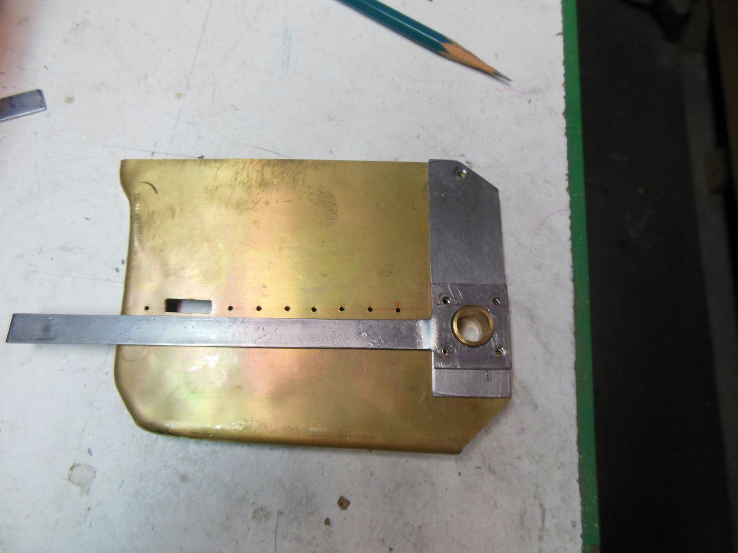

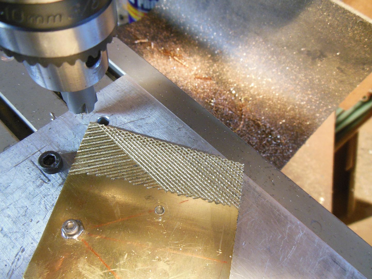

getting a little further along:

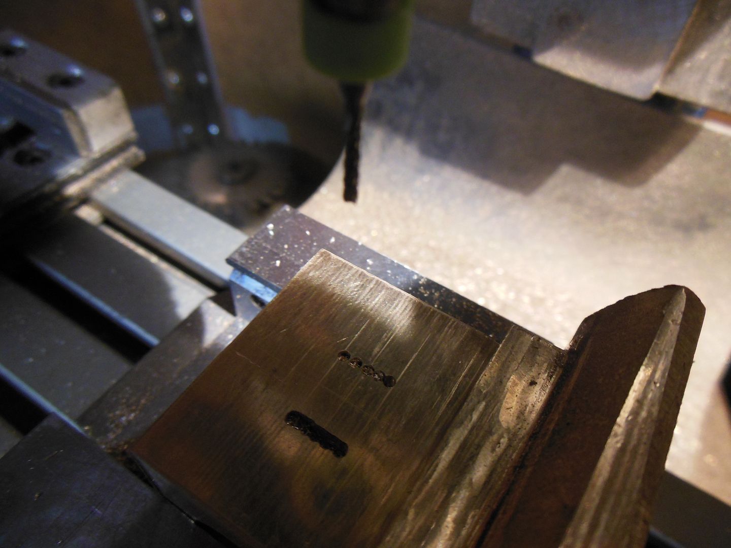

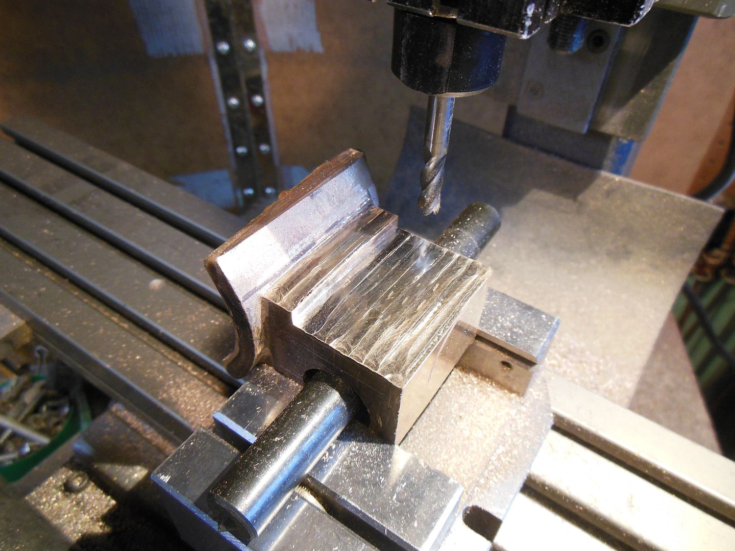

put a piece of flat brass on the mill to start making some tread plate: handily, have a 5 flute countersink
that was just right to use as a cutter
http://i235.photobucket.com/albums/ee257/240283/DSCN3487_zpsqkqyw5yy.jpgMinnie TE Long term project

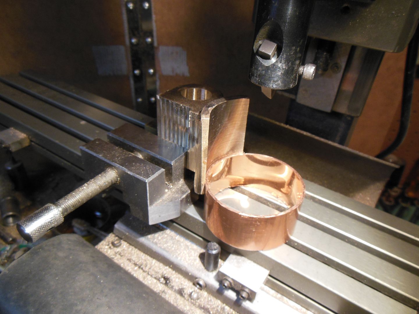

shifted the piece 60 degrees and cut the other direction:
http://i235.photobucket.com/albums/ee257/240283/DSCN3488_zpsxjfvyigy.jpgMinnie TE Long term project

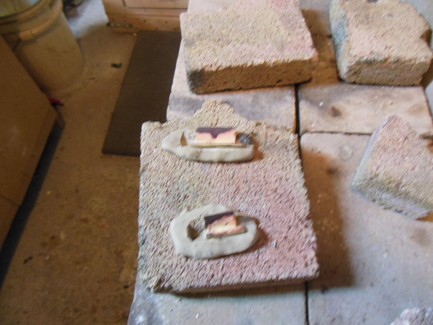

cutout the pieces needed, and soldered on some flat stock as a bracket:  bedded the parts in a little clump of modelling clay
as a work holder for soldering, worked just fine
http://i235.photobucket.com/albums/ee257/240283/DSCN3489_zpseka4oehp.jpgMinnie TE Long term project
some filing, drilled the rivet holes, and bolted in place to have a look:
http://i235.photobucket.com/albums/ee257/240283/DSCN3491_zpsyx9sy3vh.jpgMinnie TE Long term project

 :bow: :bow: :bow: :bow: :bow:  dam fine job Joe  :thumbup:

Tread plate step is so cool!  :clap: :clap: :beer:

Jo, Glad you found my holding method useful.

RGY:  that one goes to very near the top of the "why the hell didn't I think of that a long time ago" list.  Many thanks!

Re Tread Plate:
Seem to remeber this tip:
Anneal some thin brass shim
Get a nice coarse file and place the shim on top. Squeeze in vice jaws, hydraulic press or fly press.
If not steel plate on top and one goodly whack with a lump hammer!
Anyone else aware of this?

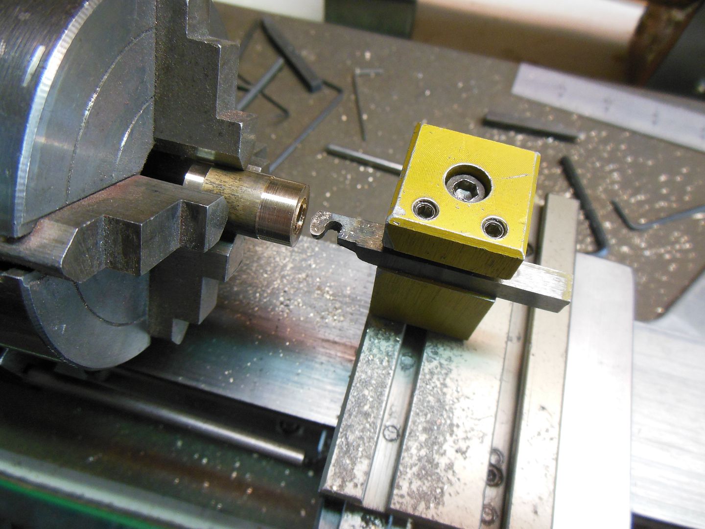

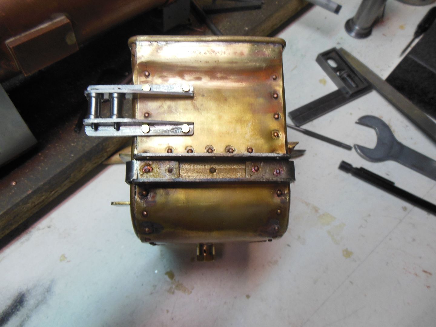

I've been making some progress, but been neglecting to post it...
making some bolts for the cable fairlead, using the filing rest to create the hex head:
http://i235.photobucket.com/albums/ee257/240283/DSCN3504_zpsmophxhn9.jpgMinnie TE Long term project
straightforward filing and drilling to make the angles, simple turning to make the rollers, and looks like this:
http://i235.photobucket.com/albums/ee257/240283/DSCN3506_zpsgqvk7wlm.jpgMinnie TE Long term project
Ground a tool to make the ring fitting for the water-feed banjo
http://i235.photobucket.com/albums/ee257/240283/DSCN3507_zps8u4yu5t9.jpgMinnie TE Long term project
test for fit after riveting in the floor plate
http://i235.photobucket.com/albums/ee257/240283/DSCN3508_zpsjzm4qaup.jpgMinnie TE Long term project
partway through riveting the outer shell

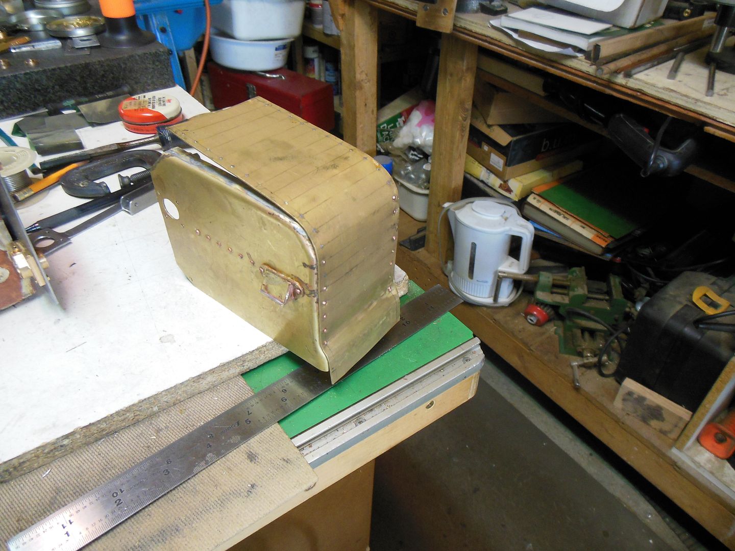

http://i235.photobucket.com/albums/ee257/240283/DSCN3511_zpsqrf8o4hb.jpgMinnie TE Long term project

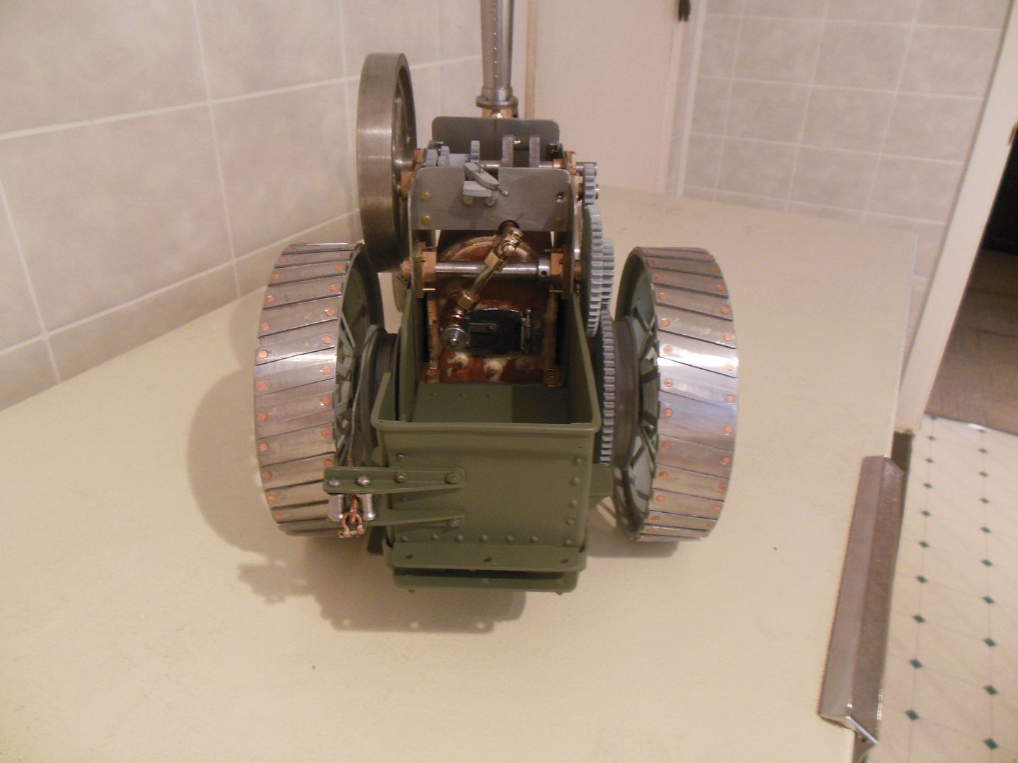

 adding the drawstraps, and the water fitting is soldered on the bottom
http://i235.photobucket.com/albums/ee257/240283/DSCN3553_zpscha5uijc.jpgMinnie TE Long term project
fairlead installed
http://i235.photobucket.com/albums/ee257/240283/DSCN3555_zps6eubcb5x.jpgMinnie TE Long term project
all around cleanup, and a good coat of self-etching primer and lots of re-assembly:
http://i235.photobucket.com/albums/ee257/240283/DSCN3556_zpswmwezisr.jpgMinnie TE Long term project
http://i235.photobucket.com/albums/ee257/240283/DSCN3557_zpscizeyzh5.jpgMinnie TE Long term project
http://i235.photobucket.com/albums/ee257/240283/DSCN3558_zpshooecjfa.jpgMinnie TE Long term project
And that's going to be it for quite a while,  I've got 2 weeks left before I leave town for work until September... :wave:
I'm pretty happy with this winter's progress!

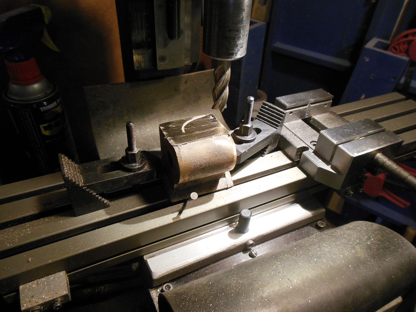

Well, took a month longer than anticipated, but I'm now back at it!
Starting what will be a lot of operations on the cylinder block casting, a quick run over in the mill to create
one flat face to build from for all the various ops:
http://i235.photobucket.com/albums/ee257/240283/DSCN4795_zpsk8kpx8jr.jpgMinnie TE Long term project
That done, into the lathe to bore the hole for the cylinder liner:
http://i235.photobucket.com/albums/ee257/240283/DSCN4796_zpsgncpjcyx.jpgMinnie TE Long term project
Using the bore to locate the casting, machined the valve face almost to finished dimension, leaving a little meat for last minute adjustments
http://i235.photobucket.com/albums/ee257/240283/DSCN4797_zpsy9srtaye.jpgMinnie TE Long term project
That gave me a reference face for the vise so I could cut the curved surface that sits on the barrel of the boiler.  I used a freshly sharpened HSS tool
in a fly cutter, this casting machines like a dream!  Had an off-cut of the boiler material to use to check for fit...
http://i235.photobucket.com/albums/ee257/240283/DSCN4798_zpskxtyudak.jpgMinnie TE Long term project

Thanks Kev.  Steve:  A casting, and a very nice to machine casting indeed.  Something in the bronze family,  and heaps of machining allowance all around.

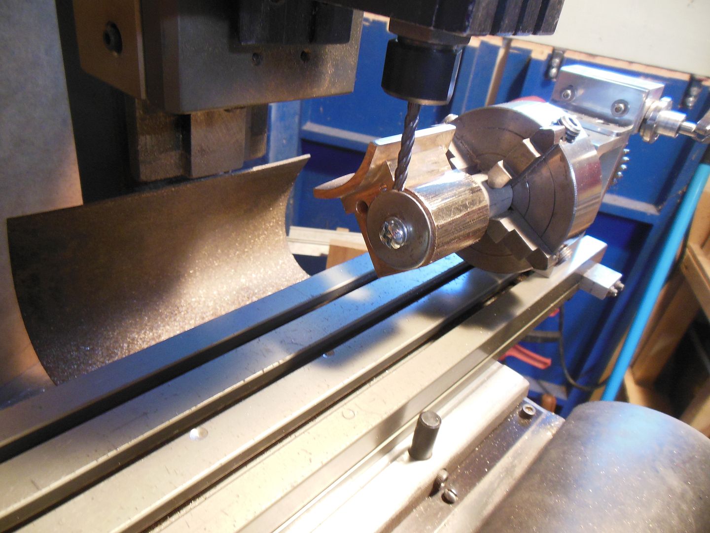

After cutting the saddle, finished bringing the various faces of the cylinder down to size as they are referenced from the
inside of the arc of the saddle
http://i235.photobucket.com/albums/ee257/240283/DSCN4800_zpshzq2goqm.jpgMinnie TE Long term project

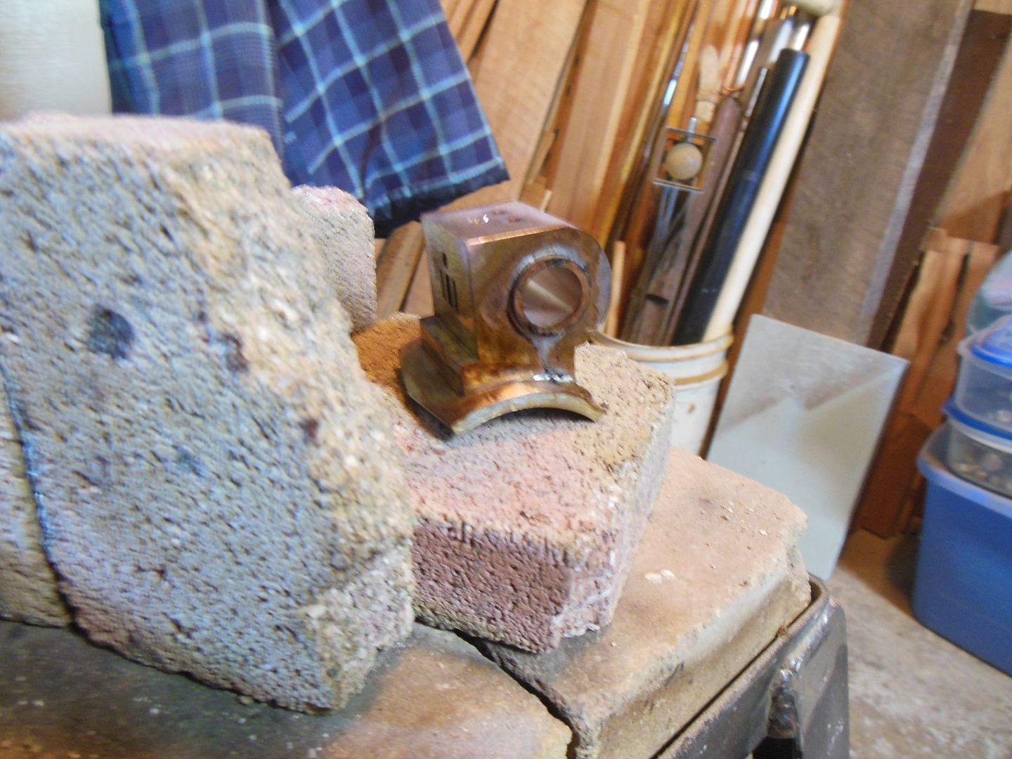

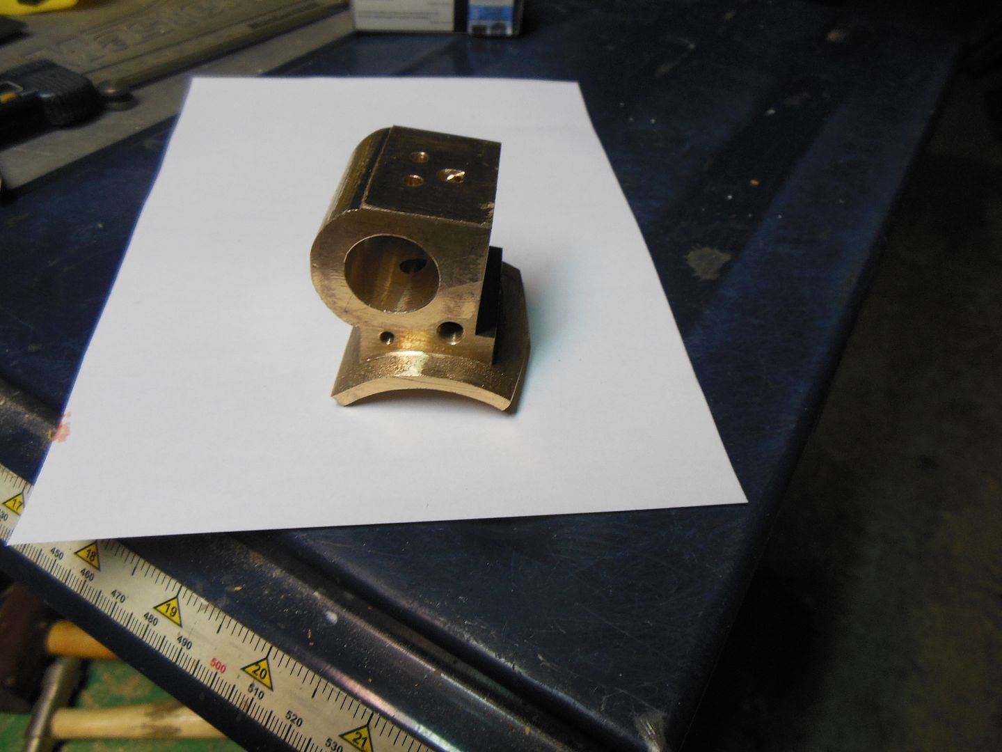

  • Posts: 251
Re: Minnie TE Long term project
« Reply #173 on: October 25, 2015, 10:45:01 PM »

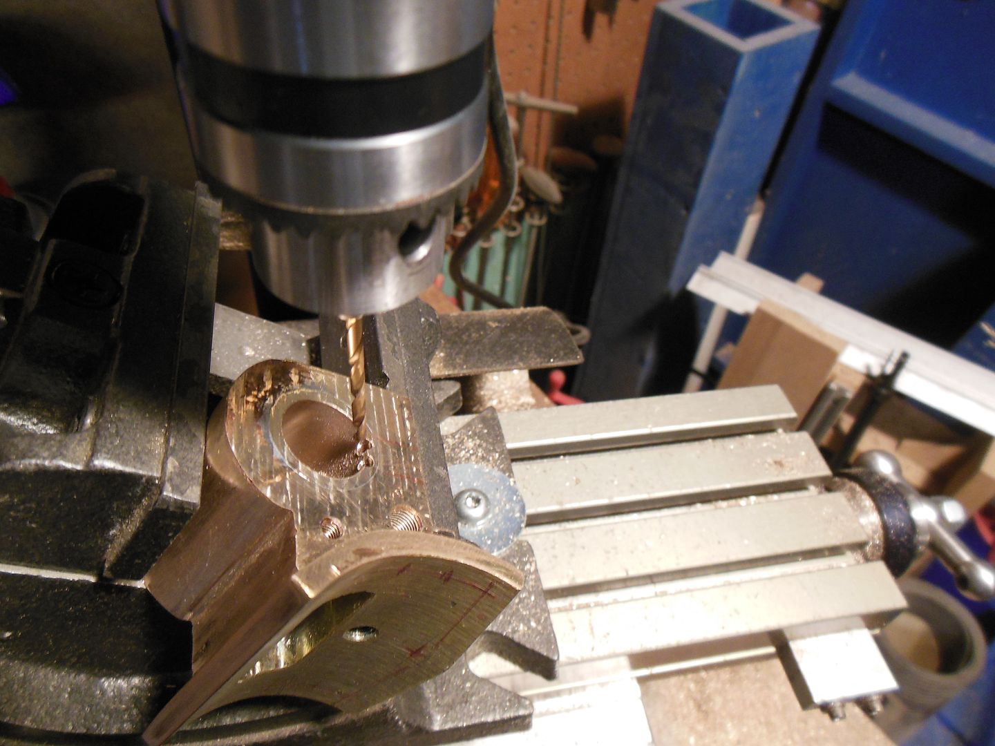

In between some honey-do stuff and a quick trip south to Vermont for the American Precision Museum show,  have got a little further on....

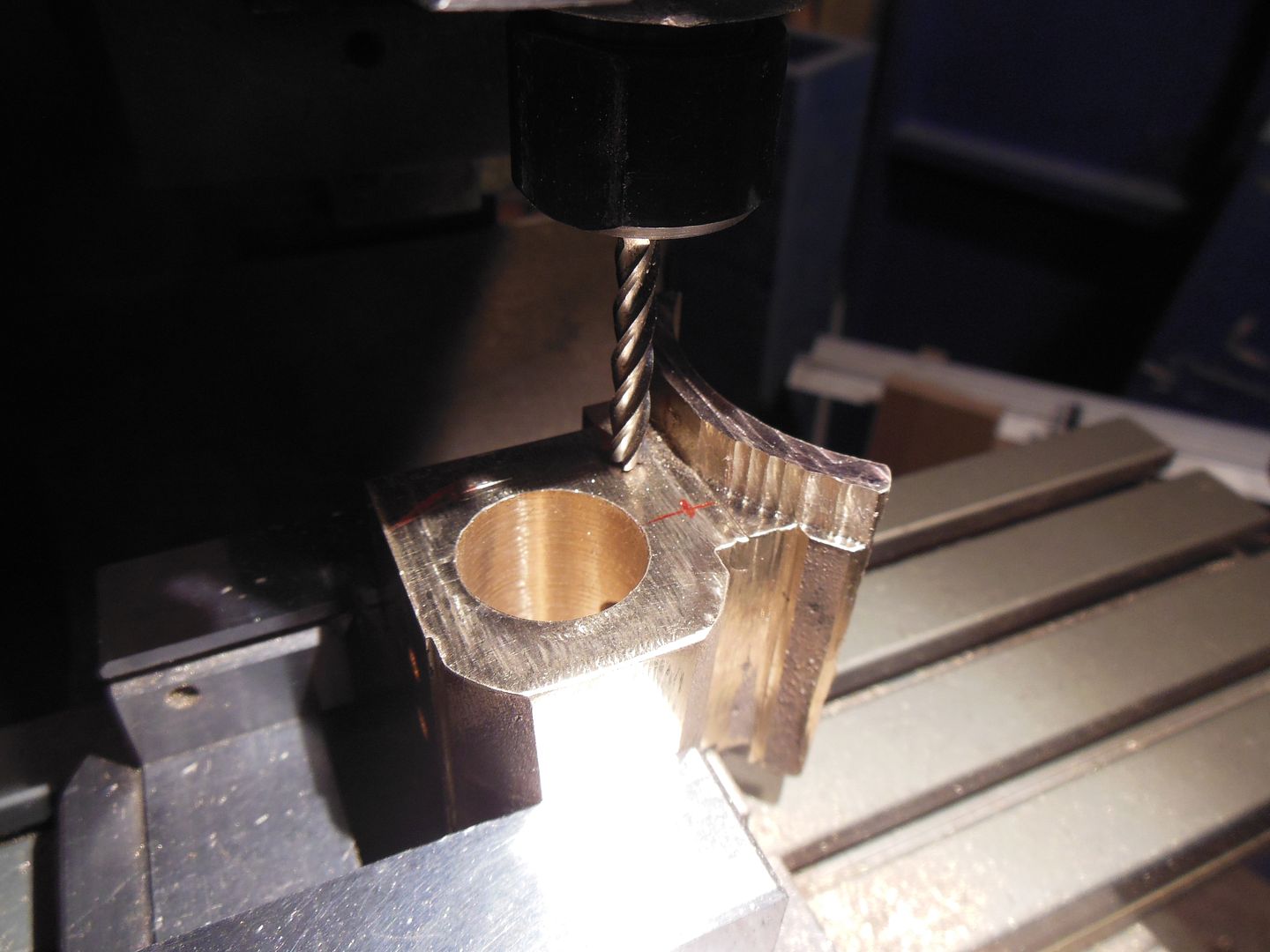

Milling the steam ports:  drilled them out undersized, and them milled them out with a carbide PCB drill that happened to be the required size
http://i235.photobucket.com/albums/ee257/240283/DSCN4803_zpsdgedfevn.jpgMinnie TE Long term project
the exhaust port was easier, a stock size of cutter, and then drilled a steam passage
http://i235.photobucket.com/albums/ee257/240283/DSCN4804_zpsy7uevmhv.jpgMinnie TE Long term project

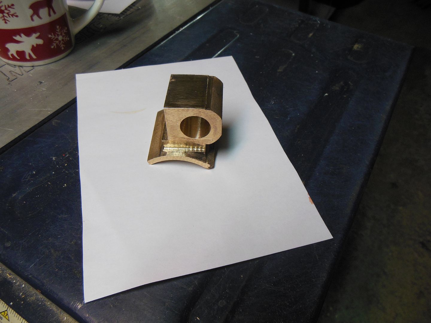

Milled the pocket on the underside that acts as the "steam dome"
http://i235.photobucket.com/albums/ee257/240283/DSCN4805_zpsgzcr54rd.jpgMinnie TE Long term project

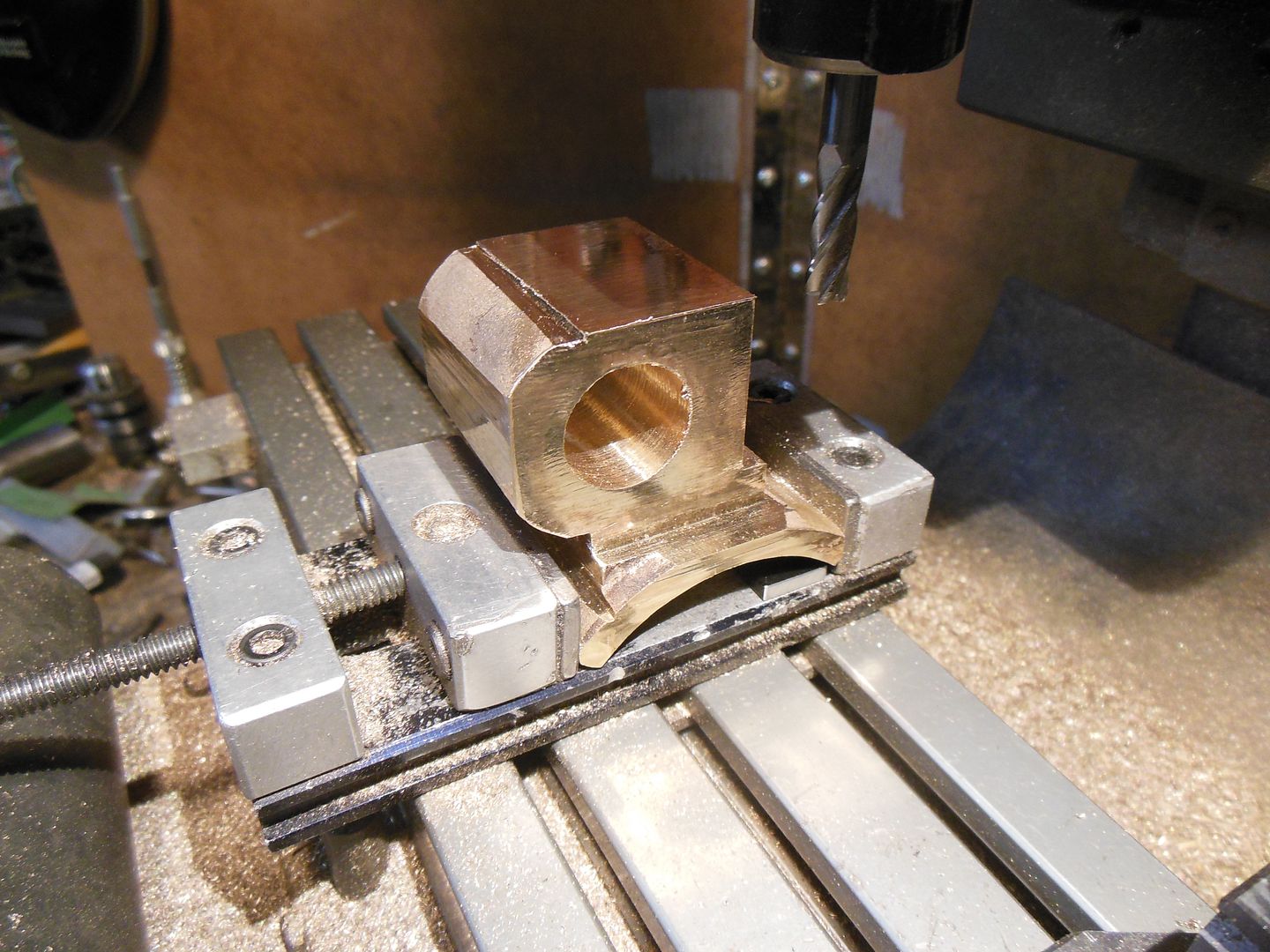

a couple more steam passages
http://i235.photobucket.com/albums/ee257/240283/DSCN4806_zpssbporwsm.jpgMinnie TE Long term project
Brought the outside of the saddle almost to size with some free-hand dial twiddling, cleaned it up afterwards with some filing, then
mounted it on a mandrel on the dividing head to bring the curved portion of the cylinder down to size
http://i235.photobucket.com/albums/ee257/240283/DSCN4845_zpsjypl8u7l.jpgMinnie TE Long term project
a little cleaning up, and here we are
http://i235.photobucket.com/albums/ee257/240283/DSCN4846_zpsrp4ad9ug.jpgMinnie TE Long term project
So far so good, just have to make and install the liner for the cylinder, and then a bunch of studs for various bits that get attached....
Joe

Got the liner done,
Turned and bored:
http://i235.photobucket.com/albums/ee257/240283/DSCN4850_zpssy8hak68.jpgMinnie TE Long term project
Sawed it off the parent stock, and soldered it into place

milled the ends down to final size, and then drilled the steam passages, used a centre-cutting end mill to start the holes, then followed up
with the drill
http://i235.photobucket.com/albums/ee257/240283/DSCN4853_zpsmxcis0jm.jpgMinnie TE Long term project
