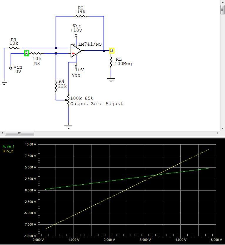

Here's a circuit and simulated data, which is pretty much what I'm looking for.  The LM741 doesn't output full rail to rail voltage, hence the approx. +/-7.5 V output.
However, when I tried this in actual hardware the results didn't come close to the simulation.  <sigh>
If this were to work, it should only require 1 PWM output pin, plus the discrete resistors and small IC.  I'm not sure why it doesn't work though.

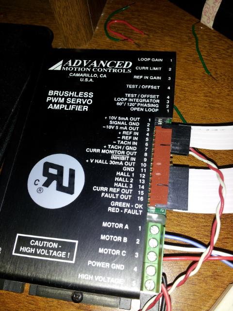

You were going in the right direction, Dave.  It's for controlling a BLDC Servo drive that wants a control signal in the range of +/- 10V.  It supplies a low current reference +10V and -10V that I think I could leverage but need the glue between that, the microcontroller, and the input.
The attached picture shows what's required and available from the servo drive.

have you got any documentation for the BLDC drive?  Based on others I've seen, I would say there's a fighting chance there may be some jumper block / DIL switch / solder-bridge header / header for resistors in there.....
What sort of response rate & accuracy are you looking for?
Re: HELP: +/- Variable Voltage from uC
« Reply #9 on: February 23, 2013, 07:08:43 PM »
I have some documentation for a slightly different model.  It mentions fine tuning with discrete components, but not changing the input voltage signal.  I've opened the case and also found no indications that the makers intended to have this changed.

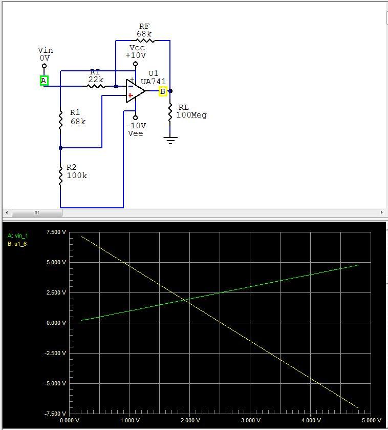

I've simulated a non-inverting version of the op-amp circuit (yes, I've been hard at this all day now...) and it looks promising.  I'm going to reconfigure the hardware and see if it works any better.

For the record, this is what I came up with today (attached).  It seems to work well and I'm well on the way to implementing a PID control loop.  You might see a project that uses these in the near future.
Thanks for all of the advice and suggestions.  If anyone has a simpler idea that uses less components, speak up. :)

The thing is that you say you are using a PWM output which is not a 0 to 5v signal it is a 0 or 5v signal with the duty cycle of on-off changing, so the output would be a -10 to +10 PWM following(or maybe inverted) the input unless the incoming PWM is greatly smoothed and filtered to provide an average voltage output.

Thanks for pointing out this very important fact, Steve.  Yes, I am indeed using an RC filter on the amplifier's input.  I tried first to see how well it would work without the filter, but the motor was not running smoothly.
