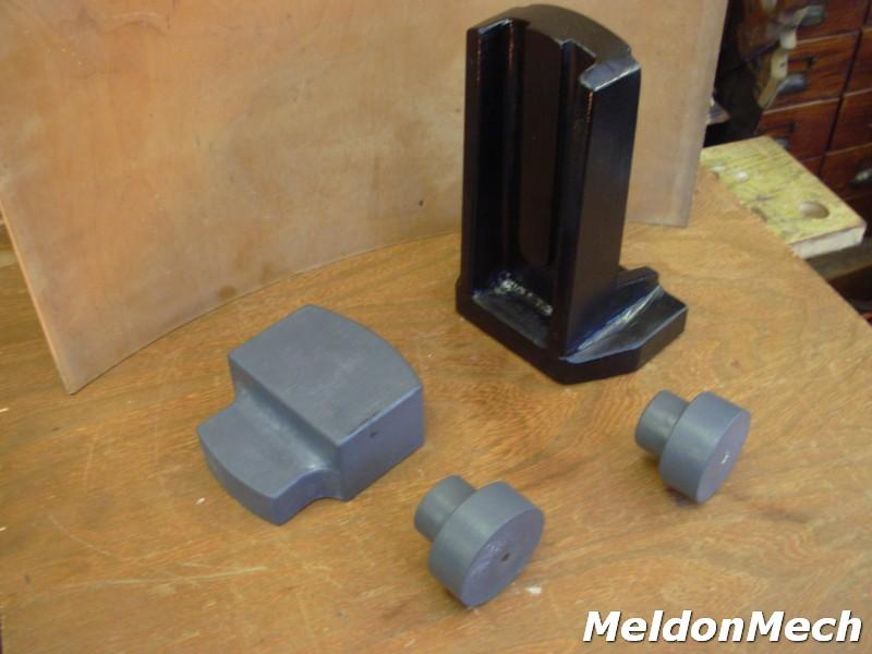

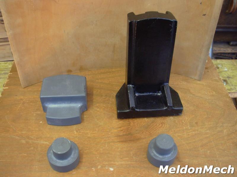

               Just completed the patterns for the tailstock, I found the main column quite tricky, and it took me much longer than I expected. This is the most complex pattern that I have made, so it is fingers crossed. Hope it is worth the effort.

Great work David, is it aluminium or cast iron?

Hi John, I will be making the castings from aluminium.

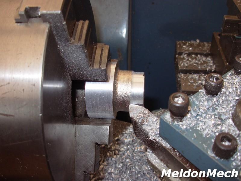

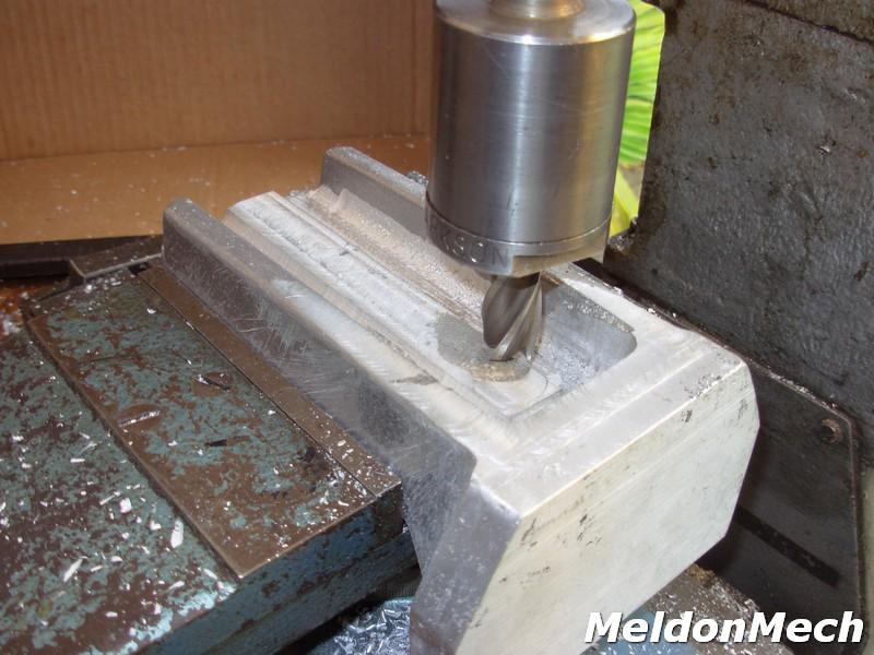

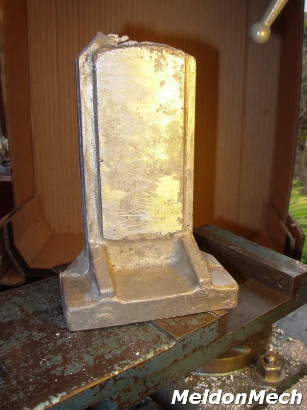

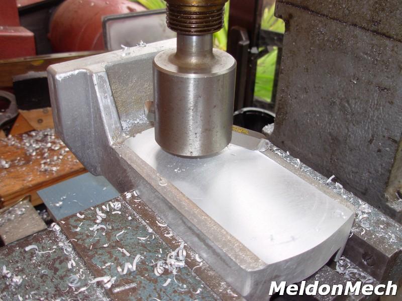

Managed to sort and re size some pics last night. All the castings turned out well. Pics show machining of the Column.

Re: Adjustable Tailstock for a 6inch Rotary Table
« Reply #6 on: January 26, 2013, 05:44:22 AM »
Bloody hell you cast that quick  :lol: :lol: :lol:
Looks a good solid casting  :thumbup:

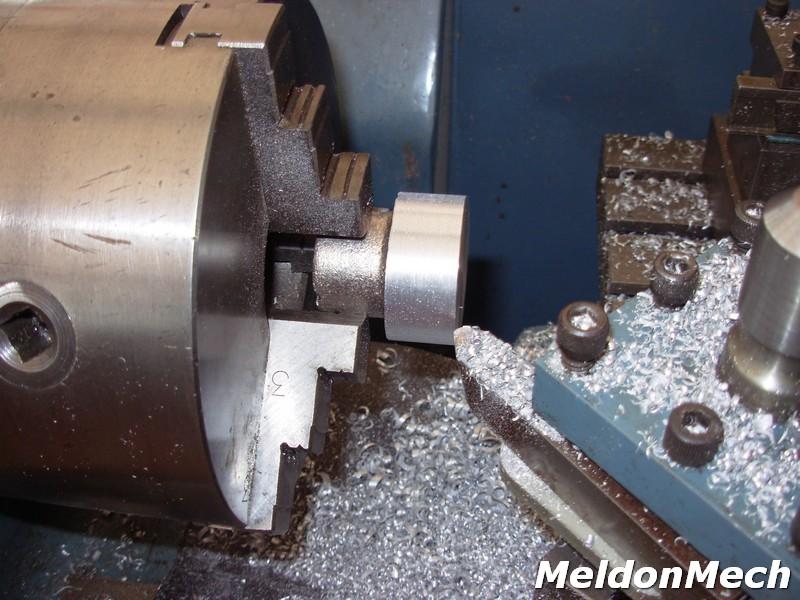

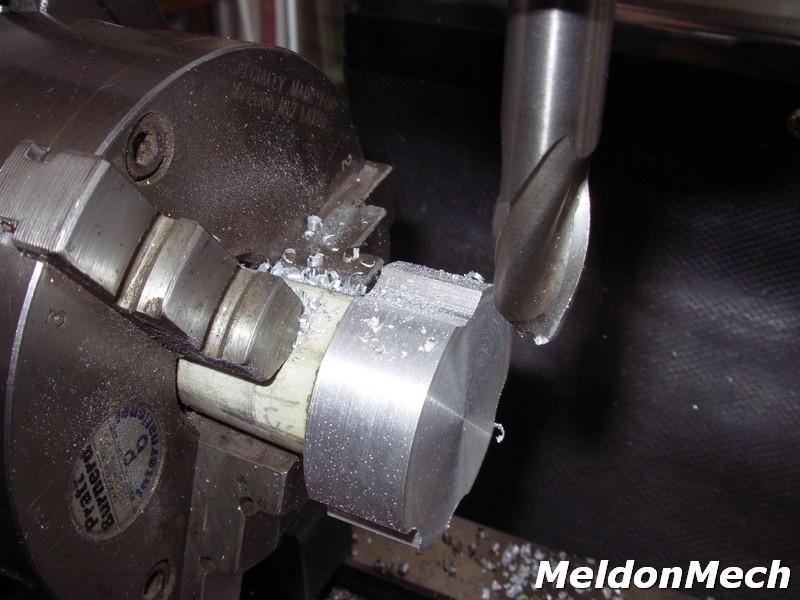

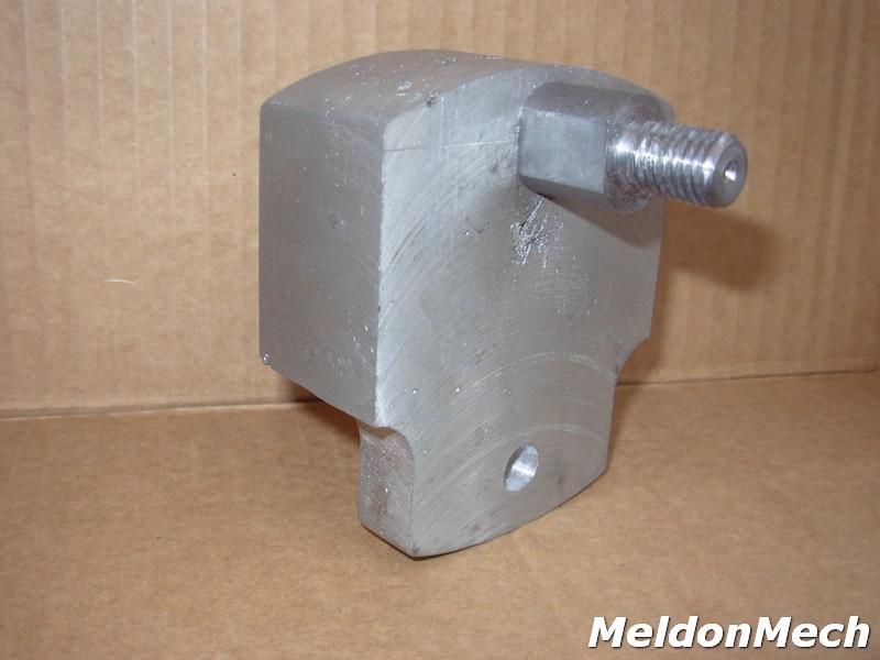

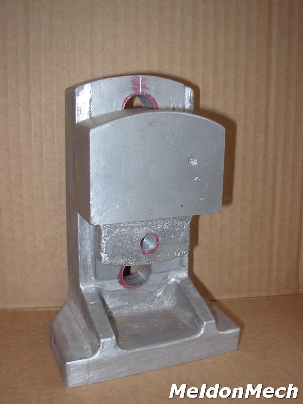

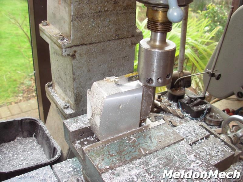

Machining the Adjustable Head using a flycutter
Drill & tap head for sliding nut
Milling flats on sliding nut
Finish threading the sliding nut
Fitting the nut to the head
The head fitted to the column
                                    All for now  David

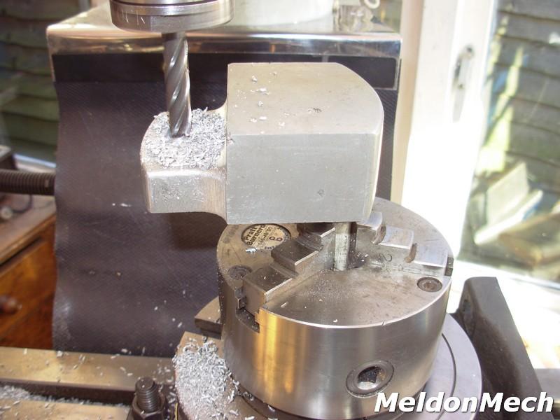

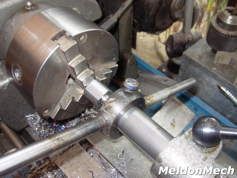

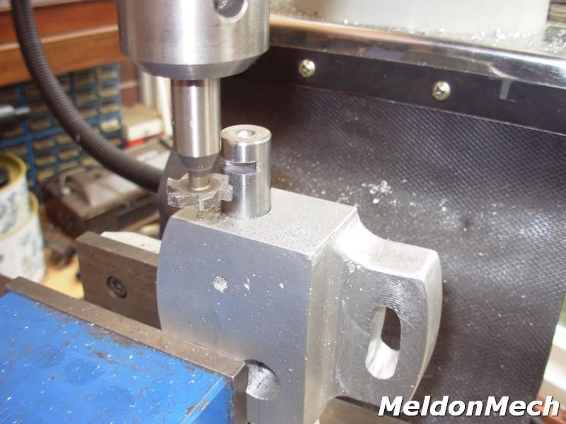

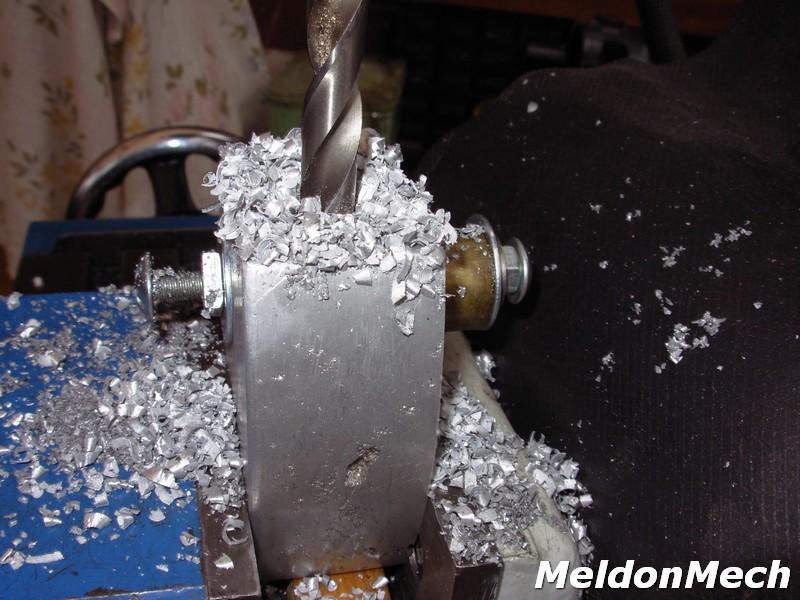

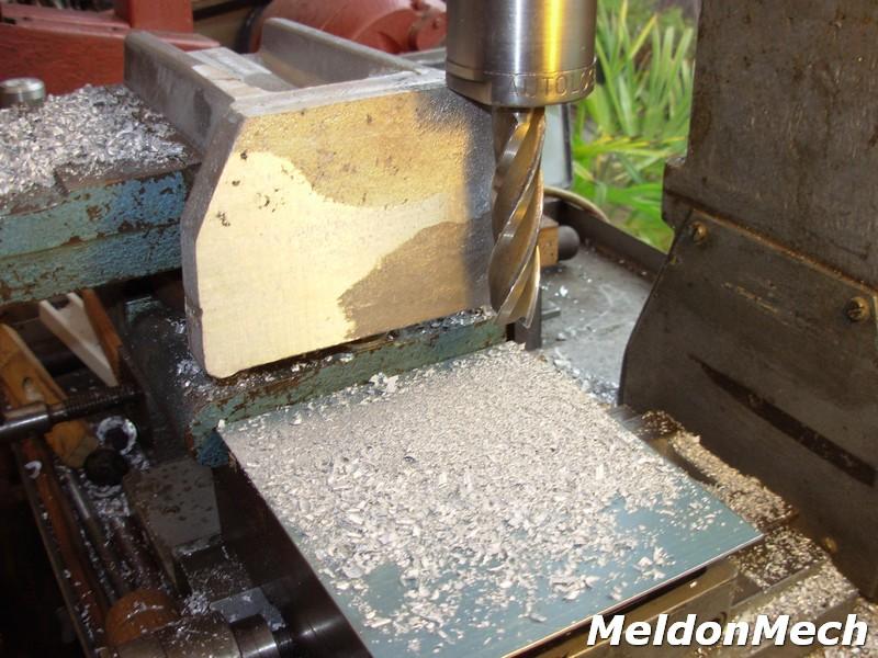

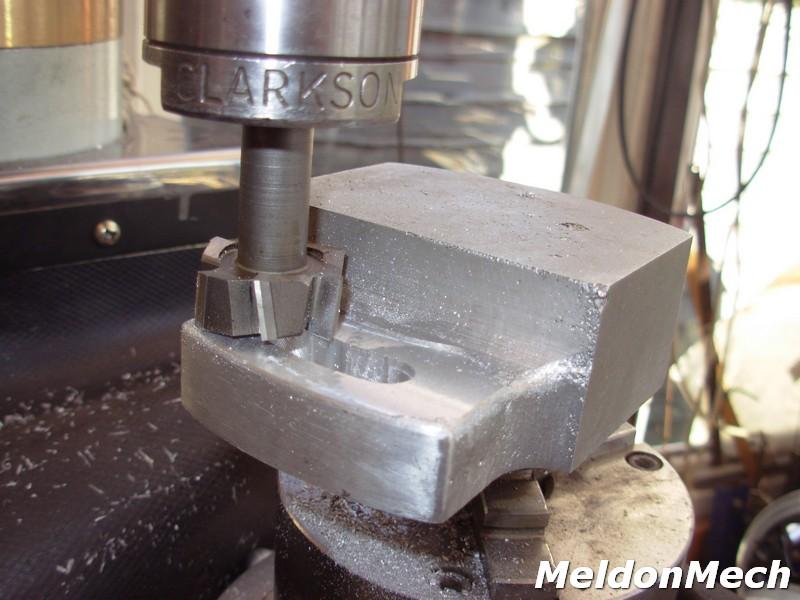

« Reply #12 on: January 29, 2013, 10:34:07 AM »

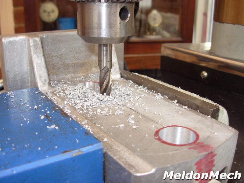

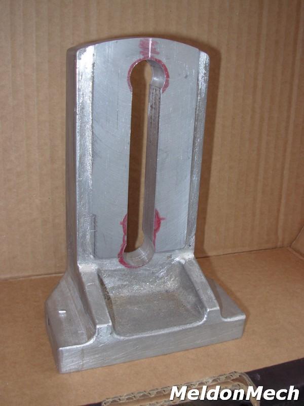

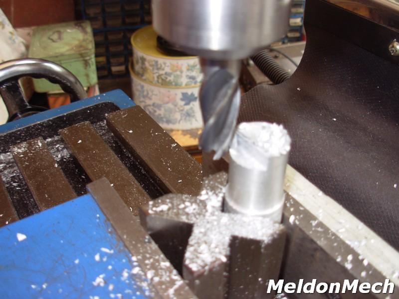

     Pic.1.  Milling radial slot in head
     Pic.2.  Milling spot face

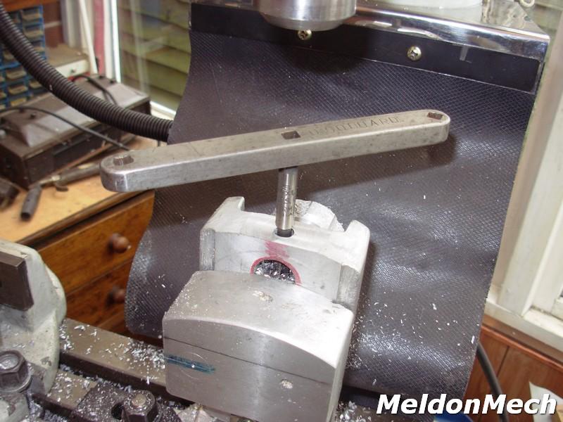

     Pic.3.  Drilling Column and Sliding Nut in line, prior to tapping nut.
     All for now     David

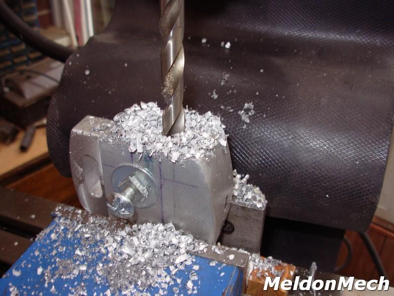

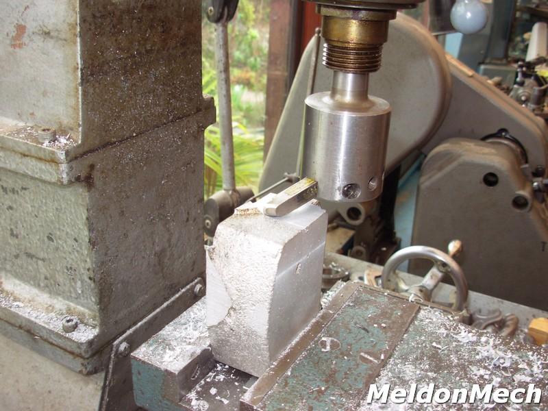

« Reply #13 on: January 30, 2013, 04:35:30 AM »

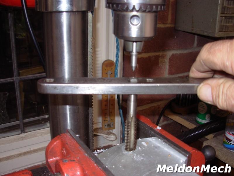

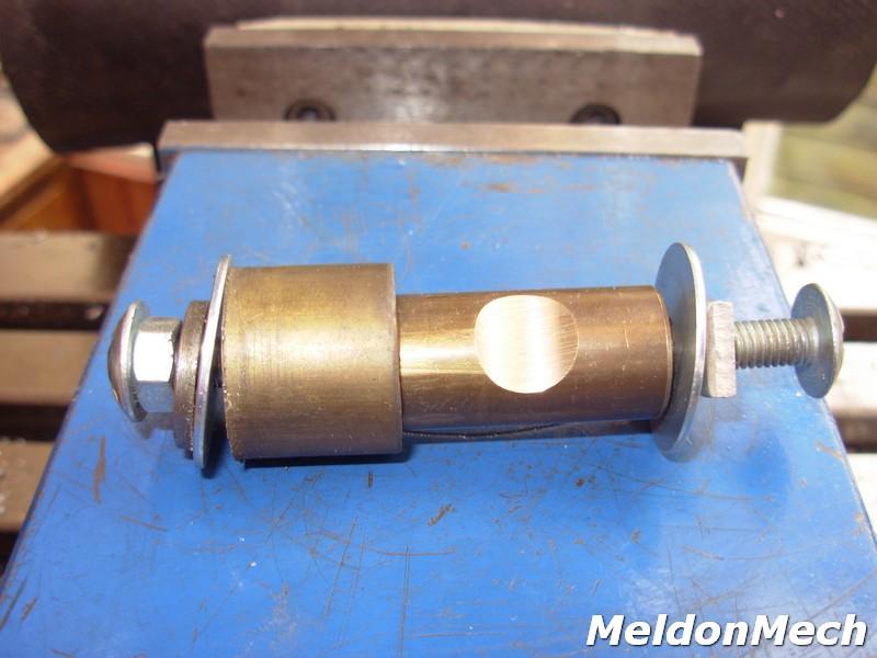

  Machining the Adjustment Handles    Pic 1  >  3
  Tapping the Sliding Nut  Pic  4
  Cotter clamped in Head  for cross drilling  Pic 5 & 6
  Cotter after cross drilling Pic 7
  Milling the D piece
                                                           David

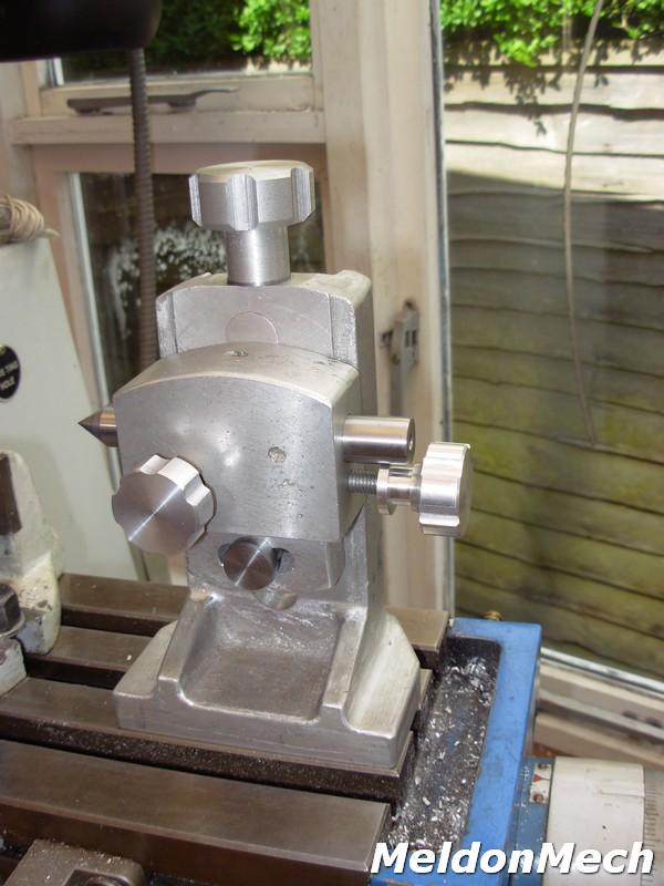

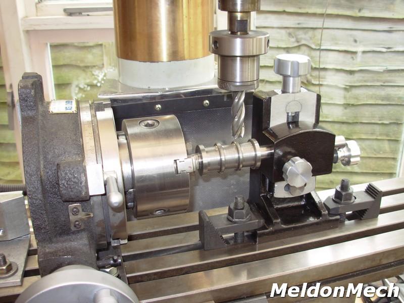

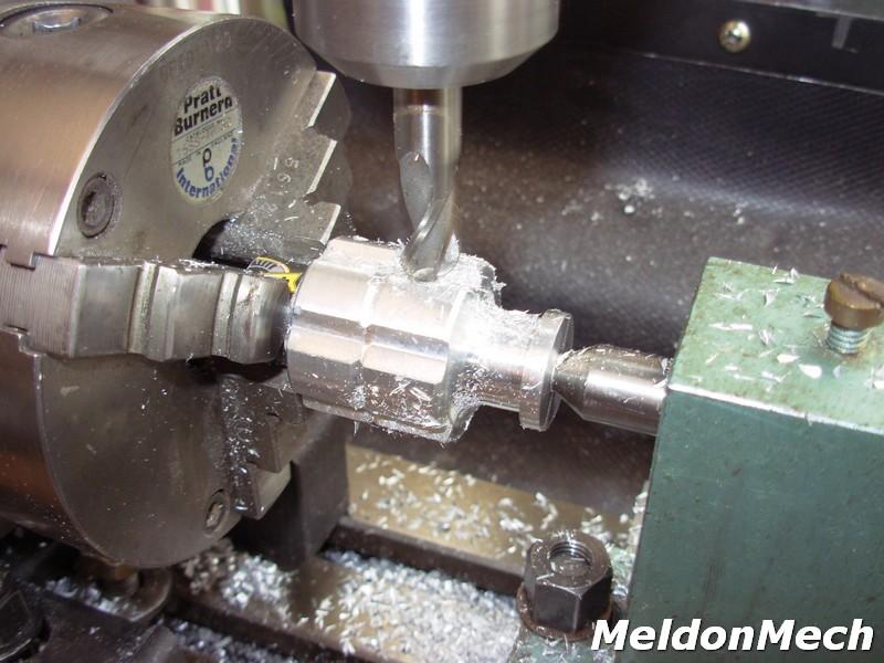

« Reply #16 on: February 02, 2013, 11:28:32 AM »

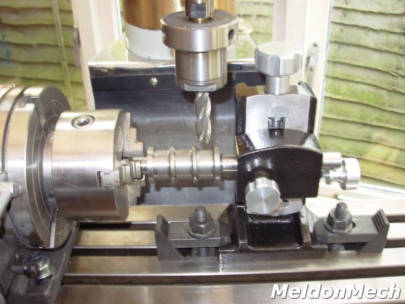

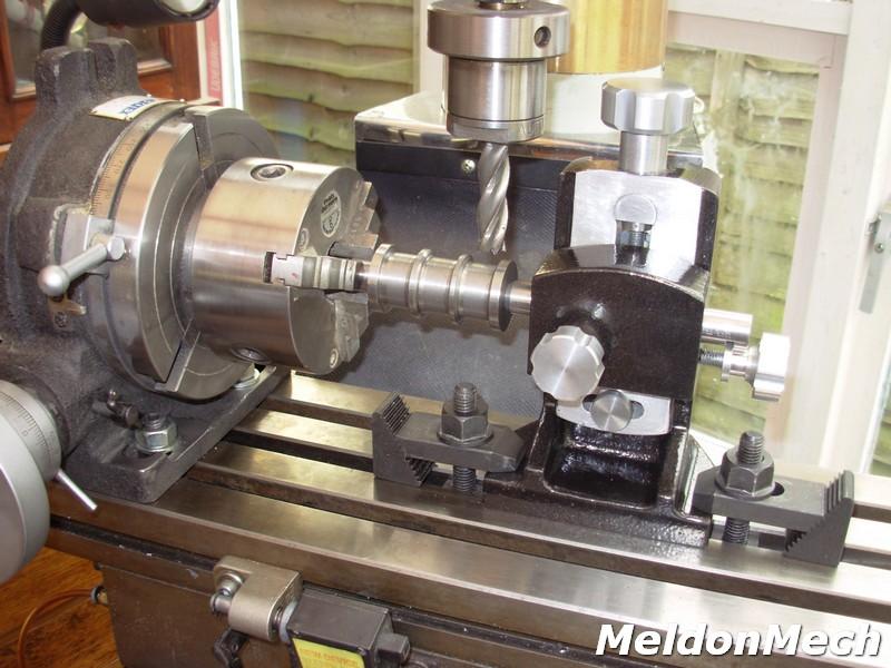

Hi Guys,
                Pic.1. Center Adjusting Handle
                Pic.2. Cutting groove in Center
                Pic.3. Tailstock assembled
                Pic.4, 5, 6. Tailstock and RT, ready to machine a flat on an engine cylinder.
                                   Well guys posting this build has been just as difficult as the pattern making, casting, and machining.
                          Wouldn't want to be a publisher, back in the workshop tomorrow, great.         Cheers David
