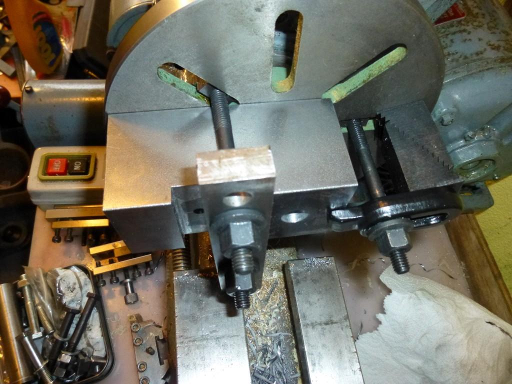

« Reply #3 on: December 23, 2012, 10:25:17 AM »
Ok - i'm new to this faceplate lark.
Never ever used one.....
Is this the way to do it ?
Material is 2" X 2" X 108mm Steel.
It's WAY of center as you can see.
Time to pull in the Back Gear (Also never used by me)  and keep things VERY slow.
The task is to complete the Hole (14mm Drill)> that's the easier bit....
Then to open the 14mm Hole to 28 mm X 35mm deep then 44 mm x 18 deep.
The real fun bit will be turning it around to do the other side and keep it all lined up.
I'll work that out when I get there....

« Reply #4 on: December 23, 2012, 11:11:12 AM »
OK - That is entirely to scary.
It will probably work - but just no .....
Sensible idea.
Put Boring head in Lathe Chuck and hold the work on the milling slide.
A much better idea I think...

« Reply #5 on: December 23, 2012, 11:19:32 AM »
You need to balance that setup - seems well out of balance. Bolt counterweights opposite the big chunky thing.
