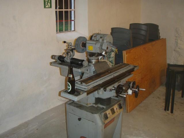

What you really need is a Astra AR-5 Elite or Gema  :D (Sorry! I just love to show my little beauty!  :D)
In my opinion you should go for the Worden Mk3, I have looked at it several times and it seems like a nice little grinding setup, suitable for most needs.
However! If you have the time and want to, go for the Quorn!Such a nice project!
Just my few words! Good luck!  :beer:
