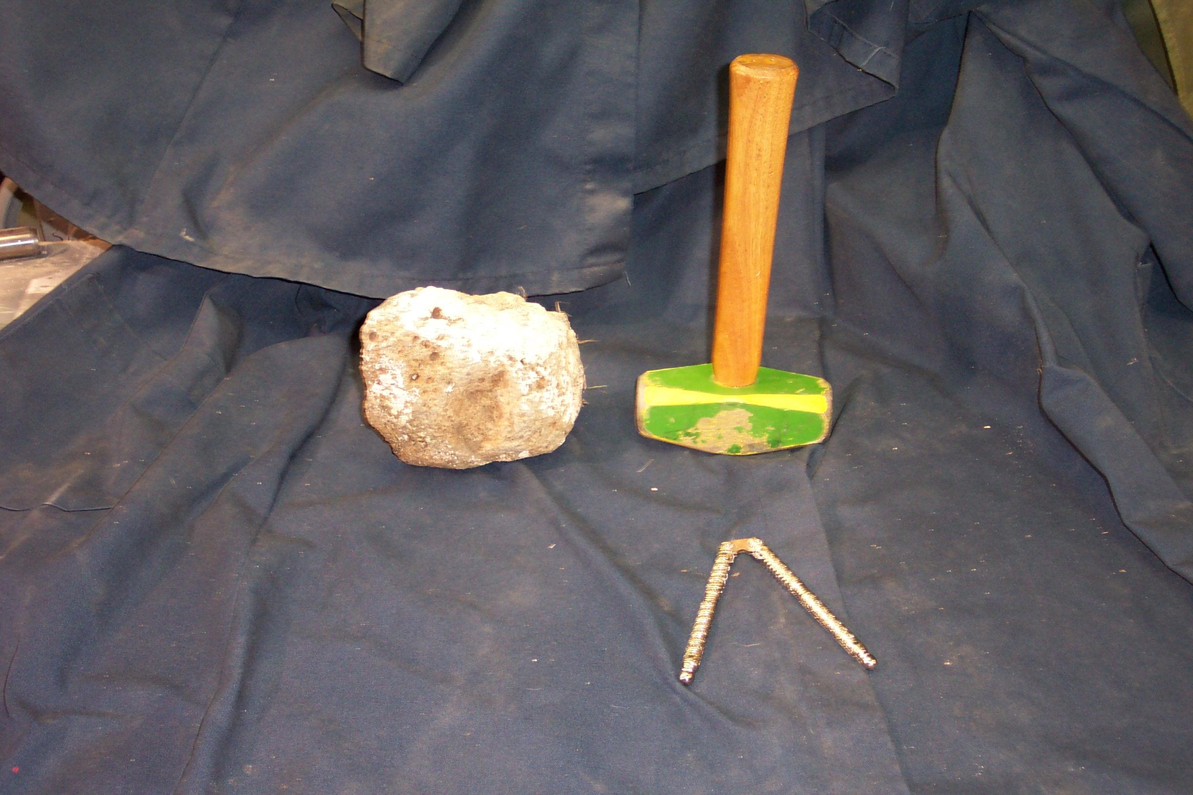

Time flies by and man develops better and better tools for the job.  Moving from rocks to clubs, from clubs to hammers to finally a levered device actually called a nut cracker.  (Fig. 1)  Cleaver people these nut eaters.  Each improvement showed its merits and faults.  Thumb and finger damage was one problem early on.  Moving to the levered implement it pretty much removed the smash quotient from the equation. But to some of us aging mechanics arthritis has snuck into our joints and the squeeze motion causes irritation and pain.  Another levered device was invented, by the Russians I am told, and is quite evident during the holiday season.  So revered and celebrated this device has had entire ballets created for it.  The Russian nutcracker resembles a toy of some type or at least a Czar’s Guard dressed in his finest.  There are two major problems associated with this item, 1) it does not really work that well and, 2) it is ugly and scary.  I have been known to awaken from a deep sleep by having one of these creatures chase me while his jaw is mechanically chomping up and down attempting to chew my leg off.  Not a pleasant sight to a six year old, or a sixty-two year old.  I have always carried a deep seated revulsion for the Nutcracker.  May he pass to history in devastating, wretched, twisting, torment.
Well if you have made it this far, you must be really bored with a whole lot of time on your hands.  The

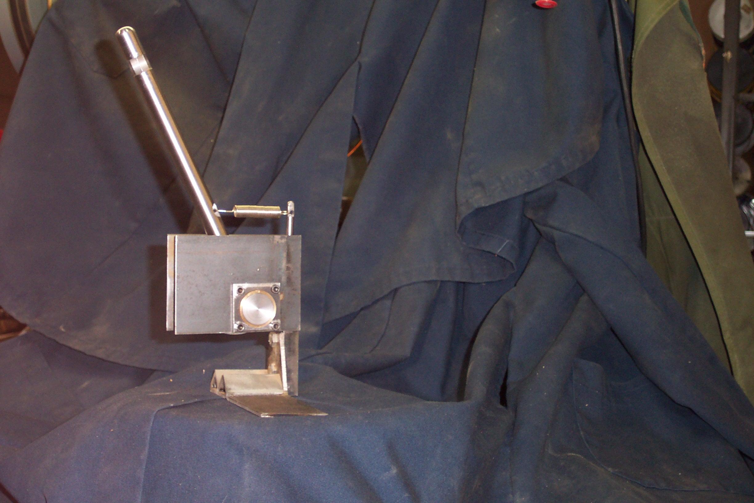

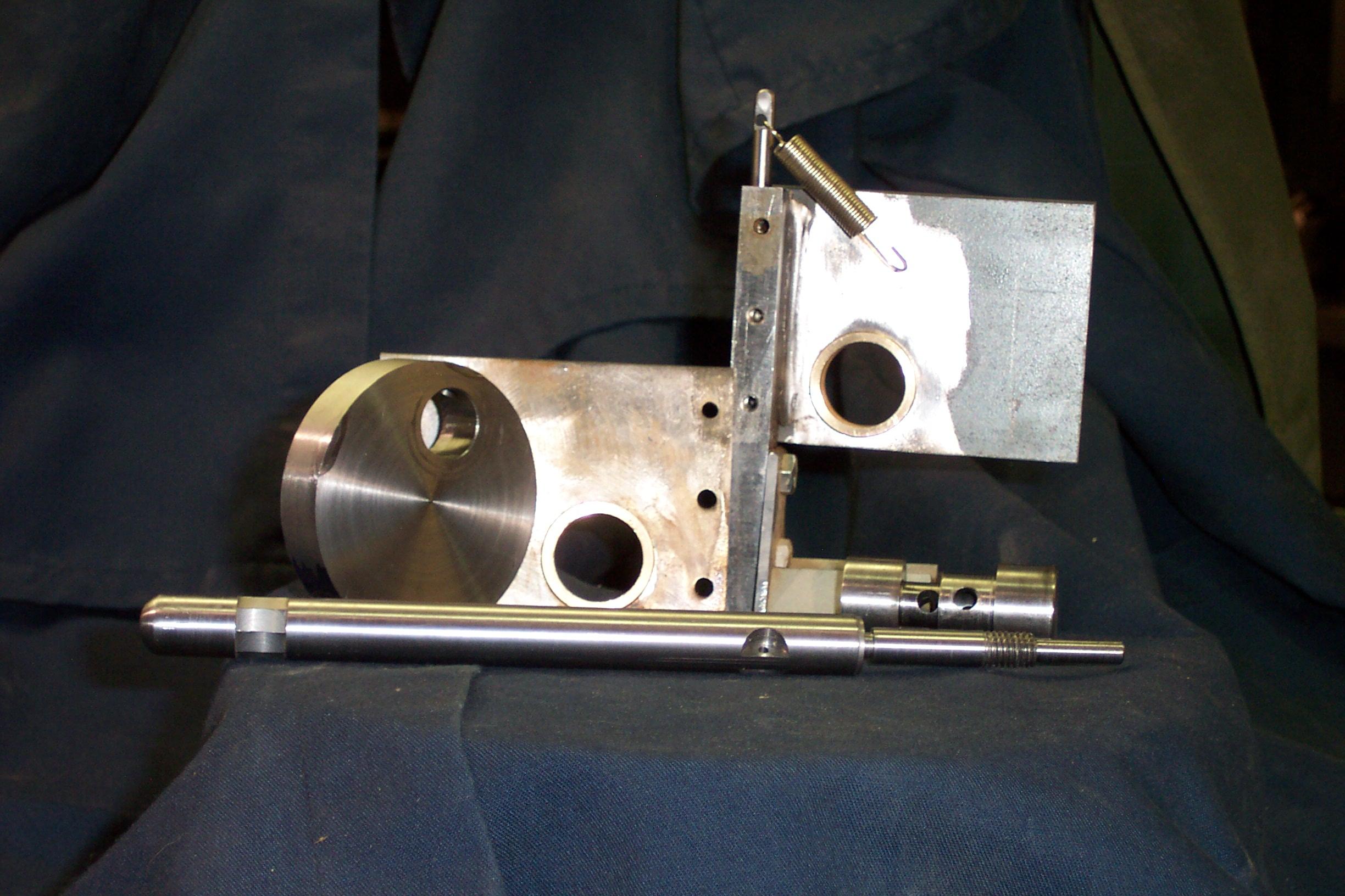

following two pictures pretty much show the entire device as I devised it.  One unassembled and the other assembled.  Figures 2) and 3).  I must apologize for one thing in my picture of the progression of nut cracking tools. Figure 1).  Even after perusing my wife’s ample collection of all things near and dear after forty two years of marriage I was not able to locate a mastodon foot.  The foot is self-evident by its omission in the picture.  So imagine the foot and going in a clock wise direction, start with the rock.  Not everything is perfect.  Live with it.
Dimensions are rather loose and can be adjusted to fit your scrap pile as mine was, so they are not included.  Except for the worn, chipped, and broken tooling and about one hundred dollars’ worth of electricity to run your machine tools, this project is free!  You can’t say that about many projects!  Don’t ever tell Mama what the electric meter does when your 5hp air compressor starts.  She would not even let you run that dremel if she knew.
I started as John M. Browning often did.  Making oversize templates and drawings to check proportion, fit and angular movement.  Then moving to my goody pile I chose a cutoff of 3” 4140 tool steel.  I felt it would have the necessary abrasion resistance but still have the machinability to stand up to the rigors of use yet obtain a finish pleasant to the eye.  If after some use, excessive wear is noticed on the contact friction edge, heat treatment is a possibility.  A less costly coating of Kasonite is a possibility or even a build of hard surfacing rod applied by electric arc welding.  Similar to that used on heavy earth moving equipment.  Not as pleasant to the eye but a viable long wearing solution if need be.  A handle from a long broken bullet swaging press was picked thinking if it could swage bullets it should crack walnuts without too much trouble or excessive bending.  At times like this I surely do wish I had more formal training in our craft to be able to calculate the “TRUE” crush force of a walnut.  Another of life’s mysteries.
Now for the hidden secret.  The pivots and super-secret holding method mating these pieces with no fasteners!  One inch cold rolled was chosen not for its heft but for the simple fact that my only remaining bronze bearing material was in that size range.  I must admit though, that having those hefty hubs protruding from the crushing cam sides does look pretty cool.  Isn’t that half the goal in projects such as this?  Knew a girl in high school with hefty hubs!  Oh yeah, the super-secret part.  Look closely on the end of the handle and you will see a straight smooth section, a threaded section, another shouldered section and finally the major diameter of the handle its self.  The long small section enters holes perpendicular to the hubs so they do not escape while installed in the crushing cam and the handle then screws into a short threaded section to secure the whole thing.  Pretty cleaver if I do say so myself.
Back support post is just some ¾” x 1” hot rolled cleaned up a mite with a piece of 1/8” x 3” x 4” flat welded to it.  A matching piece, held by captive allen head cap screws, forms the removable side.  3/16 x 1 ¼” strap metal was picked to beef up the area where the hub bearings were placed.  My first thought was to allow steel on steel contact in this area with grease zirks installed.  But then the possibility of unintended, unauthorized use entered my mind.  If the wrong type of non-food grade grease was used the entire world economy could become imperiled.  What would happen if some person, somewhere, added walnuts contaminated with  petroleum based grease to their refried beans.  The entire pork
futures in Chicago would never be the same.  The move from lard to oil produced lithium grease would be uncontrolled.  Putting still more pressure on the world oil market.  I could not take that chance or even fathom the responsibilities.  Staying with a high quality food grade vegetable grease seemed the only solution.  Also helping to stay within the low fat guidelines printed on the bean can label.  But who to monitor these activities? Just too many loop holes, too many places for mistakes to rear their ugly little heads.  Steel on steel had to go.  Hence, the brass bearings incorporated into the design.  Now my two high speed grandsons will be capable of cracking walnuts at their pace.  Not mine.  Thus requiring less supervision and machinery maintenance.  After bearing inserts were machined for a press fit, and installed, the entire assembly was mounted in the mill.  The bearings were then line bored to ensure perfect alignment with the crushing cam hubs.  Tolerances between bearing and hub were left rather large so excessive thermal expansion from high speed use would not hinder operation.
2” x 2” x 1/8” angle was the beginning of the base, approximately six inches long .  Two pieces of ¾” x ¾” x 1/8” angle form a small bed if sorts to keep the walnut from slipping away during the crushing process.  This bed was blind welded to the base from the bottom.  A long flat was left on the right side as I am not sure where yet the unit will be employed.  Using a “C” clamp, this flat should enable the user to quickly secure it for stable utilization.
The last item is a handle return device that was added at the last moment.  I did not know I needed it until I saw how clumsy the unit was without something to raise and hold the handle while securing another walnut.  While in the spin dex at the mill an octagon was cut in the grip area of the handle to get some flats for an end wrench to bite on so the handle need not be scarred by pliers while tightening.
I know you all say, isn’t that what a proto type is for?  To find mistakes and omissions or just to show the smart aleck inventor he is not so cleaver after all.  Come on, you got to give me one don’t you?  A simple return spring was mounted and one of the green principles was endorsed.  I reused, correct that for the hopeless, repurposed, a spring from a recessed light fixture trim to hold the handle in the upright position.
Paint?  This is one of my admitted down falls.  I hate painting in any and all forms.  Why?  Because I am not good at it.  I am messy, I don’t like to wait for it to dry, I get as much on me as I do the project and the evidence of my finger prints is indeed, evident.  Besides, I rather like bright steel contrasted by layout fluid.  And, I cannot pick a good color besides my favorite, Navy haze gray.  Remember that old saying?  “Haze gray and underway”.  I do, too well.  Another fantastic, super wonderful, impressive project see’s completion.
