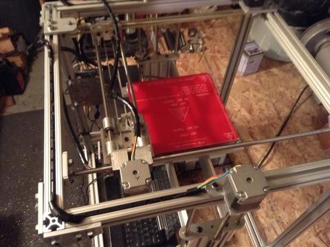

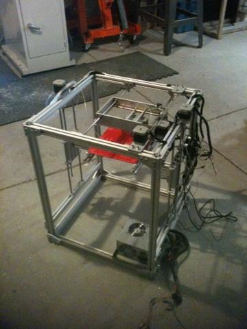

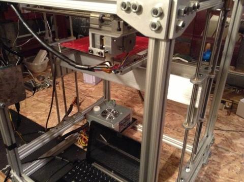

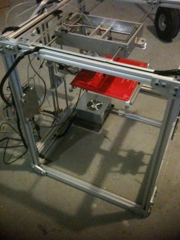

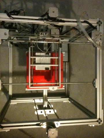

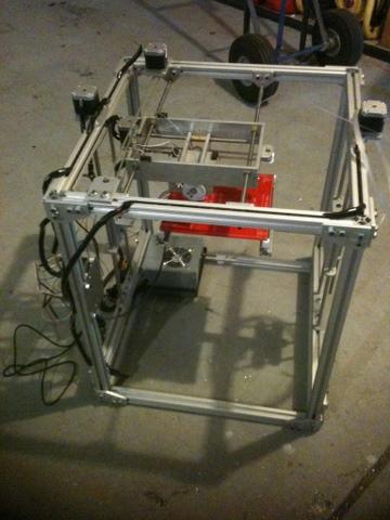

Greetings. I did not wish to appear as though I was co opting Craynerd's thread, so I decided to start my own. I have been building this printer for a few months now. It is composed of a RAMPS 1.4 and running on pronterface. It is 1.5 foot square and is this large because it will eventually be a small recycling/ manufacturing center. At the base opposite the ATX power supply will sit a plastic grinder/ extruder that will make the plastic filament needed from old bottles. It will be similar to the grinder found at www.filabot.com. There will also be a 3D scanner attached that will use the build platform as the scanning platform based on the scanner similar to the concept from www.david-laserscanner.com. It currently runs off a netbook that has the CAD program on it.
Anyway, I do have a question to ask. The Z axes stepper motors are not working correctly. With one attached, it will run fairly well, but after a while it starts to stutter. With 2 Z axes steppers attached, they generally won't rotate at all, or at the most one or to rotations and then stop. The only way to fix it is to turn off the power supply and unplug the Arduino, then plug it all back in. Based on a suggestion by jgroom, I turned my attention to the stepper drivers. The y axes is so hot that I can't touch it, but the others are fine. I was wondering how to adjust the potentiometers, and if being out of wack would cause the excess heat and bad rotations?
Sorry for being so long winded!

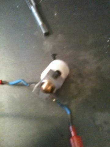

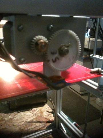

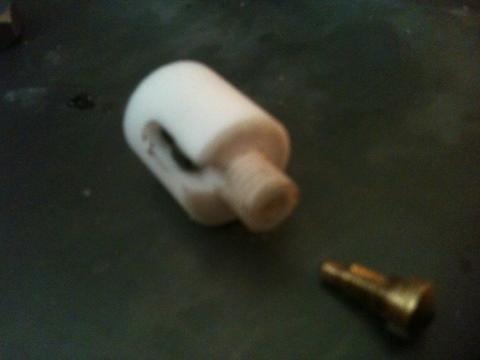

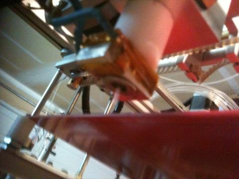

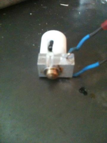

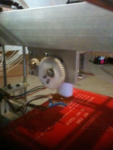

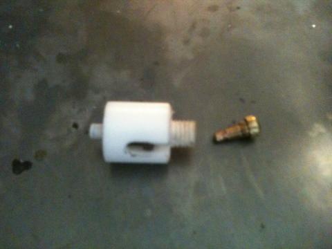

All the electronics are working great but now I am having an unusual problem. As the extruder runs, the nozzle is slowly pushed out. I am wondering if any one has any advise on the best way to stop this. The hot end is my take based on other peoples designs. The standoff/ thermal shield is 1 piece of round teflon with a 1.75 mm hole drilled through. The heater block is threaded to the outside, and the nozzle is threaded inside the teflon, with a washer used to transfer heat from the block to the nozzle. It works great as far as the heat transfer is concerned, and the threading on either side of the teflon was meant to put pressure on it to keep it from slipping, but somehow I need to lock the nozzle in place.
Offline Monkey with a mill
  • Posts: 9
Re: Another 3D printer
« Reply #9 on: August 09, 2012, 02:27:07 PM »
I found a way to stop the nozzle from rotating out. By drilling a hole perpendicular in the heater block and through the teflon, then tapping the hole, I was able to use an 8/32 socket headed bolt as a friction hold. Here are some pictures, sorry for the quality, I took them with my phone. It is holding well. The problem now is that the plastic that is being printed is not sticking to the platform, but rather balling up and sticking to the side of the nozzle. Any suggestions on how to solve this ?

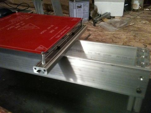

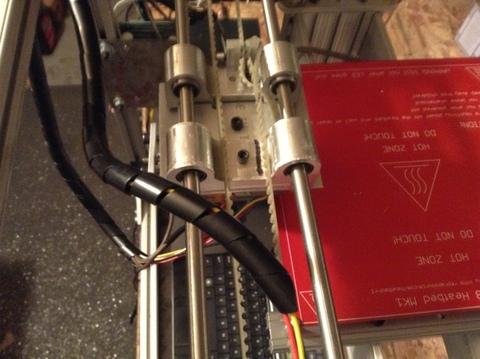

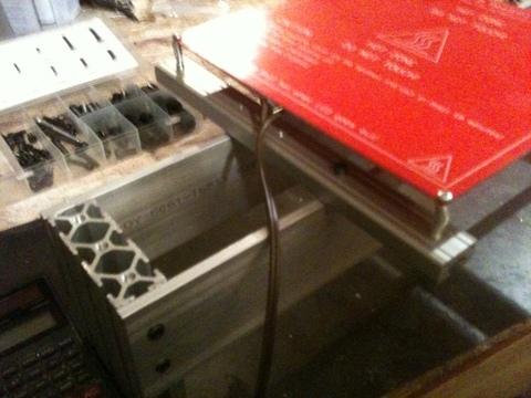

« Reply #10 on: February 03, 2013, 10:19:40 AM »
I have not abandoned this project, I simple move at the speed of smell. The X and Y axis have been completely redesigned. Bushings were replaced with roller bearings. The platform support is now rock solid and the extruder has been strengthened with stainless steel bolts. Its been printing mustache rings nicely.
