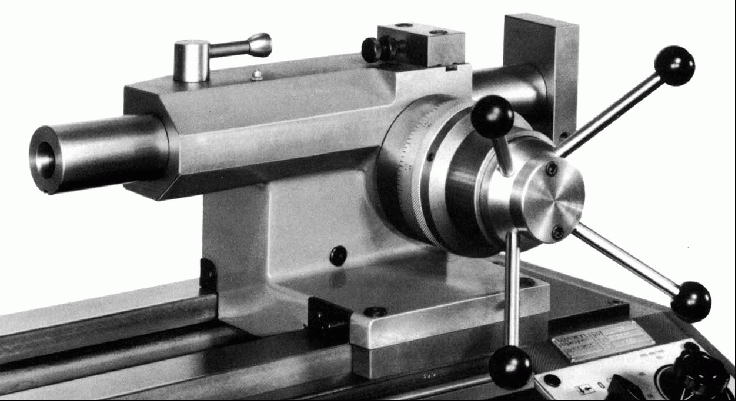

I have been thinking of a way to be able to switch between the ordinary tailstock screw feed and a new tailstock rack feed. I also think I have found a suitable solution. After further searching I have also found that there seems to be three main positions used for the "star wheel":
   1 - Vertical, in front of the user (Schaublin f ex) (counter-clockwise rotation)
   2 - 45 degrees up, (Radford, Stepperhead f ex) (counter-clockwise rotation)
   3 - horizontal, on top of the tailstock (Myford and Michael Rhodes for the Unimat)
        (clockwise rotation)
All three are most probably equally good so my question would be: Is any of the three to prefer before the others ????????????

Re: Tailstock rack handle position?
« Reply #7 on: August 02, 2012, 07:05:03 PM »
Getting back to the ergonomics, Peter, I think that the three diagrams you showed point the way. Taking drilling a hole as an example, in A it would be natural to grasp the handle which is nearest to you and move it CW it towards the headstock to apply pressure on the drill bit.
In C, it would be equally natural to grab the topmost handle and move it CCW.
B is the problem situation, where you might need to think things out.
Personally, I would go for A, because there is very little chance of the arms fouling anything as you turn them. Even better would be half-way between A and B, so that the arm nearest to you was more or less horizontal.

« Reply #8 on: August 03, 2012, 12:29:37 PM »
Hi Andy,,
I can only agree with you here. I have come to the same conclusion myself, and I think I want to make a mock-up out of odds and ends just to find the right angle och the gear housing and the angle on the star wheel arms vs the gear housing.
As you say the housing should probably be nearer the A position than half way between A and C, but how much will be decided by the angle of the arms, and with the right combination the star wheel will not foul any other handle either.
I did get some more info = the old Martin Cleeve descriptions and found some useful info there as well. He had decided to skew the star wheel axle to be in a horizontal position but turned about 20 degrees outwards to the right thus turning it away from the bed handle and such.
Still working out the boundaries and types of items, and then I willb e back with more.

These Shaublin guys are nothing if not inventive...
http://www.lathes.co.uk/schaublin/page23.html

« Reply #15 on: January 08, 2014, 09:59:47 AM »
Yes, its extremely funky. Seems to incorporate depth stops and the option for lever arm / sensitive drilling attachment.
In fact its so funky I find the idea of making one quite daunting...
