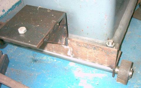

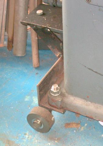

Hello Mick
The following pics I took back in 06 and posted on the Harrison Group of Yahoo.
It was a simple and quick method I use on all my heavy equipment. (surface grinder, Mill, excetera ).
The wheels are cut from solid bar, suitable angle iron bolted to the base of the machine to hold the wheel axils.
The lifting angle has a lose bolt in the middle to stop any chance of slipping from a trolly jack.
The jack being the steering at either end thus allowing the machine to be moved sideways.
Once the machine is in place I use packing to level the machine and sit it down firm, the wheels are then left hanging.
I will take more photos showing the machine close to a wall and tucked in tight next post.

Hi Trev, thanks for posting the photos, looks like you have found simple but effective way to do the job  :thumbup: :clap: I like the trolly jack idea for the steering, keeps things simple.............. I might just be doing the wheel style L5 I think  :beer:
   Cheers Mick.
