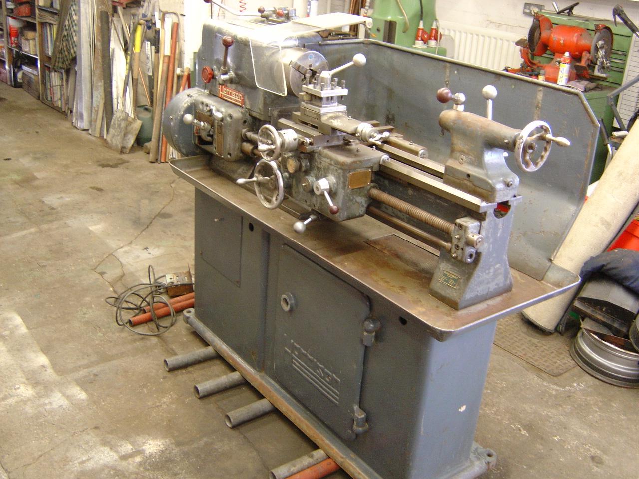

Harrison L5 rescue
« on: July 08, 2012, 06:26:57 AM »
 Good morning all , I am totally new to posting so not sure if what you are seeing is what you are meant to be seeing :scratch:. This is the state of my Harrsion L5 1959 lathe when I rescued it from a damp old shed, I have had it a few years and its been cleaned up and used a bit but still scruffy so the plan is to now give it a good going over to get it half decent. More recent photos to follow if this post works ok.
  Cheers Mick

« Reply #1 on: July 08, 2012, 06:34:08 AM »
Hi Mick,
Looks like you have this ere posting pics OK.  :clap:  :clap:  :clap:
A fue of your workshop would be good, I'll am green with envy as my shop is still in my head ( and some would say there is plenty of room for it!) :lol:  :lol:  :lol:

« Reply #3 on: July 08, 2012, 10:02:40 AM »

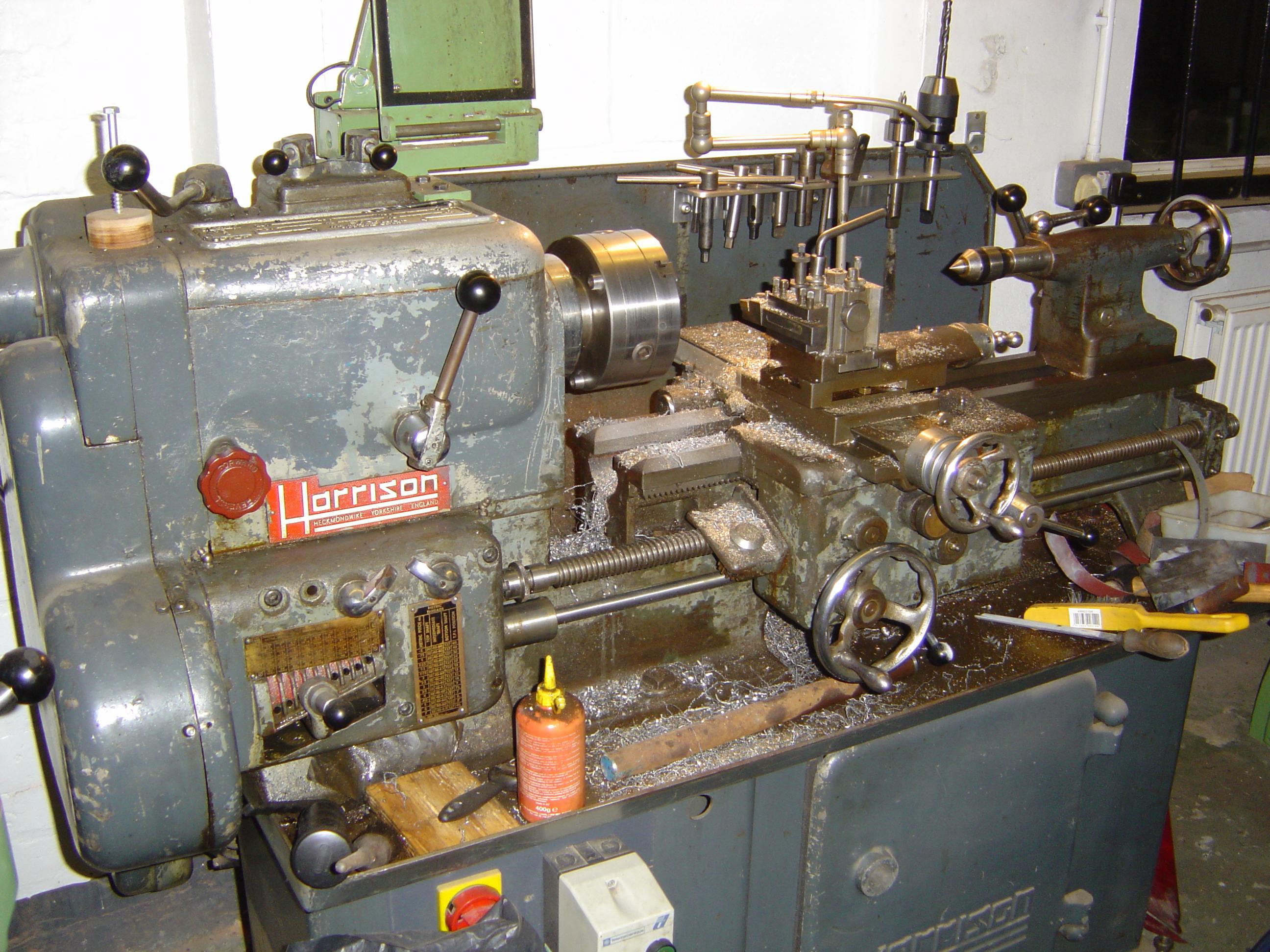

Hi Mick  :thumbup:
The lathe is looking good , have you used it much ?  whats it like ?   , its just i have my eye on an L5  :dremel:

« Reply #4 on: July 08, 2012, 10:36:02 AM »
Mick
You have made a great job of cleaning up that lathe :clap: :clap:
It looks to be in good shape under all that grime :drool: :drool: :drool:

« Reply #5 on: July 08, 2012, 02:37:30 PM »

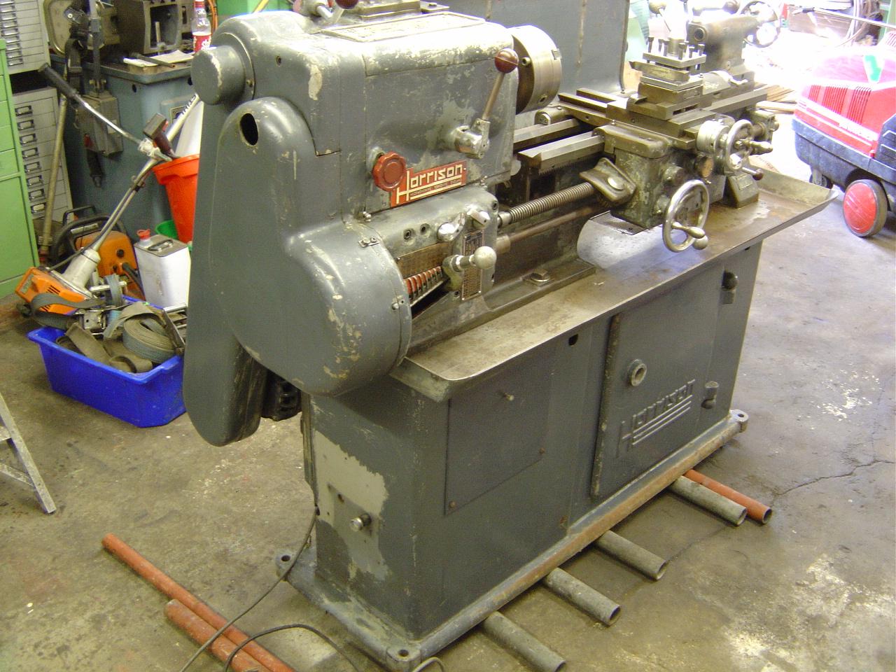

 Its not too bad John, that was phase 1 now it just needs a good go over and paint to get it back to its former glory  :D.
    Thanks for them links Rob , I will check them out and hopefully get into the swing of posting better as I go. I have not used the lathe too much really , well mainly making bits for the lathe , backplates etc and other parts for various stuff, its been fine for everything I have done but I have not done anything too tricky mind. I like the lathe and have only heard good things about Harrisons in general, this one has the screwed spindle but the larger bore 2. 1/4 inch 6 tpi, quite hard to find backplates , faceplates etc for I still need some stuff.  If I had of posted before I took it apart you could have had a go to see what you thought its now in bits as you will see from tonights photos  :bugeye:, my plan is to strip and clean , repair what I can then maybe put back together to try to access how 'true' things are ( something I might need advice with ) then strip back and do what needs done and give it a nice repaint, hopefully ending up with it operating and looking as it was back in its day.

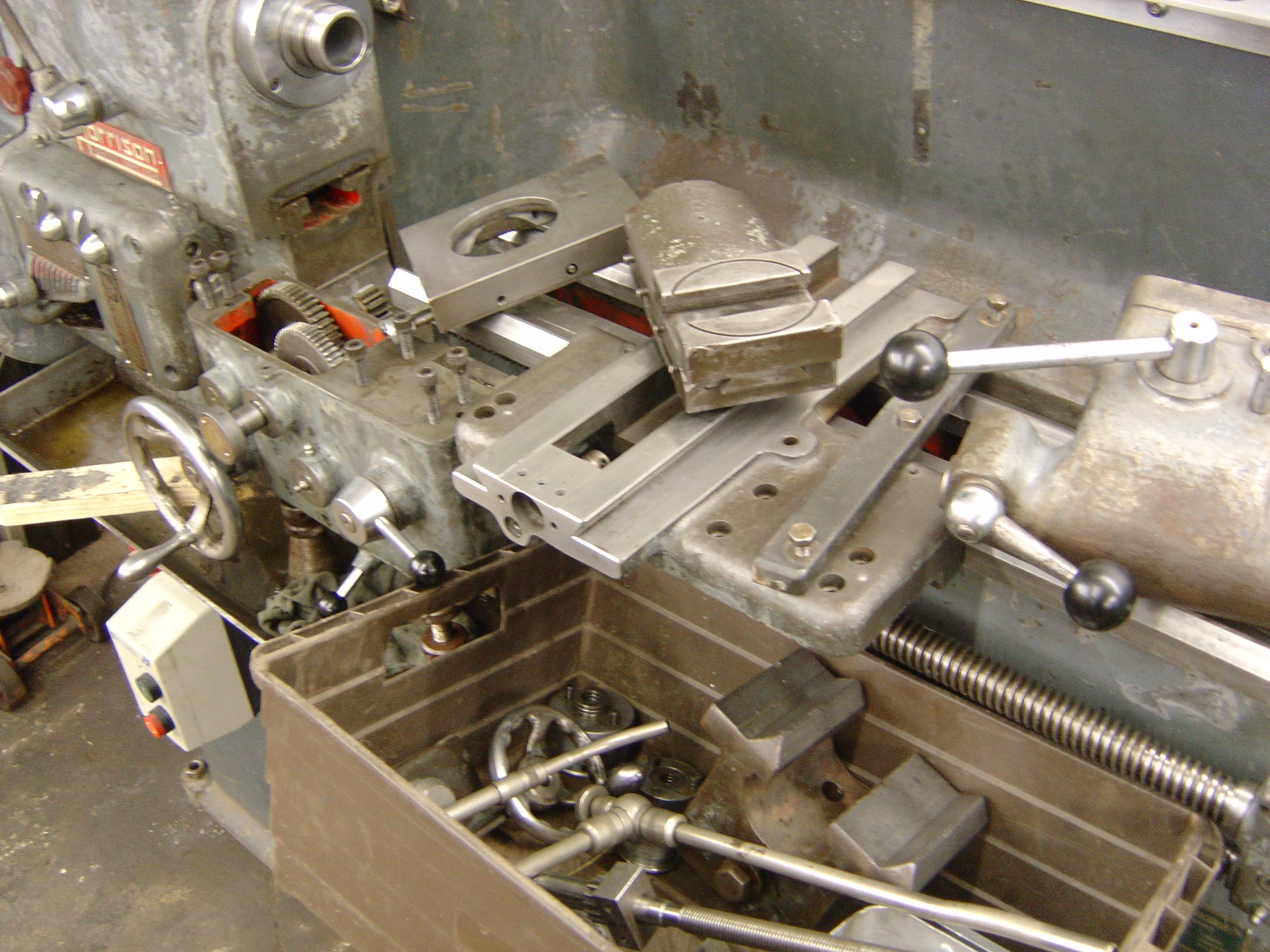

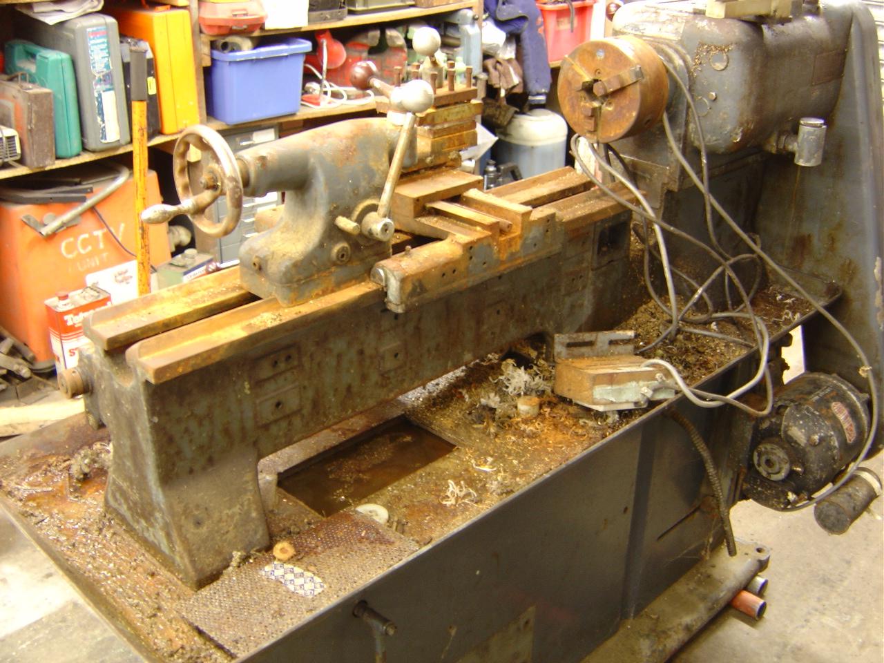

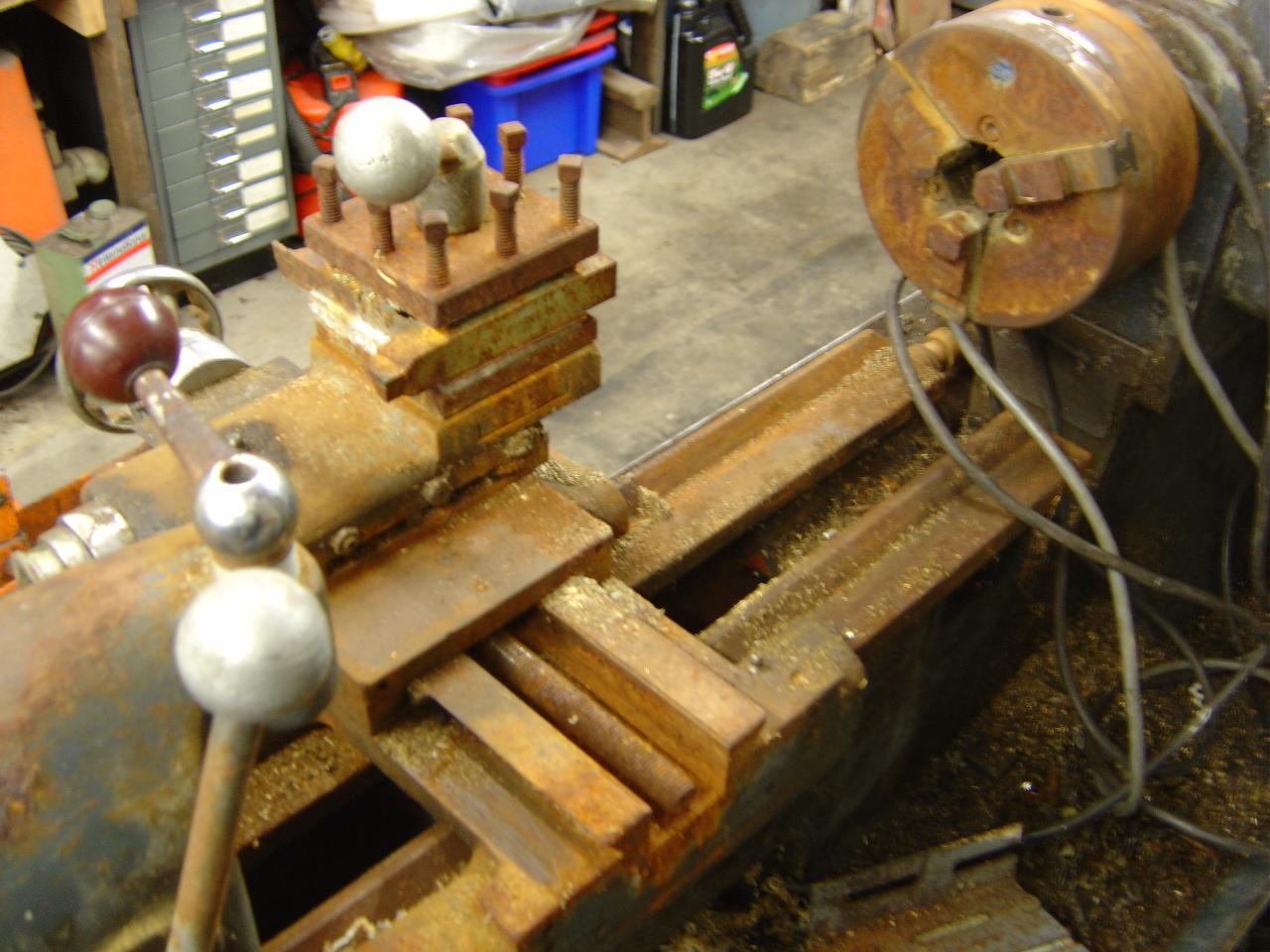

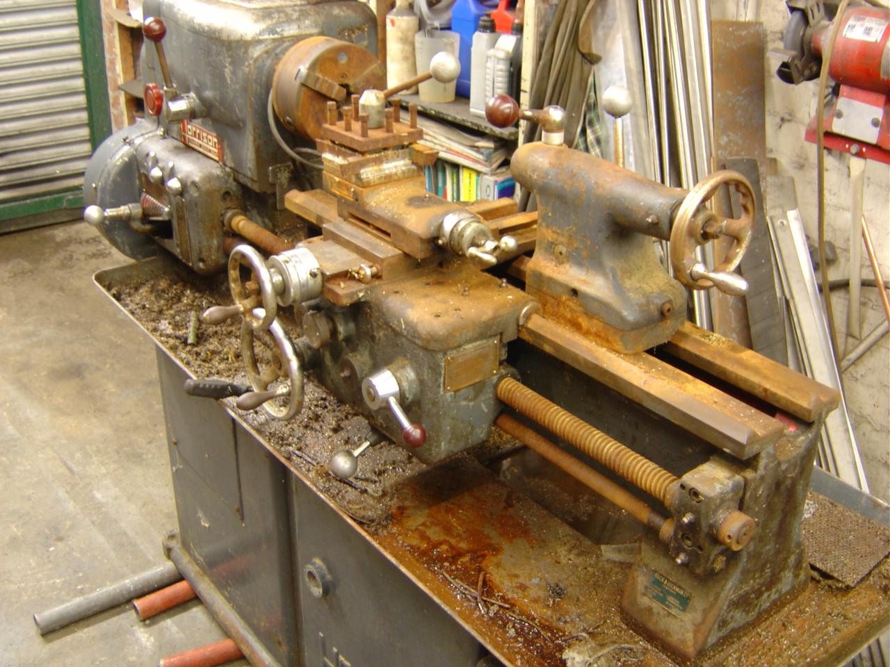

  After spending hours hopefully sorting out this photo embedding and resizing business :scratch: I will try another photo to see if its worked or not. If anyone else is wanting to do this,  look at Robs post above for links to Ralphs  ( Divided he ad ) TOP CLASS postings on the topics, he will defo go to Heaven for them posts  :bow: and deserves a huge gold medal too  :clap: not to mention a few beers. I would have been messing about till Christmas to have worked that out on my own  :doh: .......who am I kidding ....... I would never have worked it out.  So thanks again Rob for pointing me in the right direction and Ralph for taking the time to post the instructions in such a easy to understand way.
http://i1167.photobucket.com/albums/q631/micktoon/Madmodders%202012/Lathestripdown010.jpgHarrison L5 rescue
This is the headstock after all the flaking paint scraped off.
  Mick

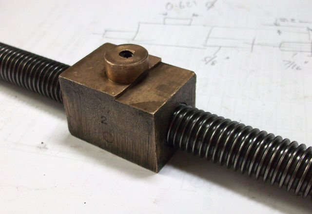

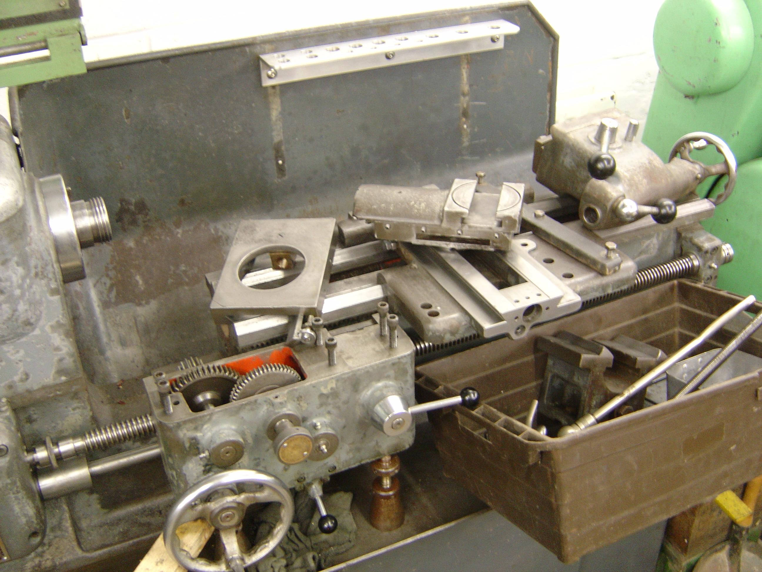

I've been fiddling with a knackered L5-4A just this afternoon. Yours looks in much better shape :) Will be watching your progress with interest
I'm about to graft a new-ish piece of double start thread to the old cross-slide screw (I didn't fancy trying to make a complete new one) .
Do you have a picture of the top of the cross-slide nut? (I'm not sure if this one has been modified - has a step milled into it for some reason).

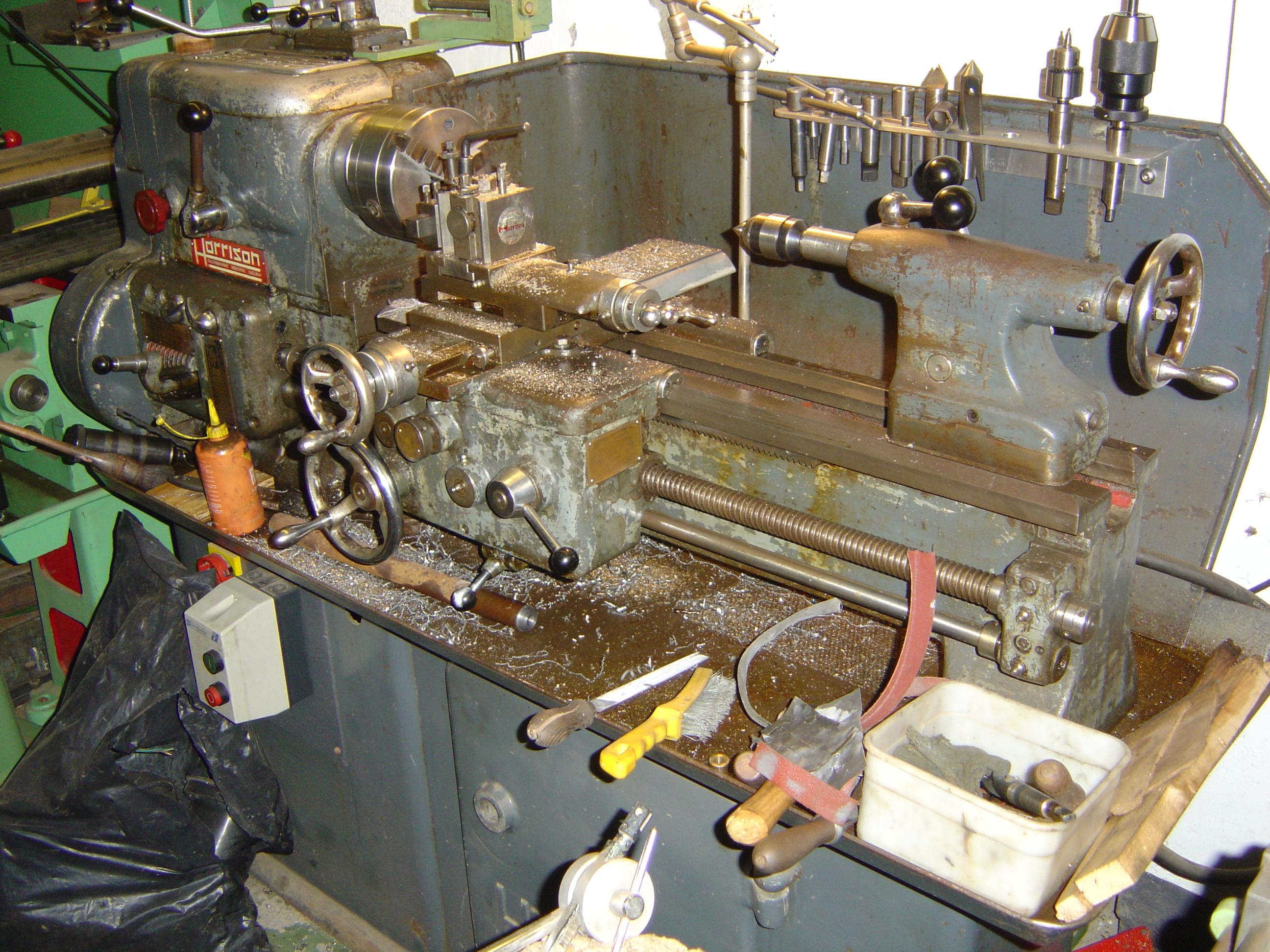

  Good evening gents , I have got distracted from the lathe today getting the milling machine cleared off and making a gadget that a diamond point dresser fits into to true up a grinding wheel for sharpening my woodturning gouges, I will attach a photo or two and you will see what its like ( the holes in side of billet were already there and just big enough to do the job so will have to do. I have been given one to copy. Note temp inverter for power table resting on radiator... another job to do !
  Is it just my clock on posts wrong or is everyones ? its 4.30pm ?? acording to the site, the other thing is in my profile I put location Newcastle and my age but they dont show either ?? any ideas.

  Hi Bill, I will take a photo and post it in the morning for you of crossslide nut, mine looks a bit homemade ? it has raised spigot on top and a split that has been pinned with grub screw to take up backlash by moving either side of the split apart ?
  Hi Rob, I have been collecting machinery and tools for ages now so have Bridgeport , Boxford shaper, progress 2 pillar drill, Harrison ped grinder and buffer, the Harrison L5 , Harrison graduate wood lathe a Binns & Berry lathe 7 1/2 inch centre height, Clarkson T&C grinder, Startrite vertical bandsaw and Horizontal bandsaw, Mig , Tig. Half the machine tool stuff needs the same as the Harrison ( a good going over to get it operating right ) Next on the to do lists are the Clarkson, needs tee slot table as slots burst out and to get the Bridgeport fettled.  I am watching your CNC conversion with great interest, its looking very nice too.
  Hi John, I am glad to hear your impressed with the inverter, I watched your screw cutting video on youtube and the reverse looked spot on, I have just seen your latest engine base pattern post there , it looks quality, thats going to be some pour !!

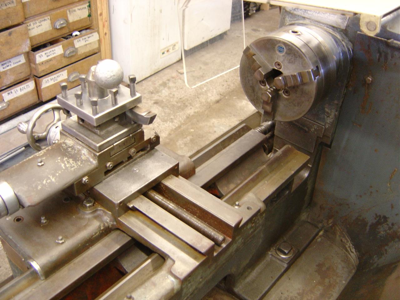

  Hi Bill, I have the photos for you, I cant tell if this nut is homemade by someone that knows what they are doing or the way it was made at the factory , it does not look mass produced so makes me think homemade but some stuff was just done by hand in the 1950's anyway. this has a very small milled recess as you will see but I cant see a need for it anyway, this one has a small hole drilled down from the top so oil could get to the screw, my base plate ( part with the graduated scale on ) where this nut attaches to has no place for an oiler but others I have seen have so I might add one anyway.
   Hope the photos help if you need anymore of other parts just let me know .
  Cheers Mick.

  Bill I have just thought why the milled part might be there, the small thin chip guard at the front of the cross slide will hit the nut and stop travel I think  when the cross slide comes back towards the handwheel, so this gap will let the cross slide reach the hand wheel end at full travel ?
  Mick
  • Posts: 1224
Re: Harrison L5 rescue
« Reply #21 on: July 10, 2012, 06:20:32 AM »
That's great Mick. Thanks :)
It confirms that the step is required (I thought it might be a backlash reducing bodge ) .
I'm fairly sure this one is an original nut : it's a crudely fettled casting. Both it and the screw are marked with a figure two. Interestingly, this one was spaced down by a small stack of shims - I guess that, when new, it had less than the 60 thou" backlash !
Thanks again for the pictures. If you need any of this one, let me know .
