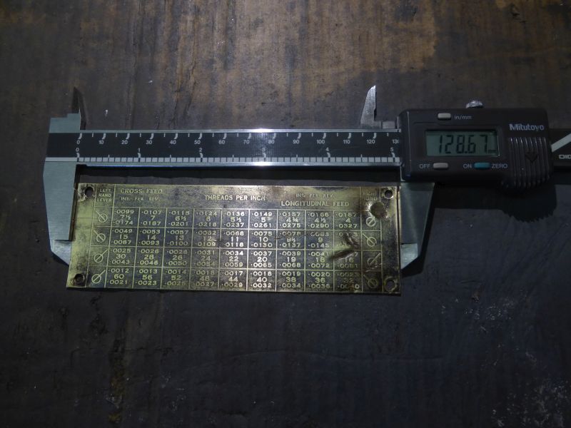

« Reply #175 on: February 20, 2014, 01:30:52 PM »
Cheers for that John,I'll measure up later and come back with the actual size.
The one on my Harrison has suffered from some brute bashing the face of it with a chuck key or similar implement,but these lathes have mostly been ex college training machines so nothing surprises me regarding the mindless damage often seen......OZ.
Re: Harrison L5 rescue
« Reply #176 on: February 21, 2014, 08:53:09 PM »
Hi John, the diameter of the recess in the plunger head measures 37.55mm,so 37.5mm would be safe.
I wonder if Mick has a dimension for the plunger on his L5, I can't imagine it being different.
Having said that,we are dealing with Harrison machines here so anything is possible :Doh:
« Reply #177 on: February 22, 2014, 06:03:38 AM »
Mick has 38mm for his and I now have decent photo's of the plates.

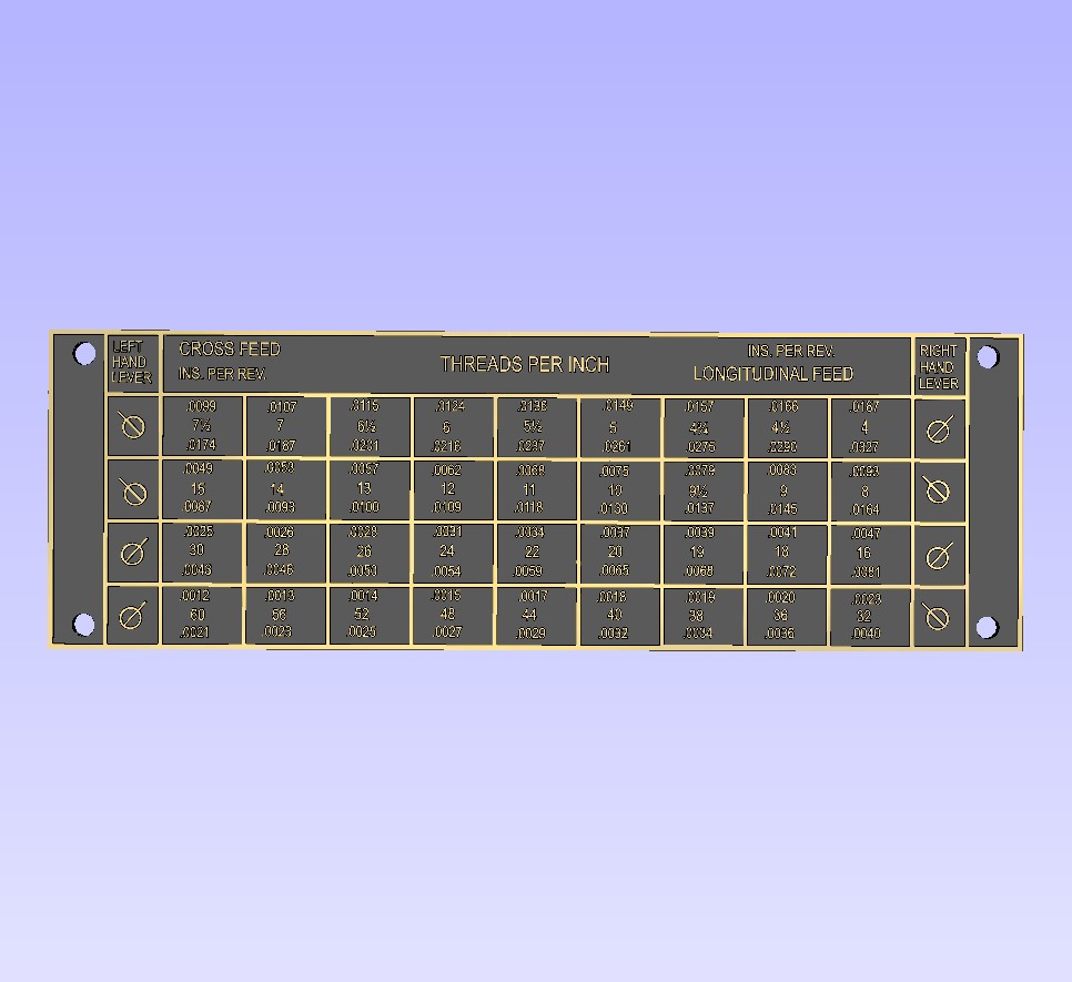

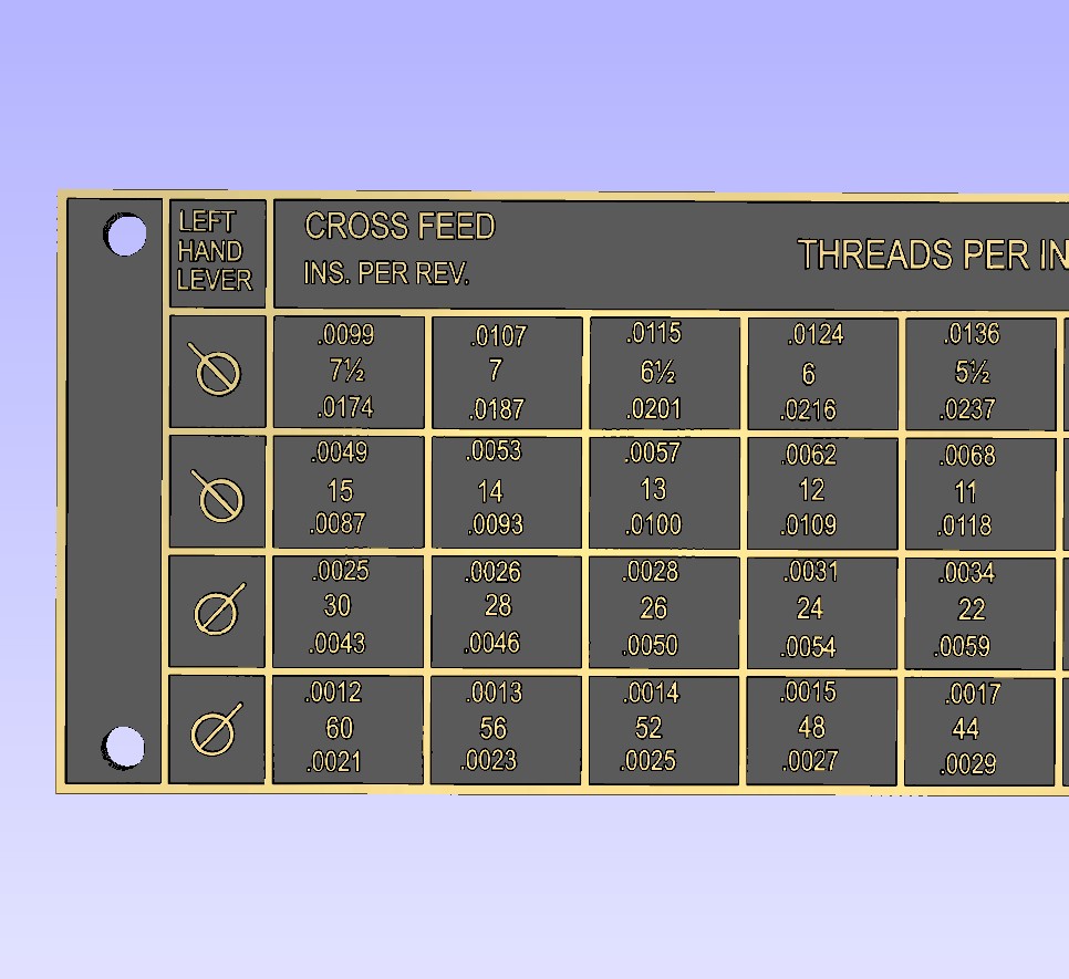

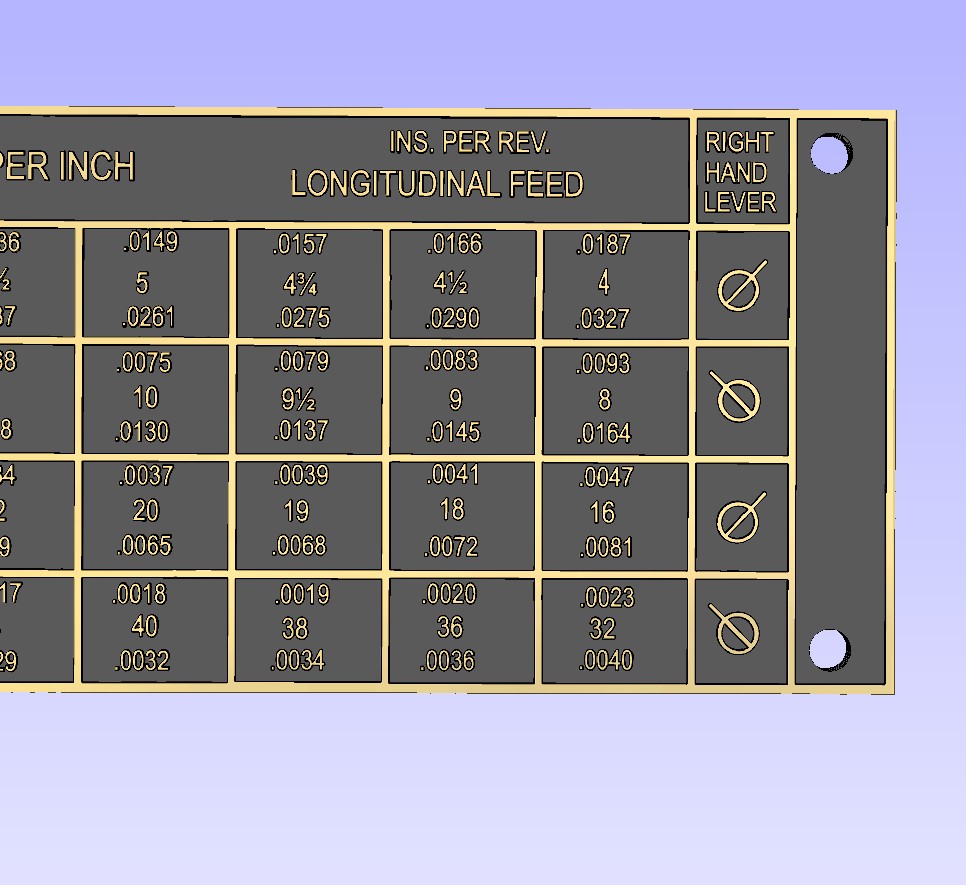

« Reply #185 on: February 22, 2014, 08:42:34 PM »
Had a bit of a play tonight.
Mick sent me this as a picture
Finished up with this.
Doesn't look that good as the detail isn't great to get the whole plate in shot given these letters are all under 2mm.
But if you zoom in it shows just what it *should* come out like.
My CNC router is very good on detail so it should work out OK, I'll get to it one night next week.
