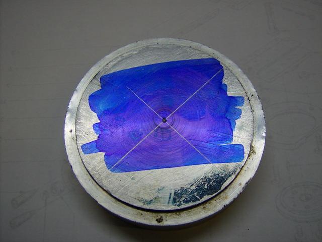

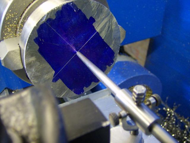

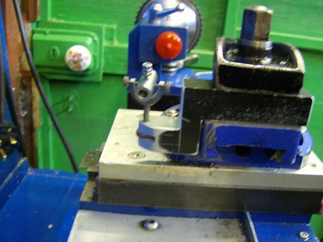

Yesterday night I had a little shop time I wanted use for a quick drilling and tap-testing of a hole somewhere into that block.
On second thought, I decided to take the longer, but safer, way of scribing FIRST and drilling NEXT. I seem to recall that random
placed holes have the bad habit of getting in the way on later stages of the build.
Being in haste, I hurried with rulers, squares and dividers for a while: had a glance at the finished mess and went looking for
solvent and rag. Either I do it or do it not, doing it bad makes no sense.
Decide to treat the thing as it were a casting (well, it IS a casting! Is it not?) and clamped it to an angle plate to set it vertical
with all the faces square to the reference plate. Then brought into play my digital scriber and presto, got it done as precisely as I needed it.
http://i1226.photobucket.com/albums/ee403/mzetati/_steamEngines/WIP03_PottySimpson/02/02_IMG_0757.jpgPotty Simpson build - MZT
It took less than on the previous attempt, but I will never learn that.
Here it is, scribed in one piece together with the base (for the moment, will decide what in due time). The blackened parts needing a complete
removal however I will tackle the job, the encircled area showing the largest void I can see at the moment.
http://i1226.photobucket.com/albums/ee403/mzetati/_steamEngines/WIP03_PottySimpson/02/02_IMG_0763.jpgPotty Simpson build - MZT
No time for a second check of the dimensions, to say nothing about drilling. Maybe tonite.
