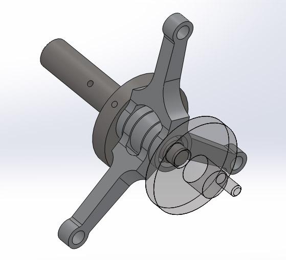

This is a project I’ll devote some time to, and there will be a lot of waiting around for parts as I’m not going to do the machining myself. In other words, don’t expect the build to move rapidly.
Plans started with a Cygnet Royal and some computations. Figured I needed a 2.5:1 scale in order to get 1HP at ~2000rpm and 2HP at ~3000rpm. I won’t need much more than 1HP, but some parameters are guesstimates, so I stay on the safe side. Also, it would be nice not having to push it towards its max all the time (I’ll team it with a 1HP boiler).
I built a CAD model (SolidWorks, attached pic) after scaled drawings, played a bit around with it to learn the operating details like the orbital valve, and now I’m starting to build a second model I’ll use as a blueprint when machining the parts.

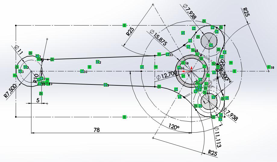

Some changes are to be made thou, especially with the crank mechanism  :scratch: crank arms offset from piston centre worries me, and with a master/slave arm system I just can’t seem to get enough room for the shaft dimensions and bushings I need without increasing stroke length  :bang: I’ve had a look at the “fork & blade” system used on many V-engines, and a triple one is probably doable but I’m pretty sure a noob like me would mess it up. Best way I see is plain narrow crank arms and offset cylinders. The symmetry of the looks isn’t all that important to me, and I avoid over complicating things. Is there a big vibration penalty to this? We’re talking about 1cm offset between them  :scratch:

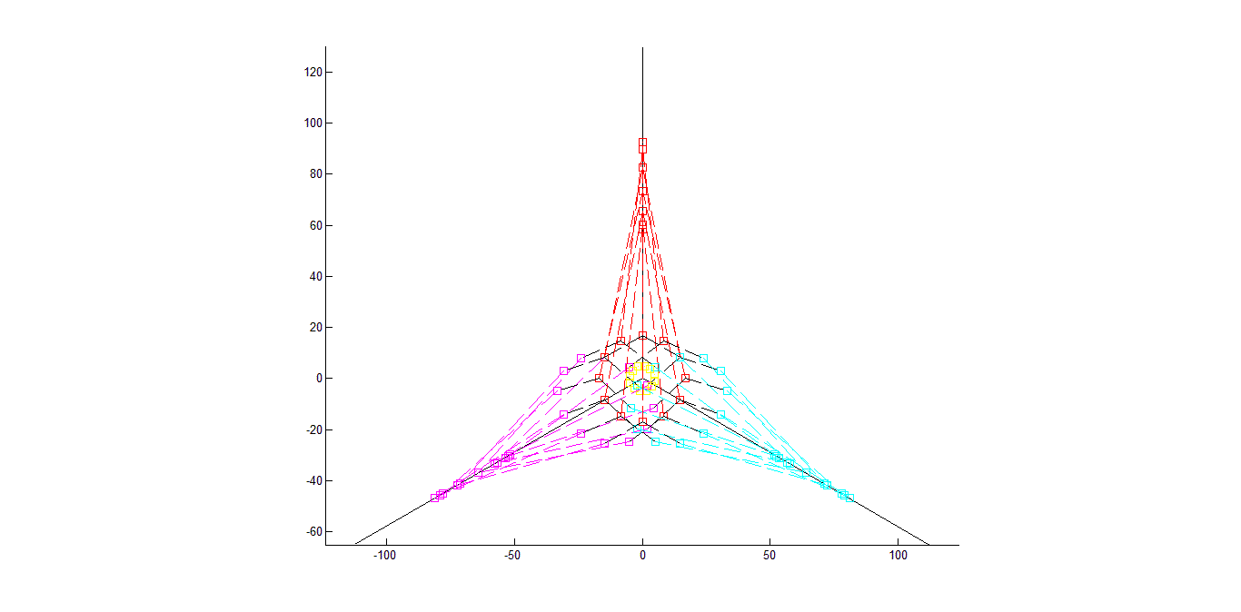

I’m also building a primary balance model for it  :smart: in Matlab (see attached pic). I’ll treat piston and wrist pin as one unit, crank arm as one, then there is the offset crank shaft, and the orbital valve (out of phase with the crank). Plan is to have the model make vectors of locations of the centres of gravity over one full rotation, in order to assign mass to them and plot the total centre of gravity over the cycle, which I can hopefully use to calculate how to shave the counterweight  :thumbup:
Crank casing will be 1st part btw, I've located some 6" diameter 6082 alu round bar for it  :ddb: But some more drawing will have to be done before I can cut  :coffee:

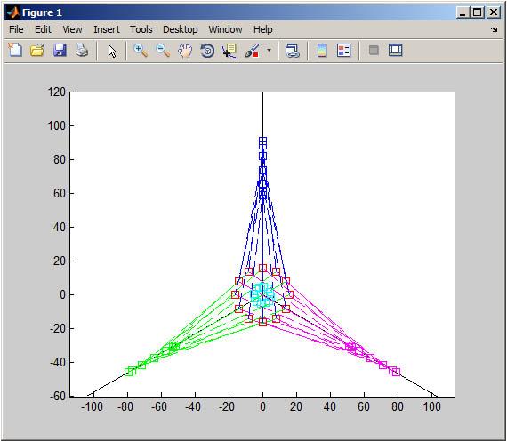

Had an hour this morning to play with Matlab,
Black squares are CoG of the pistons, offset out along the line from the wrist pin by a variable.
Yellow squares are CoG (axis) of the orbital valve and supporting pin
Red squares are CoG (axis) of the offset crank shaft
The rest of the coloured lines are the crank arms, and the square marker on them identifies the CoG of that crank arm.
Inputs to the model will be material weights and CoGs as computed by SolidWorks, and there will also be tolerances, but it should get me as close as I can get.

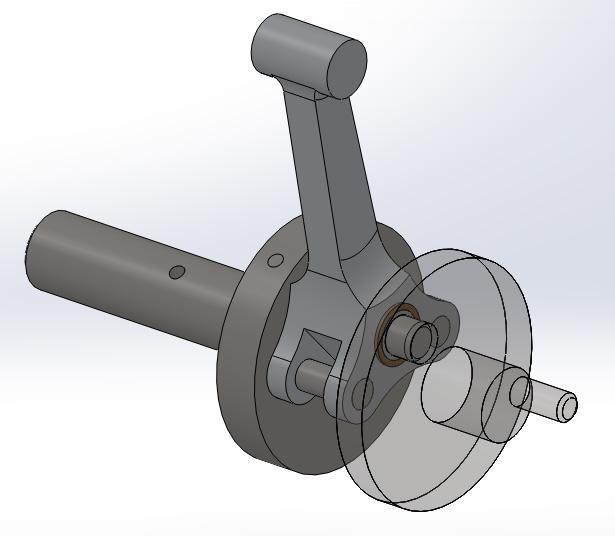

Back to the crank, by "fork and blade" setup I'm referring to something like the attached scribble, only built differently, probably aluminium with bronze bushings. I haven't seen such a triple setup anywhere, I don't know if that's for a good reason. I'm still a bit undecided on what to do here  :scratch: any input on the subject would be highly appreciated  :poke:
fork & blade vs offset cylinders...

I just had a revelation skimming through Elmer's radial engine  :coffee: It uses way thinner shafting than the Cygnet, at the same cylinder volume, perhaps not advisable to run at the same max RPM, but it was reassuring reading. I did a sketch with my shafting dimension references somewhere inbetween the two, and was able to fit a bushed master rod large enough to accommodate bushed slave rods. Main shaft remains 20mm, crank shaft 1/2", and slave pins 5/16". Back to not eliminating any options at all, I'm more undecided than ever. This one would actually be my favorite ATM.

Geometry of the primary balance model for the master/slave rods gets even more cryptic than before  :smart: Red is the master rod, cyan and magenta is the slave rods. But now I can combine the entire crank into the same body mass as the master rod. Only other bodies are the two slave rods, the pistons/wristpins, and the orbital valve/pin.

I made a different fork sketch that I plan to simulate with some forces to see if I can strengthen any weak spots, only problem is I haven't done such simulations since school, and I don't remember exactly how to. Anyways, this would be the outter rod, if that one can be done right, the other two probably can as well. No closer to any decision  :bang:

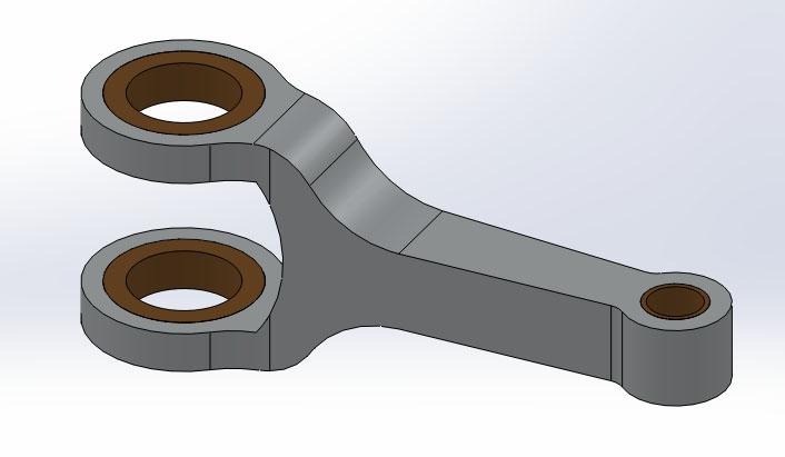

I attached a visualization of the forked crank. It doesn't look all that bad, the worry is ofcourse the outter fork.

Is there any reason why you cannot off-set the cylinders by the width of the big-end? - It would mean all the con-rods could be identical and simpler to construct.
Nope, no reason whatsoever, it's probably the way to go. Just had to skim through the options first. Think it'll actually be easier to balance properly too, with all rods being identical.
Is there a reason why do you must place the fork/blade such that one will span the whole distance on the crank pin? If you allow a little offset or cylinder and do all con-rods forked and anly middle one a little wider fork? Should probably C-O-C one, because I'm not sure if my explanation does any good.

I understand the suggestion Pekka, and it would perhaps be a better choice than the setup I sketched, but I think my mind is settled now, on plain conrods and cylinder offset. Just makes the most sense.  :beer:

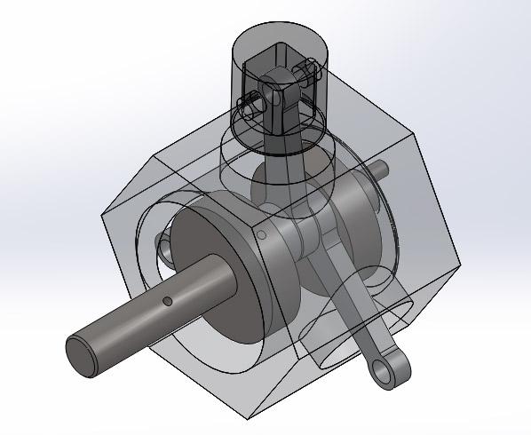

So, the crank casing got a bit deeper, so did the balancing eccentrics, but crank casing width/height could be reduced some without the crank arms colliding with the cylinder wall, and I was able to also shave some millimetres off the crank arm length due to the reduced size of the crank mechanism.
From a cosmetic point of view, a cylinder exterior like this one would even hide the cylinder offset from eye. Just a thought.
But the more I read on the topic of crank arms, the more confident I get that this is the best solution for me;

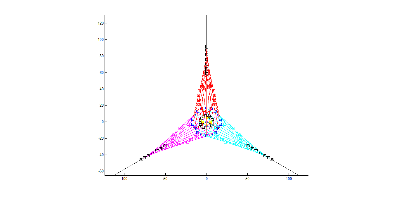

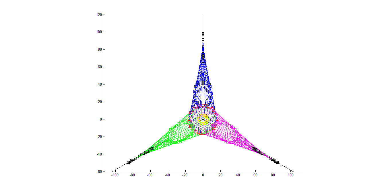

OK, I did some programming, and plotted the centre of mass over a cycle. Individual component centre of mass is rough guesstimates for now, I didn't bother to make exact numbers as they may well change. All I wanted to see if there was a symmetry. The black squares in the middle marks the centre of mass over the cycle. Looks pretty good if I got it all right, i simply took R=1/M*sum(r*m) where R is the overall centre of mass, M is the total mass, r is component position and m component mass.
This is what the code looks like in Matlab;

Re: Radial 3-cylinder steam project
« Reply #16 on: May 11, 2012, 05:54:10 AM »
Looking good. Radial moments should look symmetric anyways. What kind of moments do you get between the crank disks? I can't remember the english word for Kippmoment (DE). Long time ago I spoke to people who actually designed engines and if I remember correctly they were not that concerned balansing or vibration, but crankshaft wobling wildly and wearing damper out or snapping off somewhere. Don't remember much.
I'd like to see that engine build.

« Reply #17 on: May 11, 2012, 08:20:43 AM »
Pekka,
Kippmoment translates to "overturning moment" by google translator, but I'm not quite sure that's an accurate translation. Searching around brings up mainly building stability articles and this how-to, amongst other things referring to the Miles equation, but I can't immediately make much sense of it (then again, I'm not exactly a mechanics wiz). I text messaged a German friend of mine with the term but she's probably at school right now, don't know if she can help me out though, she's not a technician.
Another thing that boggles me when it comes to rotational physics and moment of inertia etc is the crank arms and pistons, in the sense that they are linked to the rotating system, but not directly a part of it as they don't rotate. All I've done so far is look at the mass locations over time, not the forces at play (centrifugal, piston acceleration, etc).
As a curiousity; In the Matlab plot I posted previously, the overall centre of gravity seems to be a circle centered around the origin, but it's actually off center by a tinsy bit (x=-0.0870mm, y=0.3352mm)  :zap: I'm not sure why this is, if it could be a numerical error somewhere. I averaged (min+max)/2 values for both axes over a cycle with 0.25 degrees resolution, since I noticed the vector length from origin to each plotted point varied. It would not pose a problem to perfect primary balancing though, but I'd like to understand why it's not perfectly centered.

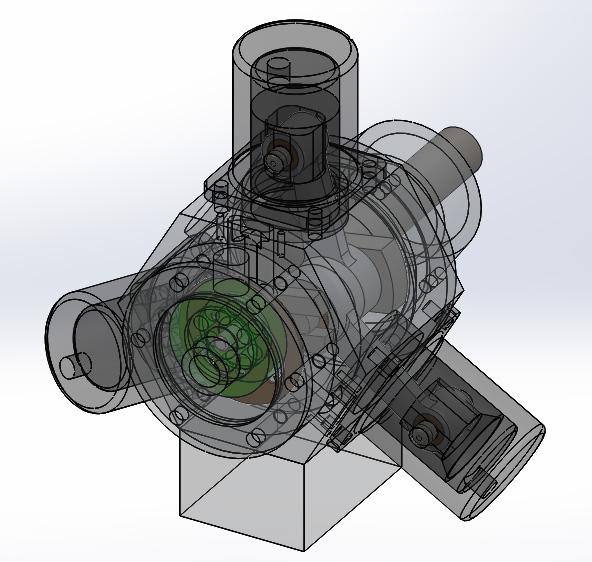

Anyways, the crank casing is coming nicely together in SolidWorks, and I'll be ready to have it cut in not too long. The first small step of the actual hardware work  :beer:

EDIT: the plot is not a perfect circle even when centered around it's mean value. Analyzing the circle (no offset added) I see i get a circle with a small hump where the crank shaft nears a cylinder. Or at least that's what I think I see judging from the numbers running down my screen. radius varies from 7.3mm between pistons to 8mm when crank shaft is near a piston (and thus the piston is at it's outer extremity).
