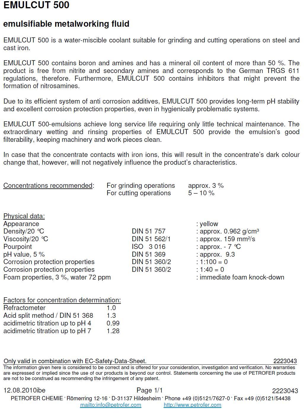

Most important of all; it will keep your HSS end mills like brand new, with more tolerating for deeper cuts.
I use “borax oil” (Liter is around 3$ goes for about year for moderate use.)
http://i1251.photobucket.com/albums/hh544/ukazak/Water%20Coolant%20For%20Milling%20machine/SANY0053.jpgEZ Coolant For Small Mills
add a cola lid full or two into plain 2 liter water, turns into milk like liquid. You probably know what it is, you may have seen over the pro shops of raw material cutting saws.

What is "I use “borax oil” (Liter is around 3$ goes for about year for moderate use.)"
Where to buy??? Will it cause rust???? :drool:
It is water soluble oil. used for cuts, grindings, drillings, turnings etc of metals. non rusting properties, gives tools long life etc.
Offline ukazak
  • Posts: 55
Re: EZ Coolant For Small Mills
« Reply #11 on: March 30, 2012, 04:47:16 AM »
there are different types of these oils "Boran" based some 200, 340, 2500, 2800 etc. best is bi-metal cutting- colour is turns white when water soluted, you can check on them in the net. here found easy, it is sold open barel. I dont know if they are bottled. if so, would be more added to the price.
while they cool, they also ease on cutting and protecting.
For UK check;
http://www.cuttingfluidsuk.co.uk/
