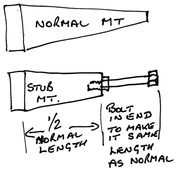

Re: Peck Drilling THANK YOU
« Reply #5 on: January 24, 2009, 05:52:19 PM »
Spin,
If I was you I would take Stews advice and buy a blank MT taper, they are very cheap.
Kicking over your tailstock is easy, and you would soon get the job done. Getting the tailstock back into perfect alignment is a real PITA involving drive dogs and turning between centres. Been there and got the t-shirt.
If you were making a couple of dozen, then yes, but for one or two, the figures don't work out.
If you just want to make quickie MT's for general tooling use in the tailstock, you could easily make stub MT's by using your compound slide kicked over and the material held in the chuck. Because the compound most probably won't have enough travel to turn the full length of a standard MT, then turn what you can and make up the difference with a bolt in the end so that the eject in the tailstock will still work. A minimum of half the length is required to give a stable seating.
Once you have the correct angle, knock up half a dozen for future use.
C-o-C attached.
Bogs
