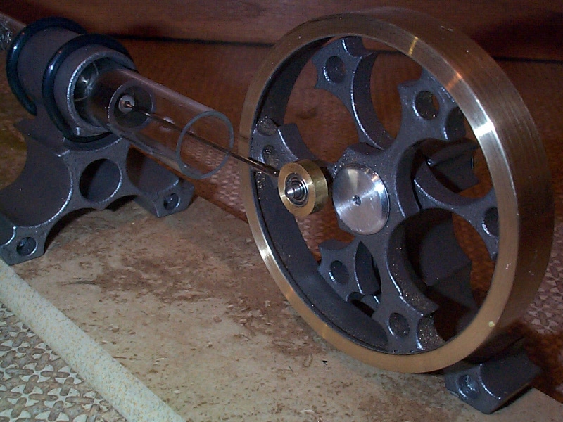

A Lamina Flow engine I built using an Airpot piston - cylinder. Bore 0.620 +/- stroke 0.750.
Majority of pieces made from same jig used to build the flywheel web. Only have an old AA109 so its just a lot of curves, I like curves.
It runs around 125 to 175 rpm depending on the wick size, something I can just pop on the table, light a match and watch it go round.
Robert

Looks a pretty sweet machine to me Robert  :thumbup:
Since I've not see this before, is it in the project logs section? If possible I'd like to see some pic's of the main mountings etc. You can't really see them through the spinning flywheel. That said a still of the flywheel might be nice too?
Anyway, as said... Sweet machine  :clap:

Thanks for the comments

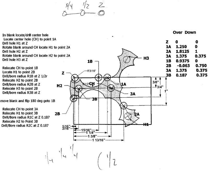

Was no build log, was not sure of what I was making till it was done. Major pieces were made to a jig. A lot of moving the pieces around to get the separate cuts. Thought I would get fancy and do a flywheel spinner, forgot that the spinner has to be a rotating shaft and, well, OOPS, having the flywheel and spinner each with there own ball bearings did not quite make the grade. Conrod bearing came from a 'puter cooling fan.
Piston and cylinder are from a "Thank You" free sample Airpot. Think the orifice as supplied was 0.140" I enlarged it to 0.187" did not have any great effect upon its speed.
Pic is of the jig layout I used to fabricate the pieces, long as it fit within a 6 inch envelope was doable. Other shot is better view of the silly thing.
Fancy or not it is fun to turn lifeless hunks of metal into something, just go easy of defining "Something"
Robert

Thanks for the kind words. Only have an old AA109 so most things are done on a face plate. Something like 30 parts moves per piece so a jig was the only way to go. Any one that stops by now gets the " Hey check this out" as I light the wick. They get this sorta weird look in their eye tho as they look at me.

Bet it takes forever using a fixture (Rob said "fixtures" for holding work - "Jigs" for holding tools IIRC?) and all those moves!?  Sweeter to see it running I'm thinking?  :)
Ralph.
You remember correctly Jig for drilling and Fixture for holding. In my case the use of Fixture is a better description. Spent 20 years at Boeing and still has trouble with fore and aft, its front and back :)
