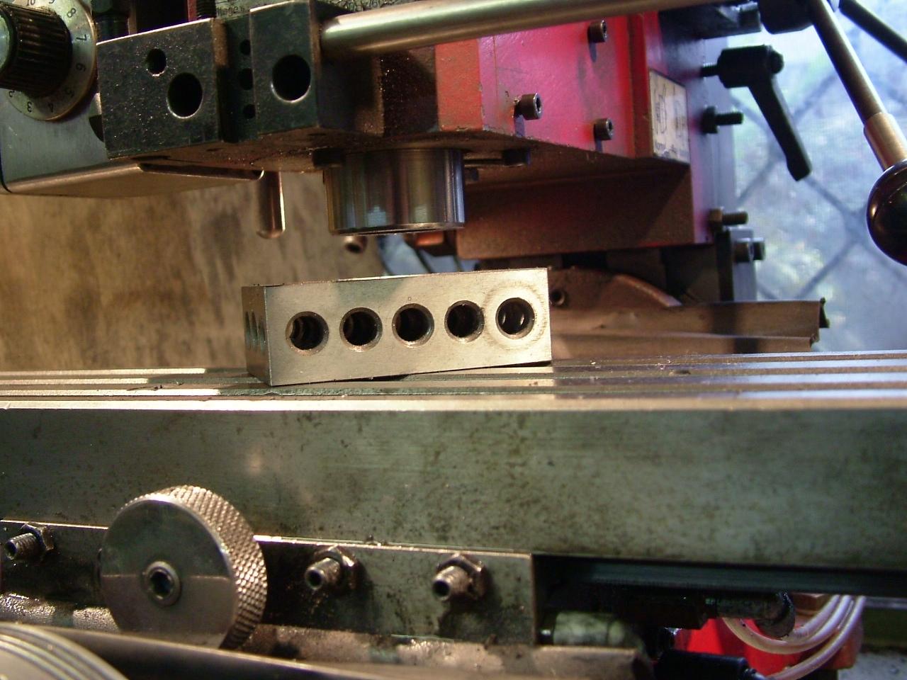

Hi this is a "What I Did not a How I Did It" post
Also posted in Hmem

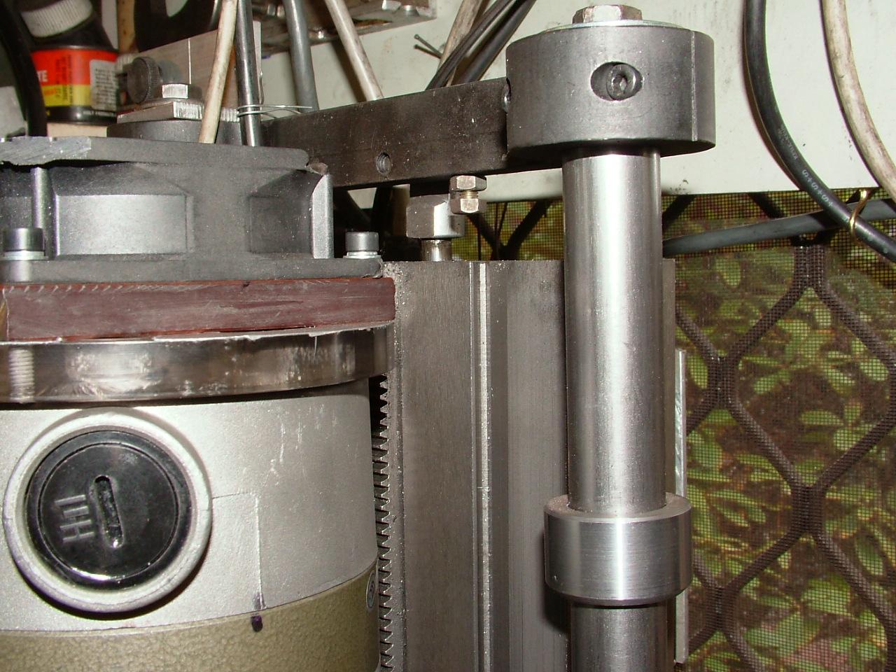

Stripped out All gears and counter shaft from mill head and replaced bearings With Taper Roller Bearings 30206
30 X 62 X 17.25. Grind down 1.5 mm from inner race.  Fabricated brass shim shields .25 mm thick = 16 mm Height (same as original ball bearing)

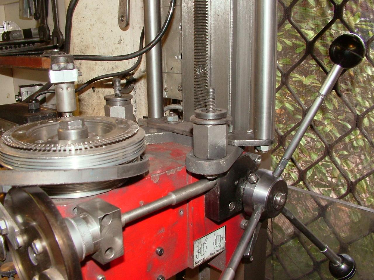

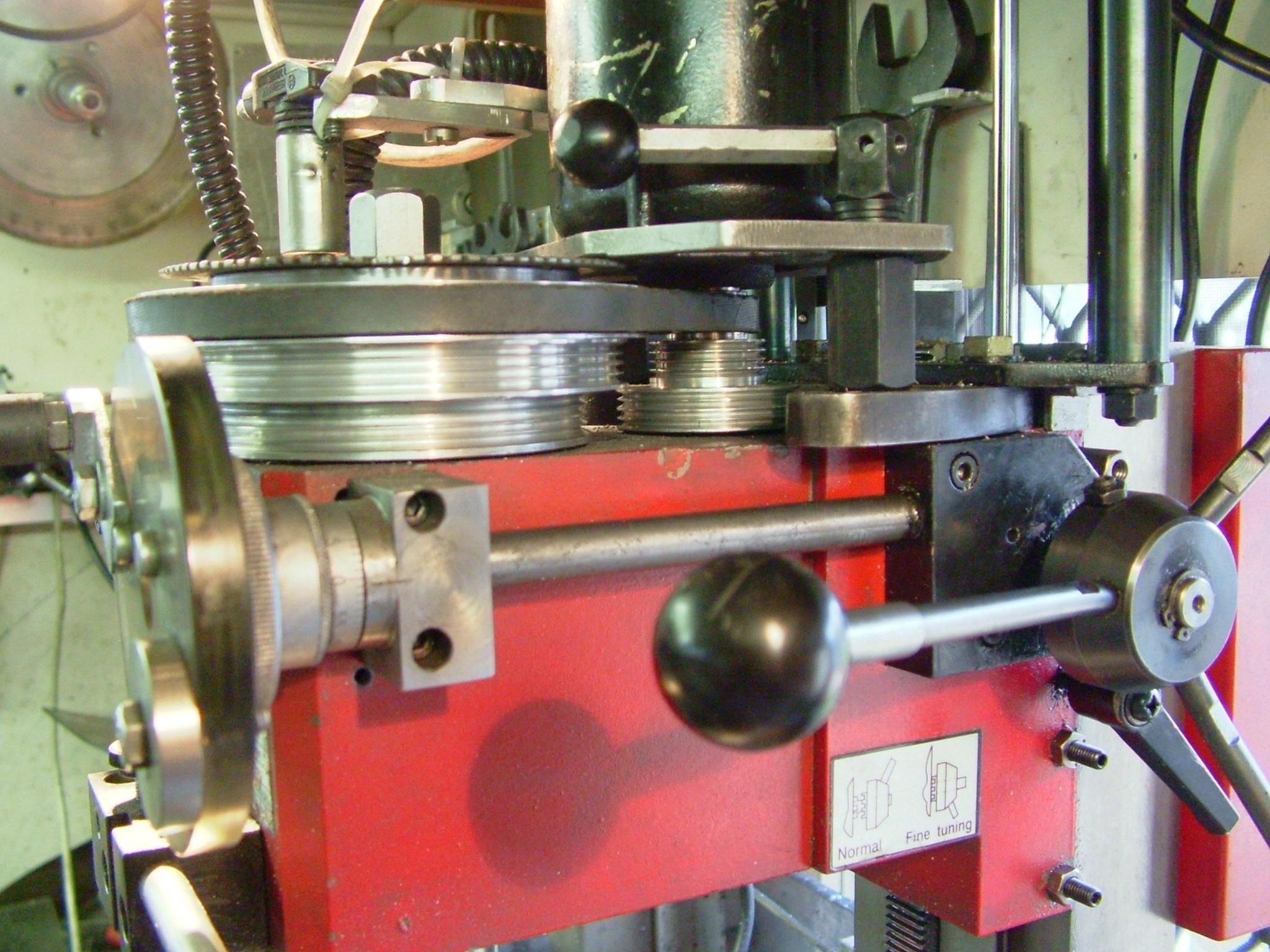

Fabricate and Fit "Poly Vee Pulleys calculated to give 1200 rpm 1900 rpm and 3500 rpm
Drill and tap top of gear box to fit 12 mm aluminium mounting plate

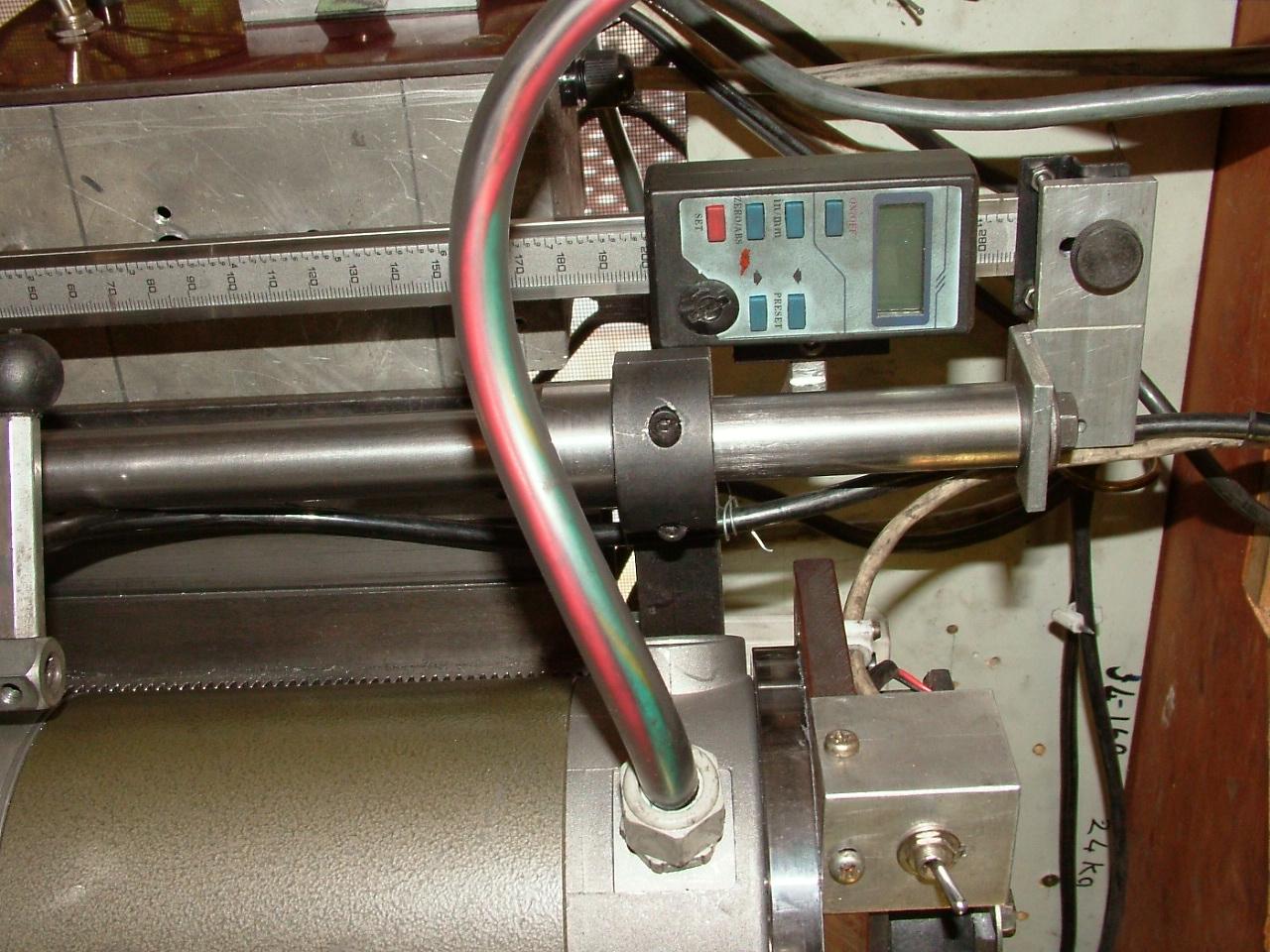

Removed torsion spring mechanism and fitted Longer rack to give 205 mm travel.
Fitted "Air Spring" to counter weight of mill head  24 kg rated.
Added rev counter from diesel engine 96 tooth disc and ABS wheel sensor from a Volvo as pickup 12 volt DC powered.
Made and fitted stiffener for column Thanks to all who submitted their ideas to "Home Model Engine Machinist."
The results are remarkable "Self Praise Again." No grumbling gears or power wasted making them spin
 Added photos of Belt Drive

Hi Eric & Joe and all others that are interested
The motor I have is a "Brand New" one bought at an on line auction. It is made by Te Wei Engine Ltd (China) and is rated at 5 amps Whoops that is 1.25 hp NOT 1.5 hp Clockwise Rotation.
This was not a problem as reversing the supply leads and it is now Counter Clockwise.
The Flywheel was removed and discarded and Stepped Pulley fabricated and fixed to the shaft and secured with two "Grub Screws" to Dimples drilled into the shaft.
The "New" motor would not fit to the Existing mounting so the yoke for the "Air Spring" was discarded and new one machined out of piece of cast iron.
With a bit of thought this could be made "Adjustable" to give MORE "Z" Axis travel from 205 mm (Max Stroke on Air Spring)
to 285 mm plus.
Adjustment is by loosening the clamping screws on the yoke and sliding it  up or down the two 20 mm columns
Will attempt to tell the story with a few pictures showing Set on Low and Set on High with the motor mount as well
