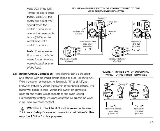

I have it set up with the original heavy choke, and the original line switch/circuit breaker from the treadmill, and a 5k pot from radio shack for speed control. It works, but still has the soft start feature, and the pot must be turned up about 50% to start the motor. I found son instructions for modifying this controller to remove the soft start, and one that supposedly will allow setting speed and being able to turn the motor on and of at the last speed setting. Only problem, the controller schematic provided with these instructions, doesn’t seem to match the Proform MC-60 I have.
Has anyone modified this controller to remove the soft start? Will a 10k pot make the speed transition smoother?

Hi chuck I am a big fan of DC Motors and Controls all my machine tools on DC Power using  "Dart, KB Electronics and Minarek" Controllers. You can get a control to stop and start on the same pot setting by inserting a switch on the "High" wire on the pot. This is just an indication of how it MAY be done.

I'll insert a switch in the high side of the speed pot and see if it helps. Thanks, Velocette.

:update:  R42 Resister value For the MC-60 controller is..  *54.9K Ohm. the band colors are [Green-Yellow-White-Red-Brown]
If your motor does not start until the potentiometor is turned about half way replace or resolder r42 for fine motor control over full range.
