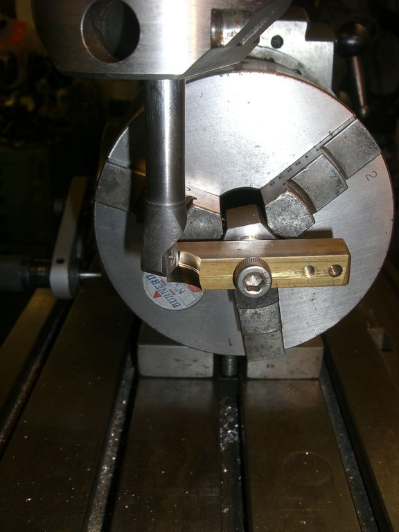

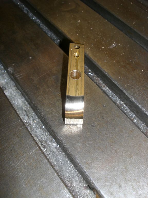

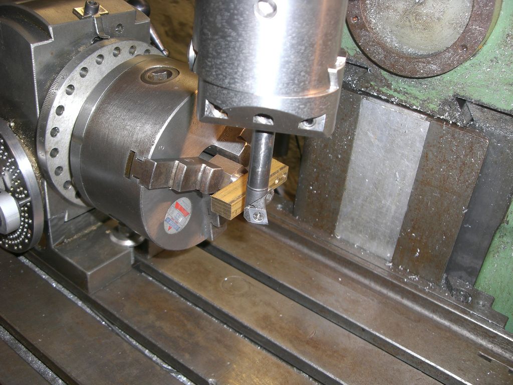

« Reply #12 on: November 21, 2011, 06:52:47 AM »
Hi Chris,
I needed to put the dividing head on the miller this morning so I thought I'd take a few pictures to illustrate the method for cutting the radius concentric with the pendulum rod hole.
The first pic shows a piece of brass mounted on an arbor. The cutting tools is set to the centre height of the dividing head and to approx 3/8" radius.
The second pic shows it mid cut - the cut being applied by rotating the dividing head.
The third pic is the block with the rad finished.
Hope the pics explain it better than words.
Cheers.
Re: Machining order and method for this part?
« Reply #13 on: November 21, 2011, 10:19:26 AM »
Very nice, Phil.  This is exactly what I was trying to describe.
As they say, a picture is worth 1000 words!
-Sparky
  • Posts: 2914
« Reply #14 on: November 21, 2011, 07:15:02 PM »
God like - I owe you one, those pictures are perfect and I now get it 100%!!!
I am going to give this method a go either tomorrow or Wednesday. I`ll let you know how I get on.

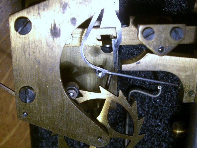

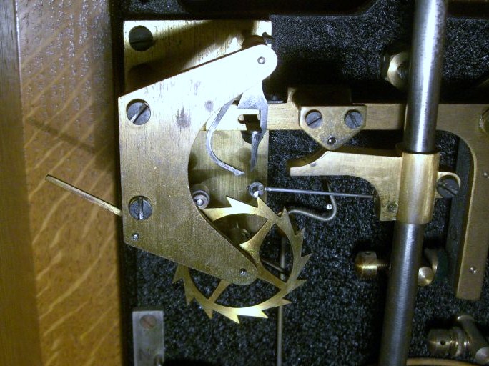

« Reply #18 on: December 04, 2011, 05:14:25 PM »
Hi Phil, sorry, never replied to your message although we did speak via pm. Hope all is well.
I finished the entire clock today and rather than put it in a new thread, I just thought some of you might be interested so here you go...
Well the pallet was finished and I made up a gathering click. The part looks well with the rest of the clock in my opinion:
Just need to sort the electrics out now ....
Any my wife even likes it...it has made it onto the wall!!
Thanks again for all the help with the original issue...I couldn`t have made it without your suggestions, help and advice..  :mmr:

Hi Chris,
It looks great!   :thumbup:
The electrics are straightforward. I run mine from a 12v lead-acid that's always on charge. I can't remember what current it's adjusted to on the rheostat.
There looks to be something untoward with the fish hook shaped piece - it looks to have been bent upwards. The picture of mine shows how it should be. The idea is that if you set the N/R/A lever to A then the gathering pallet will catch on the 'barb' of the hook and operate the slave on every swing of the pendulum to advance the slaves rapidly.
The case looks really nice in black. Mine is a varnished light wood finish but with quite a bit of damp staining at the bottom where it was stood on a damp floor for many years before it was rescued and given a good home. I think a tin of black paint will go on the shopping list.
Cheers.
