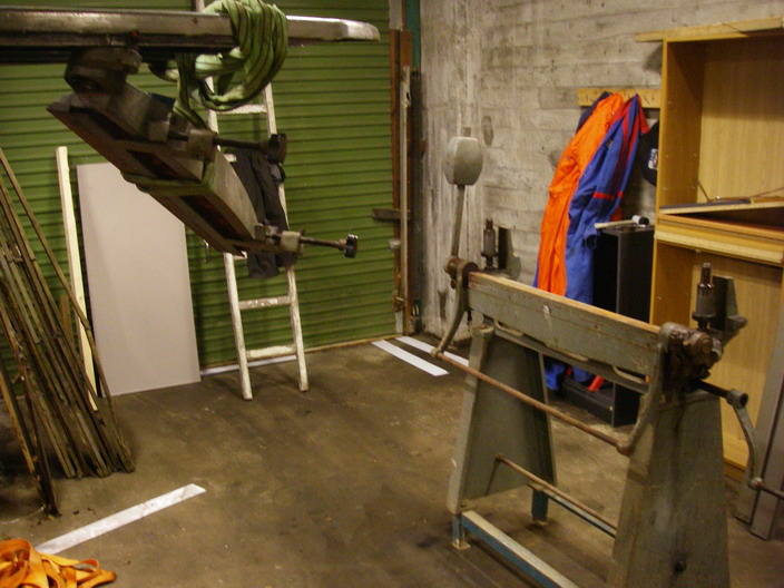

Hyllus 1020 x 1,5 plate bender
« on: November 14, 2011, 12:53:50 AM »

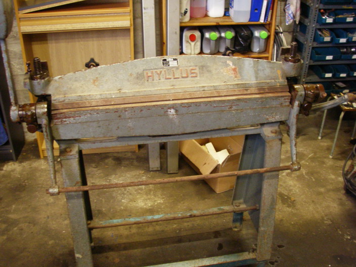

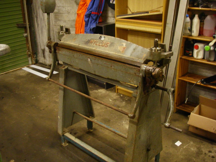

I have a bad habit of searching the local for sales stuff daily. On saturday i found a slightly defect plate bender for £50, so I was forced to call the guy. Long story short, it's in my shop now. Only needed a bit of derusting, cleaning and lube as one of the height adjustment screws had seized. After that it was good to go.
One part is broken out and is fixed by welding. It does its job as is, so it is not going to be fixed just now.

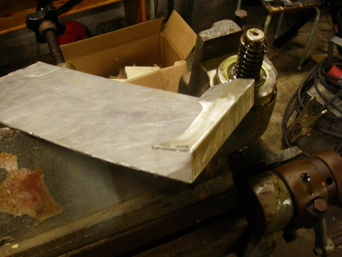

I had to add a picture to show that it is working too  :ddb:

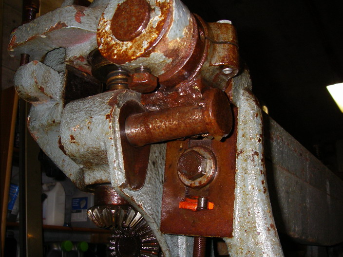

I needed to make a new oil catch tank for the Nissan, but wasnt sure the plate bender was up to it with its broken hinge.
The cast hinge part has broken in half, probably when bending something much thicker than 1,5mm. The casting wasnt very good though, showing evidence of a lot of air pockets. The previous owner had tried to weld the broken part with limited success.
http://i50.photobucket.com/albums/f349/Trion/2013-02-0916-21-56_0011_resize.jpgHyllus 1020 x 1,5 plate bender
So i removed the hinged part
http://i50.photobucket.com/albums/f349/Trion/2013-02-0916-21-32_0009_resize.jpgHyllus 1020 x 1,5 plate bender

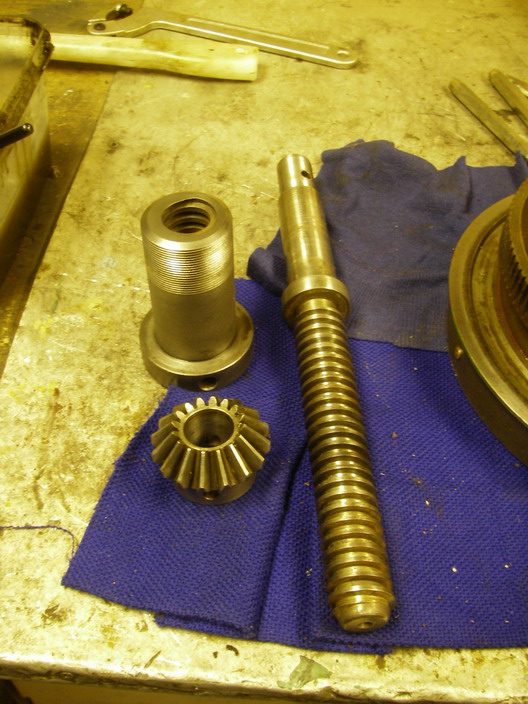

Aparently the shafts holding the hinge had been bent too
http://i50.photobucket.com/albums/f349/Trion/2013-02-0916-23-14_0016_resize.jpgHyllus 1020 x 1,5 plate bender
In order to get the bent shaft out of the good hinge part, i had to machine the head of it
http://i50.photobucket.com/albums/f349/Trion/2013-02-0918-36-45_0030_resize.jpgHyllus 1020 x 1,5 plate bender
So a few new parts needed.

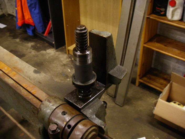

Then I started turning the mounting shafts, got the OD to Ø27,96
http://i50.photobucket.com/albums/f349/Trion/2013-03-1611-03-37_0137_resize.jpgHyllus 1020 x 1,5 plate bender
Cutting the threads M16x2,0
http://i50.photobucket.com/albums/f349/Trion/2013-03-1612-35-36_0142_resize.jpgHyllus 1020 x 1,5 plate bender
Finished parts
http://i50.photobucket.com/albums/f349/Trion/2013-03-1613-25-16_0144_resize.jpgHyllus 1020 x 1,5 plate bender
Started assembly
http://i50.photobucket.com/albums/f349/Trion/2013-03-1617-03-43_0163_resize.jpgHyllus 1020 x 1,5 plate bender
New shaft in old part
http://i50.photobucket.com/albums/f349/Trion/2013-03-1617-04-18_0164_resize.jpgHyllus 1020 x 1,5 plate bender
Left hand side
http://i50.photobucket.com/albums/f349/Trion/2013-03-1617-04-29_0165_resize.jpgHyllus 1020 x 1,5 plate bender
http://i50.photobucket.com/albums/f349/Trion/2013-03-1617-04-38_0166_resize.jpgHyllus 1020 x 1,5 plate bender
Finished and test piece bent.
http://i50.photobucket.com/albums/f349/Trion/2013-03-1617-06-28_0169_resize.jpgHyllus 1020 x 1,5 plate bender
Now im ready to start making the cath tank :beer:
