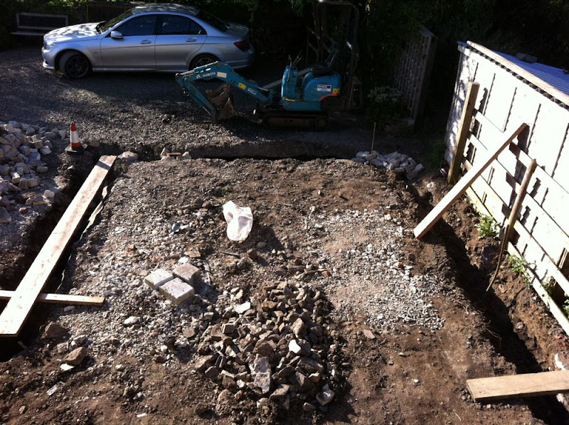

Thought I'd post up some photos of my current project - building a new workshop. Hopefully you guys will be able to give me some pointers along the way. It is going to be an 'r' shape as you will see from the photos, with small part for a machine shop and the long part for woodworking with space to get a car in when necessary (for servicing etc.). The outside area will be an idea space for playing with stationary engines and messy jobs. By my very rough calculations I think the final floor space should be a touch over 500 sqft.
Anyway here are some photos:
This (unfortunately) is the earliest photo I have. Up to this point we have cleared a lot of overgrown weeds, and pulled down an old stable and lifted the concrete floor underneath it.
The concrete broken up in to more managable chunks to be moved away.
A view of the right hand side area.
Another right hand side view with the beginnings of some footings.
That's it for now. I'd like to get your views on if the machine tools should be partitioned off from the woodworking section? It seems like wood dust and oily tools would end up in a right mess to me, but I am a long way off having to make the decision.

I'd go for a partition. I have recently been shaping some hardwood on my milling machine, having wiped the oil off every exposed surface as best I could, but it was still covered in dust right up to to the top of the spindle head. If you start using power saws, routers etc in the same space as your nicely oiled metalworking machines, the wood dust will stick to them like sh1t to a blanket.
A stud partition clad in chipboard makes it easy to hang things up.

I love watching shops get built.  :headbang:
Andy has a good idea, Partition it if you can. That brown stuff is nasty.  :dremel:
You can never have too many power plugs or lights.
What are you doing for flooring? Heat/ac?

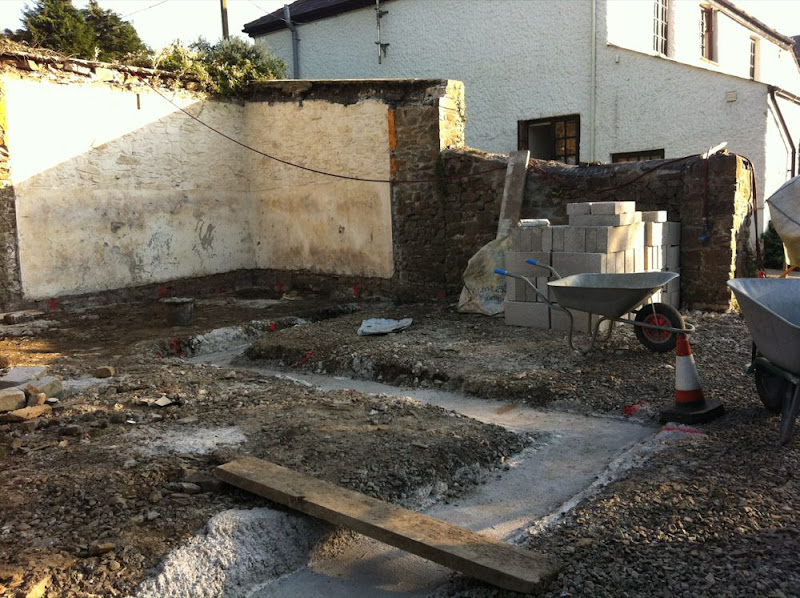

« Reply #15 on: September 12, 2011, 03:59:59 PM »
Pete we gave all the trenches a good clear out of the loose material. A good portion of it had a really solid base - the machine wouldn't go through it anymore. The rest was reasonably good but we had to compact it down by hand.
It was dry when we started pouring but then there was a massive downpour followed by continuous rain on top of the concrete - everyone got soaked. We had to wait probably 4-5 hours before we could float it to get an even surface on top.
Here are some photos from the morning after:
Next comes the digging out to remove all the loose debris before laying down the hardcore. I am tempted to buy a used wacker plate then just resell it afterwards - the hire cost makes up quite a large percentage of the cost of the unit.

« Reply #16 on: September 12, 2011, 11:09:04 PM »
ChriX,
I'm a little late responding, (home renos) It looks to me you did well. You got the concrete in before the rain so it should be fine. Careful when your digging out the material in the center. Cured concrete has very little strength if you tap it with a bucket. Green concrete like you'll have is really weak. Dig alongside your footings and let the material that's tight to the footings fall into where your digging. Better to take 4 hours longer than risk breaking all your hard work.

« Reply #17 on: September 20, 2011, 03:59:10 PM »
A block delivery.
Then some of them laid.
Pete thanks for the advice but we are digging the centre out by hand so no danger of disturbing the footings with the bucket. This has actually been done now, I am slightly behind with my photos. I have a compactor plate coming on Friday, so hope to have the area ready for the floor by the end of the weekend, but the pour won't be for another week or two yet.
