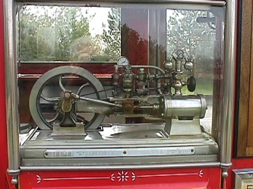

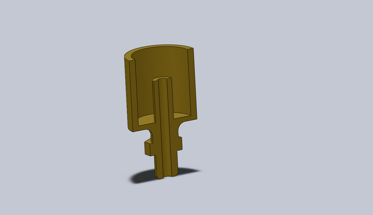

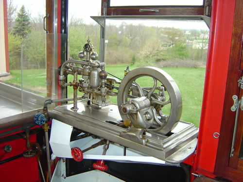

But thought I would ask a ? of you guys, I may have asked it before but no harm in asking again.
I've been trying to get my head round the plumbing you see on popcorn engines, no two seem the same, some look like Russian spy trawlers they've got things sticking out every ware.
I'm going to keep it simple along the lines of this.
http://i431.photobucket.com/albums/qq32/sbwhart/Potty%20Popcorn%20Engine/Dunbar2.jpgPotty Popcorn Engine
but without the twirly whirly bit which i've worked out is for a pressure gauge.
But the lubricators the sticky up thing in front of the steam chest looks all wrong to me, its bottom looks to feed into the the steam pipe, but for a displacement lubricator this is wrong.
Has any one got any knowledge of this or access to an engine with a lubricator on they can check out.
Even though I will be running my engine on air and displacement lubricators don't run on air I like the idea of fitting one.

« Reply #145 on: November 06, 2011, 03:37:44 PM »
Hi Stew
 :clap: :clap: :clap: :clap: :clap: looking great ,,,,,,, very nicely done  :bow: :bow: :bow:
The displacement lubricator could look like this ,,,quick doodle ,,,,,, lid missing  :D

Hi and good work as usual.
Yes the lubricator could be better, if you look how I have done it http://madmodder.net/index.php?topic=6151.0, I believe that you can get a better idea. :D
However you're engine is a fine peace of art, a Mona-Lisa in engine, a well done Mad Modder project.  :clap: :clap: :clap:

PatJ
Re: Potty Popcorn Engine
« Reply #147 on: November 06, 2011, 07:50:20 PM »
A few photos I have.

Thanks for your input and comments guys.
Rob got it correct with the lubricator, Jim over on HMEN posted a drawing so thats one ? answered.
