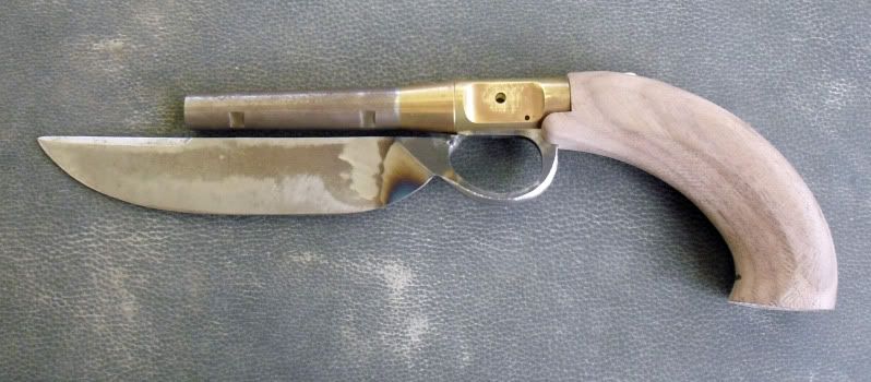

I managed to get the grip cut out and started to inlet it a little. I have quite a bit to file off! Bit I have a good rasp(o:
http://img.photobucket.com/albums/v652/Powderkeg3418/Pirate%20Cutlass/Cutlass004.jpgPirate Cutlass
I am going to try and get a tang made soon. It will have to be inleted a little more for that.

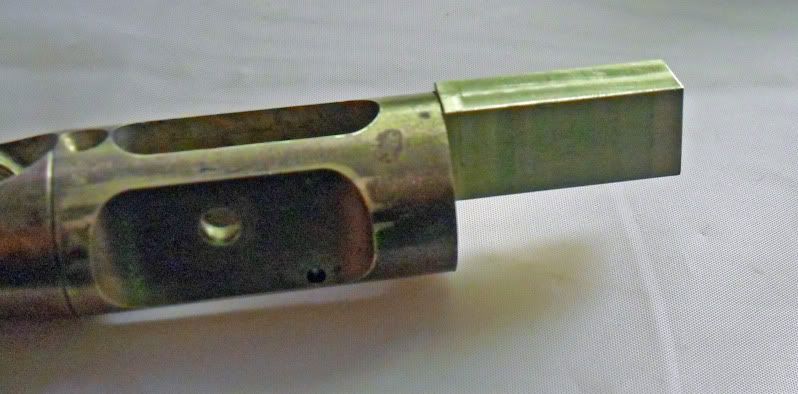

I managed to get a tang roughed out. I need to thin it up a little. I decided to just thread it then use some lock-tight to hold the pieces together. I'll try and get that done tomorrow. I left it a little proud so I can file it down flush.
http://img.photobucket.com/albums/v652/Powderkeg3418/Pirate%20Cutlass/Cutlass005.jpgPirate Cutlass
http://img.photobucket.com/albums/v652/Powderkeg3418/Pirate%20Cutlass/Cutlass006.jpgPirate Cutlass
As soon as I get these together I can finish in-letting the grips.

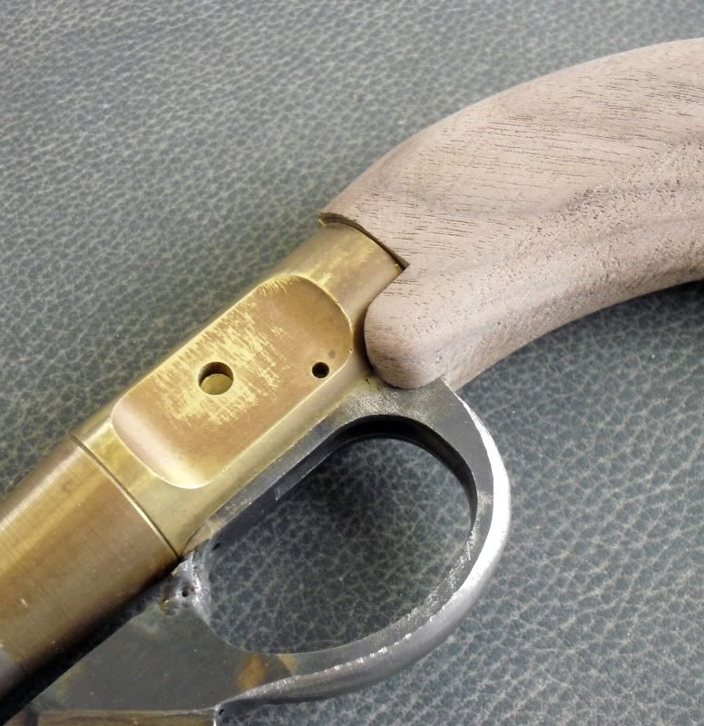

I managed to get some play time in. I finished in-letting the grip near the frame. I still have the hand guard to do. But It is turning out really great.
http://img.photobucket.com/albums/v652/Powderkeg3418/Pirate%20Cutlass/Cutlass007.jpgPirate Cutlass
I am really excited about how good the fit is that I got. I did most of it in the mill and had had to do a little touch up with the chisels. I was going to drill the screw hole near the end of the tang, but, I think it will be more towards the middle. I think the end will be filed down a little when I start to profile the handle.
http://img.photobucket.com/albums/v652/Powderkeg3418/Pirate%20Cutlass/Cutlass008.jpgPirate Cutlass
It's starting to look like something now. I'll probably start shaping the grips now.

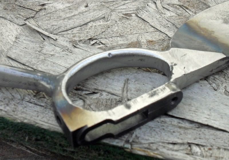

The filing is almost done. It looks like Termites have got to the frame? I was thinking I should have champhered the joint a little more.
http://img.photobucket.com/albums/v652/Powderkeg3418/Cutlass016.jpgPirate Cutlass
No worries. I just filed it out and filled it back in with the TIG.

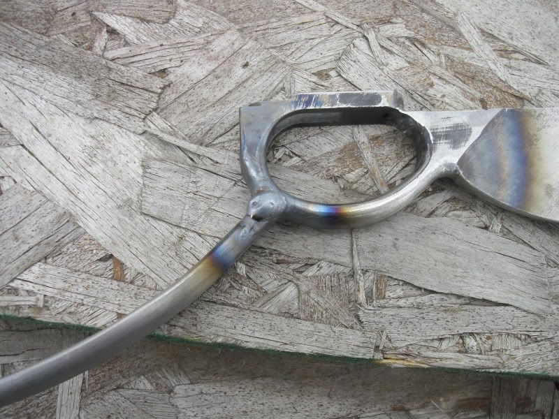

If I can get my projects to cooperate. I found another bug hole. This time in the casting for the trigger guard. Good thing I have a TIG welder:o) I'll get a picture before I plug it up.

Well I'm still plugging away at this. I'm even threatening to finish it:o) While shaping the trigger guard area I found another bug hole. This time it was in the casting and not in my welds :D
http://img.photobucket.com/albums/v652/Powderkeg3418/Pirate%20Cutlass/Cutlass019.jpgPirate Cutlass
Here it is plugged up. It was pretty cold in my shop and my welding helmet fogged up right when I struck the arc. so I couldn't see real good. I boogered it on a little thick but I can file it back down pretty easily.
http://img.photobucket.com/albums/v652/Powderkeg3418/Pirate%20Cutlass/Cutlass020.jpgPirate Cutlass
