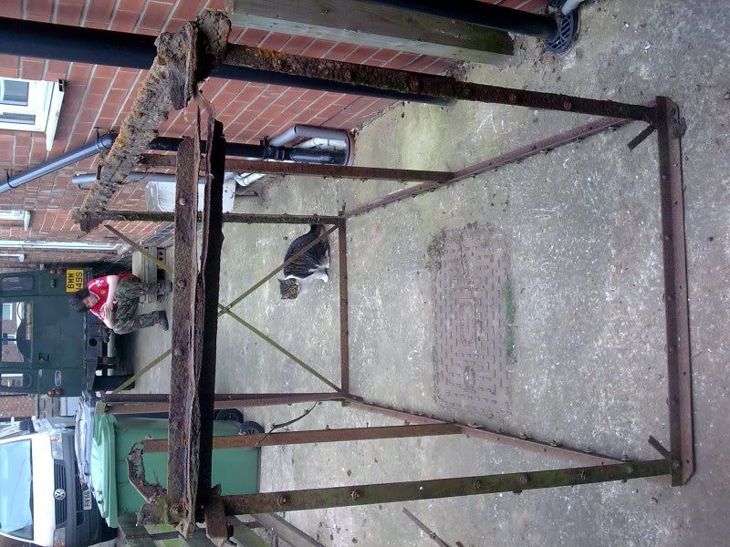

Hiya
Not plumb,not pretty but fixed,bolted and level.Cost was a few welding rods, 2 masonry drill bits, a couple of Rawlbolts and a tenner for a bit of plate.
Dug out of a field
http://img.photobucket.com/albums/v299/marky123/Image178.jpgmill stand
chopped and shopped
http://img.photobucket.com/albums/v299/marky123/Image190.jpgmill stand
I gave up on bolting it to the floor,so I dropped some studding in the rawlbolt holes and fixed it with some molten lead.
I also dropped a paving slab in the bottom to give it a bit of extra mass,hopefully to dampen any wobbles that may occur.
Need some clamps and Tnuts now!!!!
