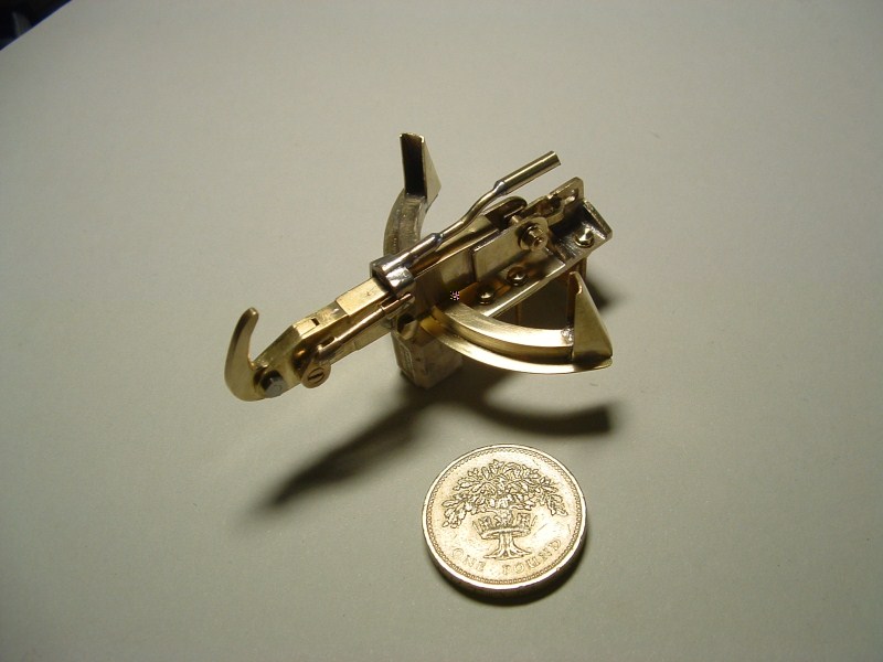

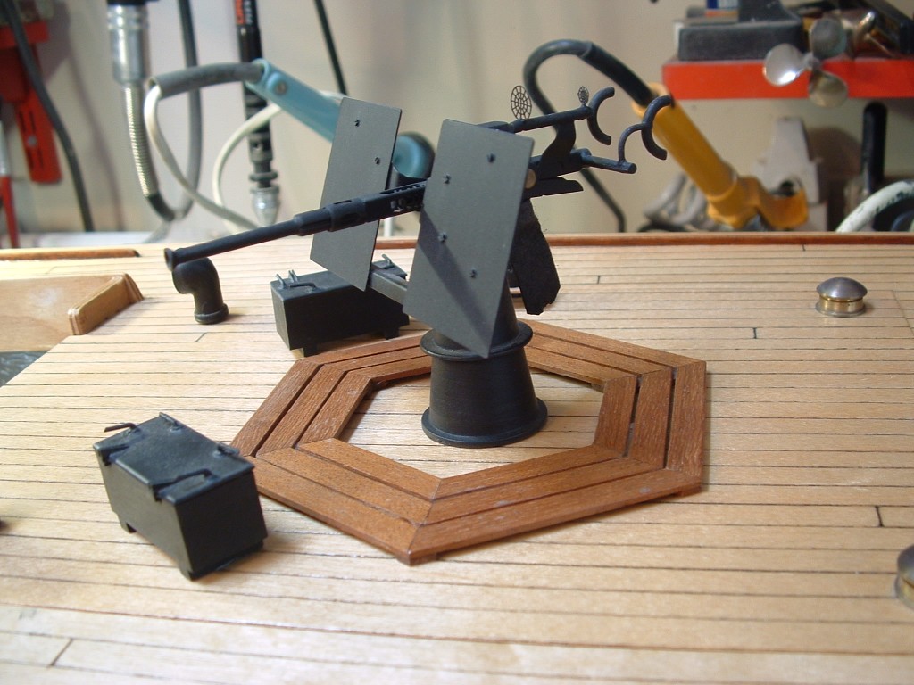

I have one off them rob had it about two years, I do a lot of small brass drilling (modelmaking) etc and it is far better than the drill I Had befor I get a lot longer life out of small drills.for the price I paid ( arc is by far the cheapest for speck) it is great value, plus it has enough weight not to roam about without being fixed.
peter

I like you models very beautifull  :thumbup: :thumbup:

Those boat/ship parts are cracking ,  :bow: :bow: :clap: :clap: :clap: :clap: :clap:   will we see the rest of the craft some day  :poke: :)
